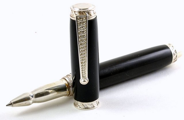

One of the most classic looking pens to be found. When I did art shows I sold many solid black pens. Just like a black car be sure to have no ripples in the blank as black shows all faults. And yes all black material works well, I like Ebonite but all acrylics will work.
