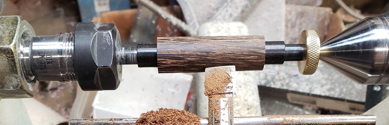

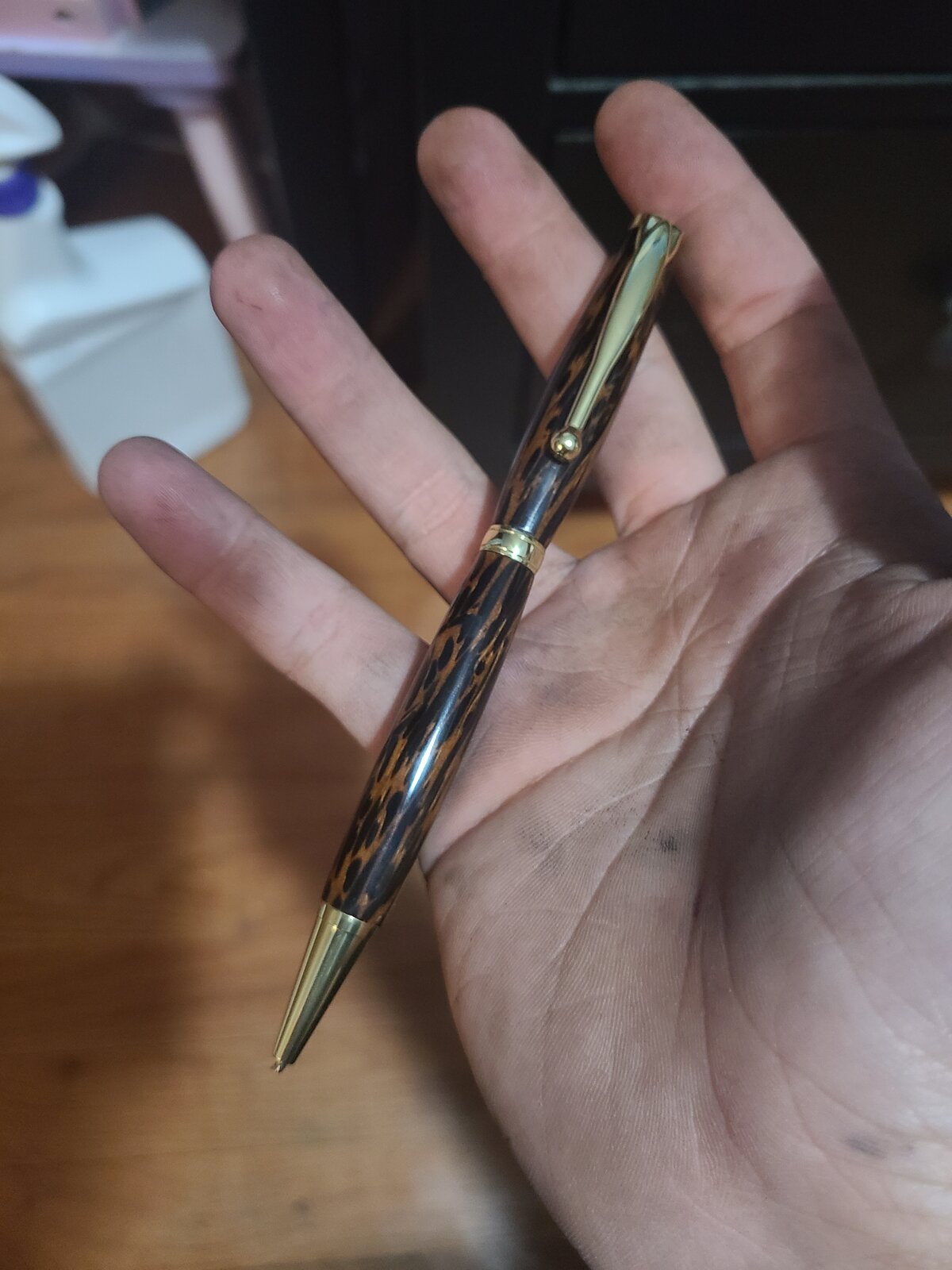

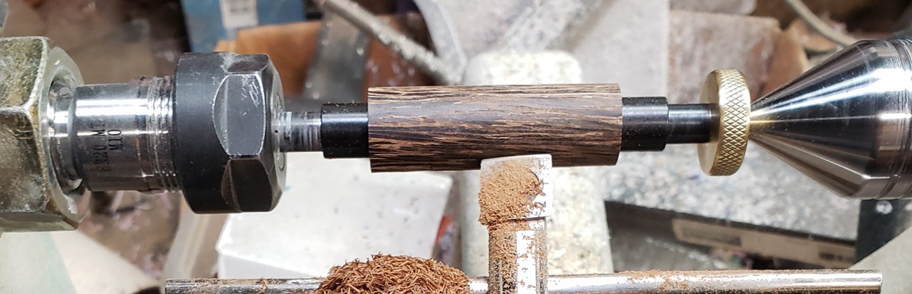

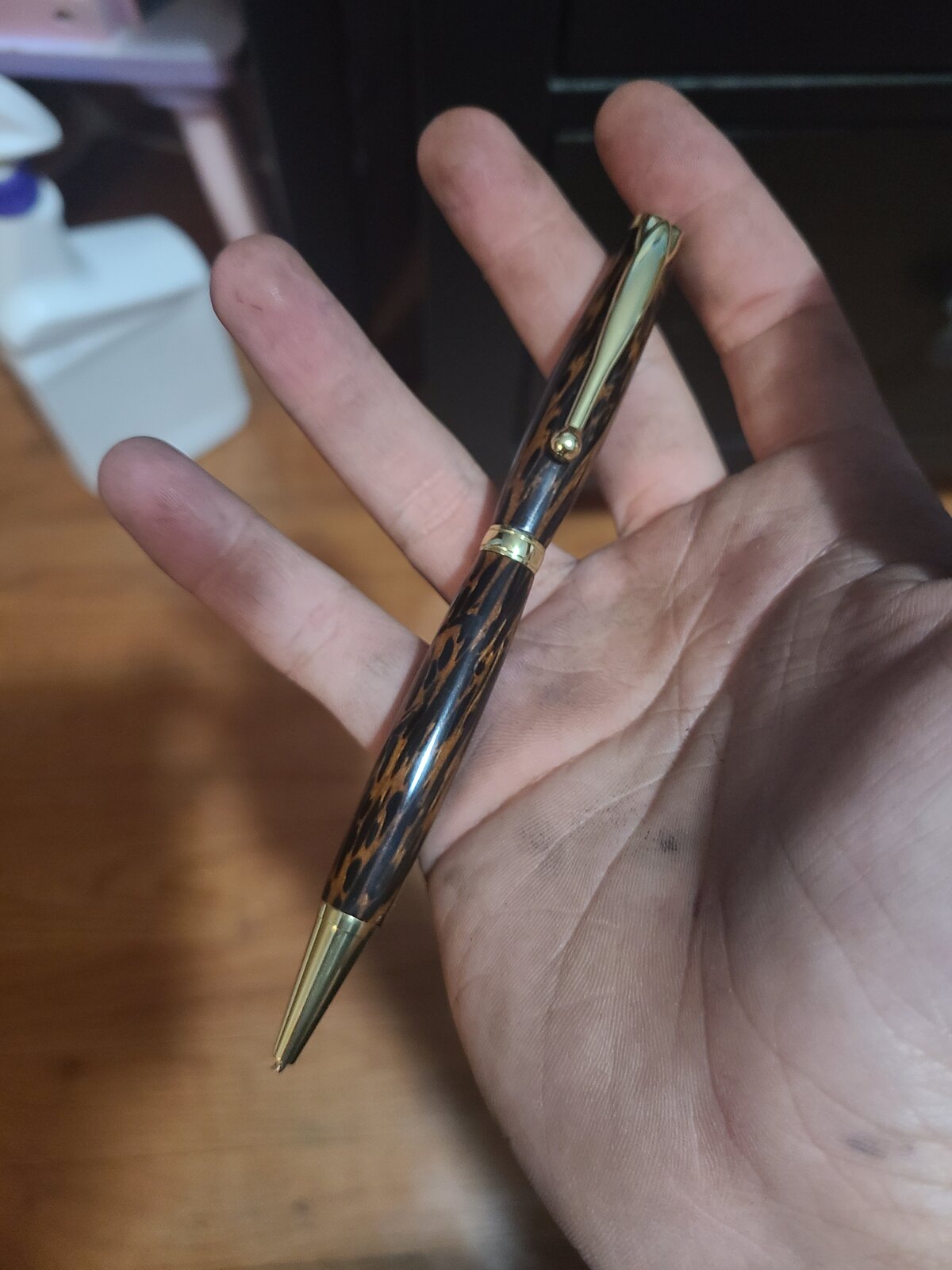

First time I've worked with palm before and I can very confidently say I will almost never ever touch this stuff again.
Started off using carbide tools and when that created too much chipping (and subsequent incredible amounts of splinters in my arms) I opted for to sand it all the way down.
I thought turning ebony or any of the black woods were annoying before, but this simply takes the cake. Pretty pen though... only took me 3 hours to finish...
Nice pen though.
Maybe not worth the pain?

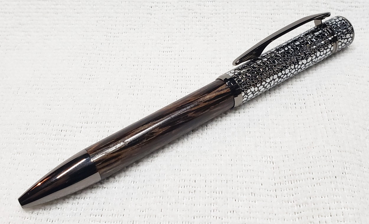

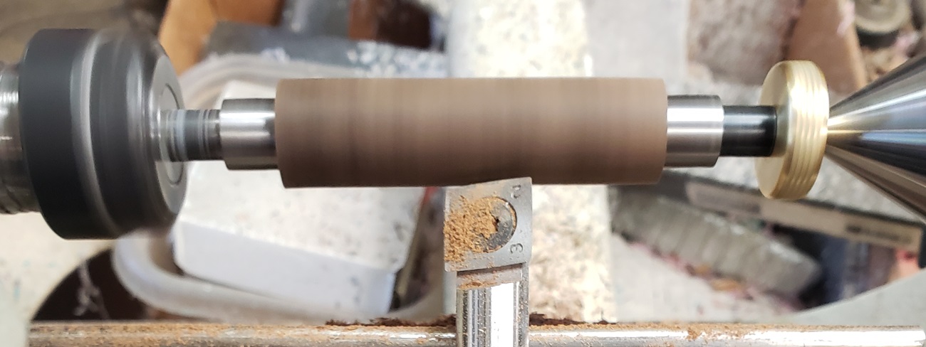

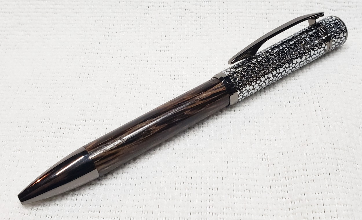

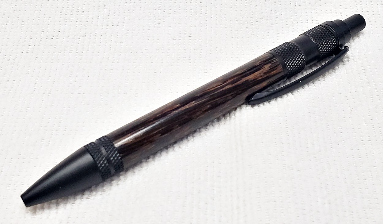

Great looking pen! I've turned black palm a few times, but don't remember having any problems with it. I used a radiused carbide cutter with a shearing cut.

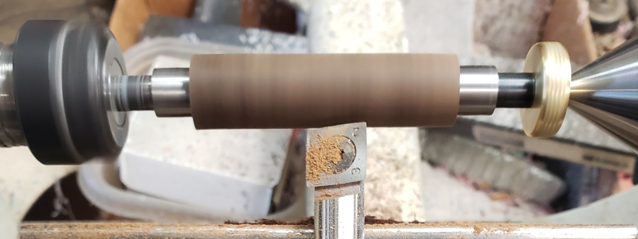

I noticed that using the detail cutter carbide gave me very little trouble, though it was still creating some chipping and by that point I was already getting close to the tubes so I didn't want to risk it and went back to the 80 grit abranets.
The diamond shape cutter?
