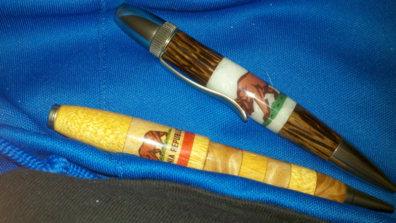

dmott
Oct 20, 2011
62
San Diego
I already failed trying to turn black palm. I saw this thread and decided to give it another chance, with a lot of thin CA glue. I finished the pen and also included a california bear sticker which I was unsure about ending up nice. enough quotes of CA glue makes balck palm turnable and also takes out the ridges made by any stickers.
Osage orange with maple burl, segmented on nib side, all O.O. on clip side with cali flag address label under a lot of CA glue. No ridge at all.
Black palm with a "white pearl" acrylic in the middle. Just the bear from the cali flag.

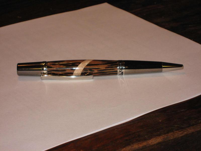

barrysj
Oct 2, 2009
125
woodbridge va
Finally done
Well, I'm finally done...yes CA works, but I will do the stabilize thing next time! Not the greatest pic, but the pen came out great....

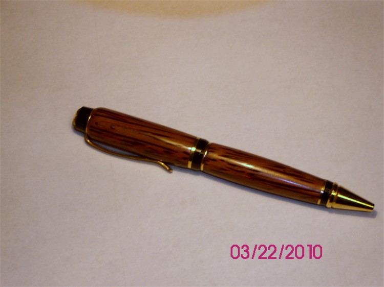

OLDMAN5050
Passed Away May 15, 2019
In Memoriam
May 8, 2007
2,112
Unionville, tn, USA.
Pix not very good but here is a black palm cigar. turn using thin ca, take your time amd all should be ok..........
