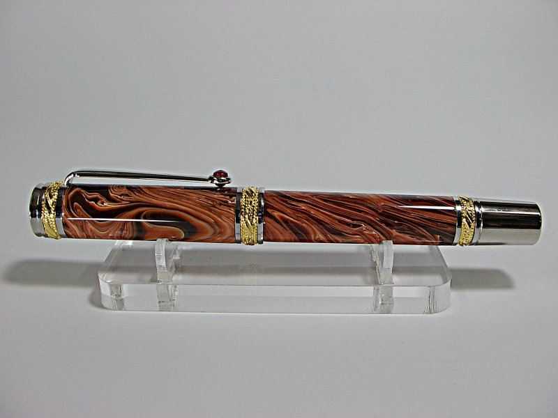

John,
This pen is beautiful.
IAP Home - Photos - My entry into the 2019 Pretty Acrylic Bash contest
How did you turn the blank material to wind up with the tiny piece glued in to the clip ?
Thanks Ed for the kind words. The piece was turned very easily on the lathe. I used calipers to measure the clear stone that I tool out of the clip. Then turned a piece of the same material I made the pen from down to the measurement I got. I then used the skew to shape it rounding over the edge. I then MM and polished it before I parted it off the rod. Painted the backside the same blue so that it looks exactly like the pen blank. Glued in with epoxy and there you have it. I think it adds to the look of the pen. :):)
