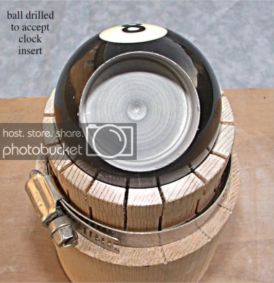

How do you fit a flat clock on a round ball ? Isn't there a gap on both sides of the clock ?
I have to assume the HARD part is holding the ball. If you think about it, there won't be a gap... Picture the ball.... Now sand one side flat... You will see a perfect circle at the edge of the flat part.
Drilling the hole is the same effect... At the edges of the hole will be a perfect circle!
Or if you cut out a circle in a flat piece of wood on the lathe, it will hold
a sphere for drilling. Doesn't even matter much what size as long as it isn't
larger than the width of the ball. You wouldn't even need to sand it flat.
Sorry if I was confusing.... I do NOT recommend sanding flat. I know that the bit will take care of that - what I was trying to do was create a visual for comben to understand how a flat clock goes into a sphere w/o gaps.

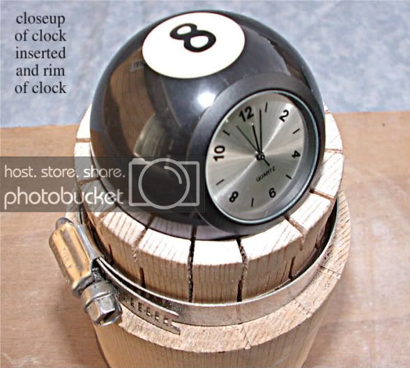

Hello all
First I would like to thank all for the kind words. I sold 2 at the first one day show yesterday and have a cfew 2 days shows for the next 3 weekends so will see how that goes. Sold 6 pens also which makes me feel good. There was 2 other pen turners there also.
To quickly answer a couple questions yes holding the ball requires a jig to make it happen and getting the center of the numbers is another concern when drilling for the inserts. The inserts are 1-7/16" round and require a hole of 1-3/8" which is plenty room within the shere of the ball which is 2-1/4" As long as you do not surpass that you will be able to drill safely and have the clock cover the hole. I have included a close up of the rim of the clock to show that it does fit flat and there is no gaps.
Have a great day and again thanks for the nice words.
