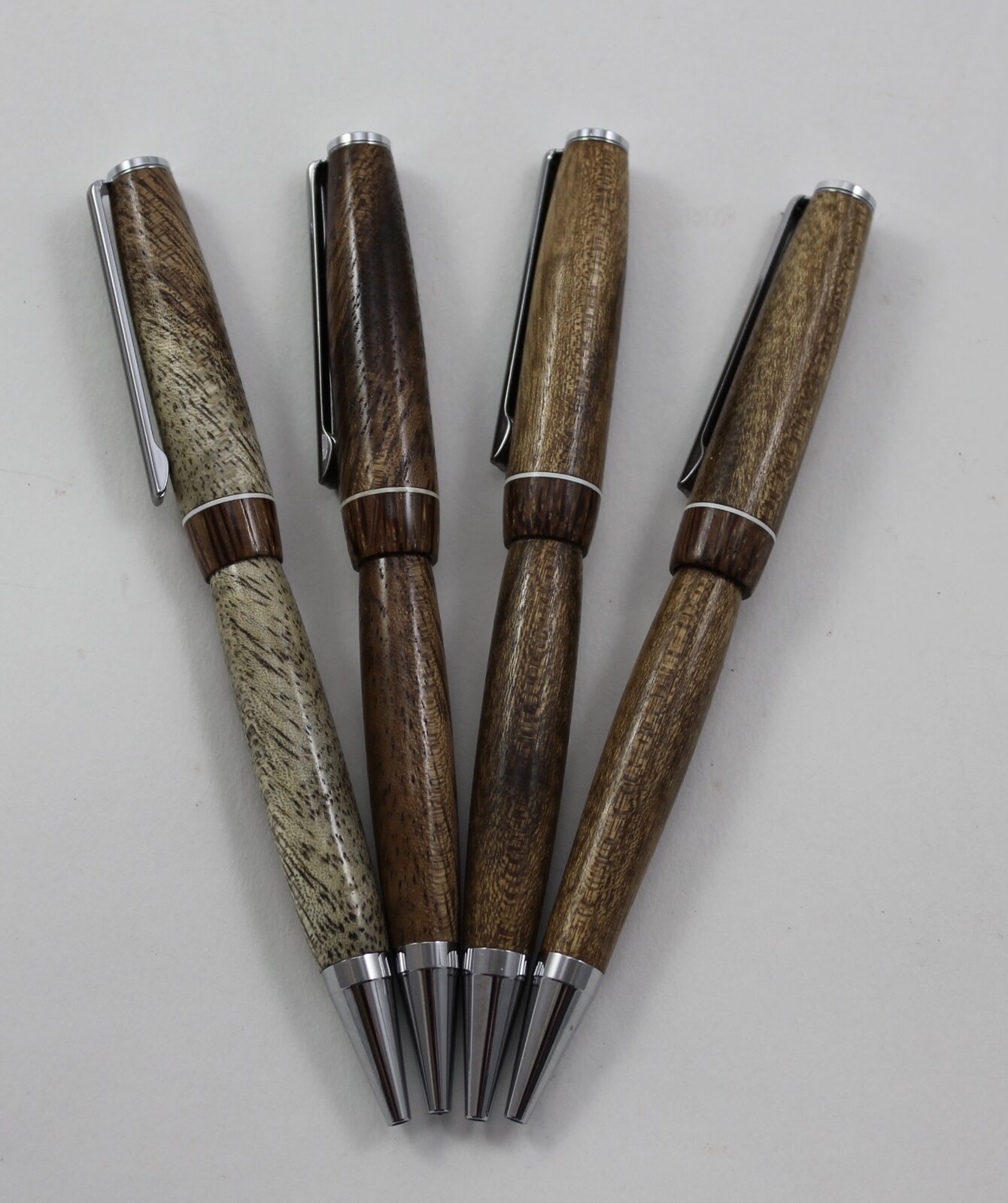

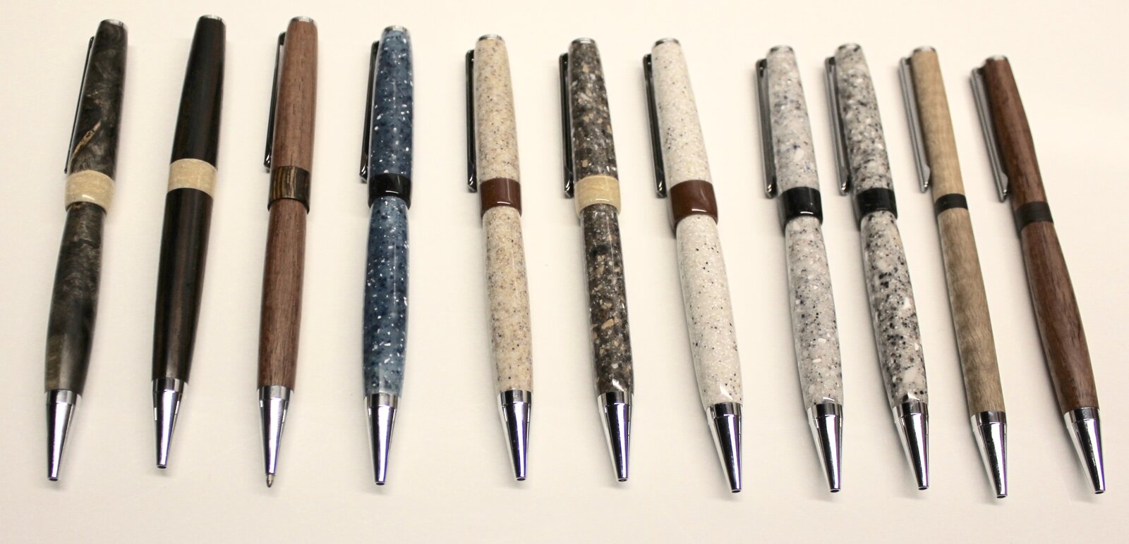

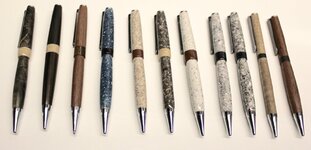

I have bought many (bulk packs) from Berea Hardwoods, and also PSI (through the Visually Impaired Woodturners program). I have not had an issue with either. The most important issue for me is the transmission. The tubes are less important as they can be modified and actually result in much better visually impressive pens. A less expensive kit - certainly. But with modifications and tinkering - they can be a very nice pen. I have 5-6 that are 4- years old and are still very nice.

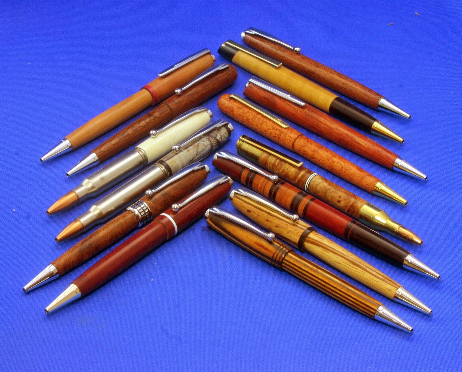

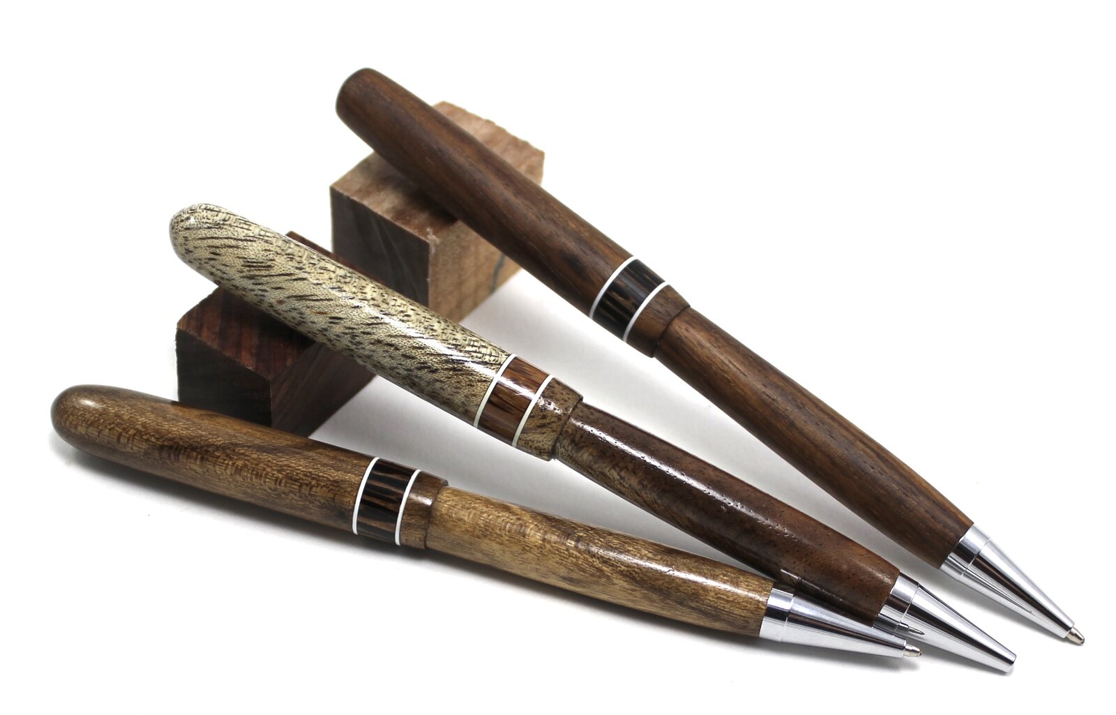

I use a lot of slimlines and make several custom pens from them. See the picture below. My favorites are those made by Berea and the kits from PSI. I do not like the black line clips used on the Berea kits. But, the clip does not affect the kit quality so the Berea slimlines are quality kits. I just wish they would ditch the outdated black line clip.
