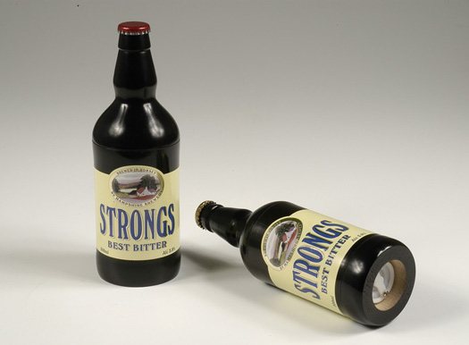

Seeing Milpauls coke bottle reminded me of a pair of mills I made for a competition. Beer bottles!
<center>
</center>
I would love to make them to sell but the problem I have is:
The labels are from the brewery, and are self adhesive and the adhesive is meant for glass. After a few days air bubbles start appearing under the label. The wood had been given a few coatings of acrylic lacquer before the labels were attached.
I took them to the Brewery to have the labels put on. The two shown were included with the full beer bottles and went through the labelling machine. I had to make sure I kept my eye on them when they came out. The Brewery foreman was a little worried that they would end up in a local pub or on a supermarket shelf!
That was a nice thing to say!
So if any one can help with ideas of how I can fix self adhesive labels to wood instead of glass and end up with NO air bubbles I would greatly appreciate it.

How long did you let the lacquer cure before putting the labels on? Lacquer takes a week or more to fully cure and in the mean time still has some of its thinner in it. Most lacquers are petroleum based and that may be affecting the labels.
The other possibility is that what ever you are using to get that awesome shine has some wax or silicone in it. You would need the fully cured lacquer to be polished with not residue of anything then the labels *should* stick.
By the way, BEAUTIFUL workmanship!

Hey one more that's fantastic work!! My advise on the labels is to take them to a sign shop and ask them if they might reproduce (with the brewers permission) and they could probably use a different material made for wood and different adhesives. They could probably do this on vinyl and the reproduction will be just like you see it. If I can be of more assistance, I've done some sign business research and have some friends in the business, let me know. amisoncollectibles@comcast.net
