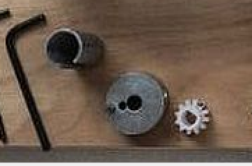

Hello all......have a good lead on a used Pen Wizard in excellent condition. Fella never used it so does not know what many of the parts do. Has several of the parts laying on a board. Looking at them I have no idea what they are for and what purpose if any they serve on the machine. I've attached a picture below in hopes maybe someone can help identify what they are and if they indeed go with the machine. From left to right it starts out with a small plastic bags that looks as if it has a spring and some other small parts. Skip the allen keys, Then theres a steel sleeve with an open slot going vertically in it. last is a steel round block....possible something is missing off of this??? Any help would be appreciated since no one I know has any idea what these are. Thanks in Advance.

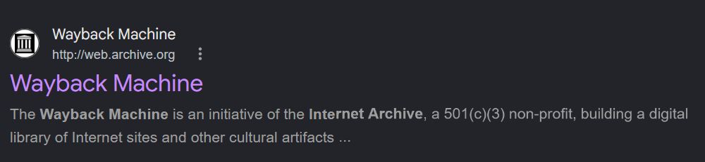

I get there using a Google search for "wayback machine" and this is the first result listed:

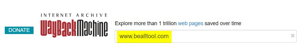

Click on that link, it takes you here, and type in the site you are looking for (you have to know its address, but I can guess this one)

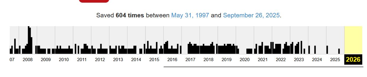

First display is a calendar showing the available image dates that are in the archive:

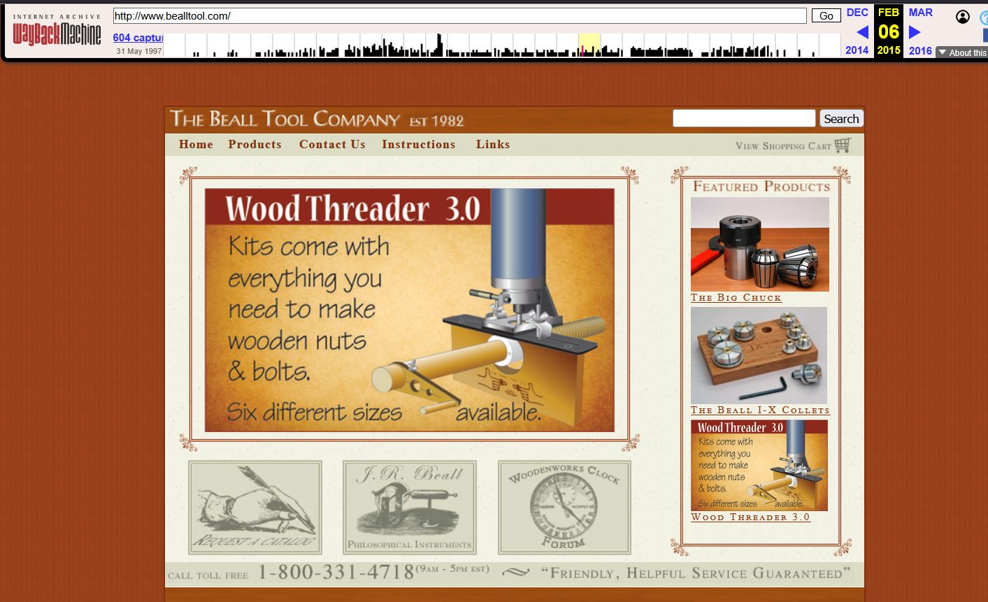

Choose a date that is likely to hold the information you're seeking - I picked February 2015 (you can step backwards and forwards in time if this misses the information you are trying to find):

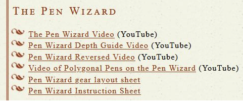

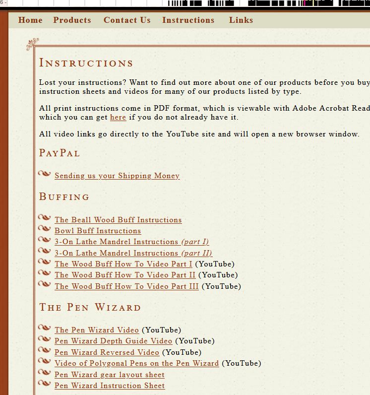

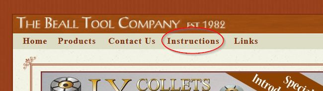

Click the "Instructions" link, as there's a pretty good chance that's where I'll find what I'm looking for - hey, look what I got, a list of all Jerry's instruction docs available on that date.
Usually the document links are live and PDFs are also archived, but sometimes the web designer made it difficult for the wayback machine to index and retrieve them.

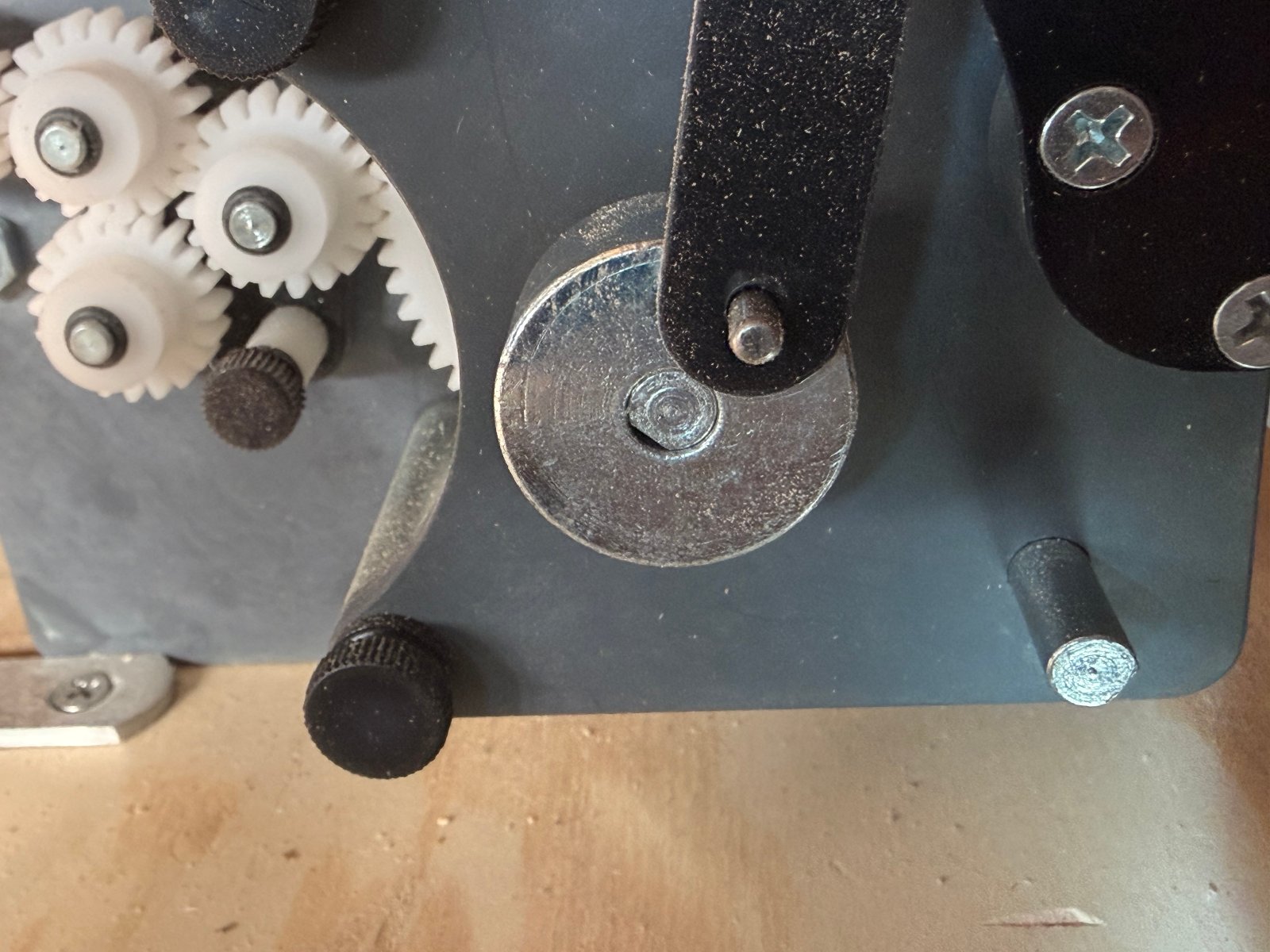

I can't really tell what the part is in the first photo. In the second photo the gear looks like it is the 12 tooth gear that matches up with the 60 tooth gears. The other part may be the crank for the Guilloche attachment (see the photo). I'm not sure what the tube is on the left.

Yes, the round disc did go with the Guilloche attachment. Now back on the machine and glad to know it's an integral part that's important. The round tube with the slit is a mystrey and I really don't believe it goes with the machine itself as well as that spring with nut and "O"Rings. Glad that's cleared up.....now just looking for some better instructions on it's use. Not quite familar with the machine and with all the gears, slides, rods, and adjustment it's a little intimidating. Jerry Beall once had many video's on YouTube but for some reason deleted them and there's only 3 video's of his left on YouTube. Will keep looking and thank again for your help.

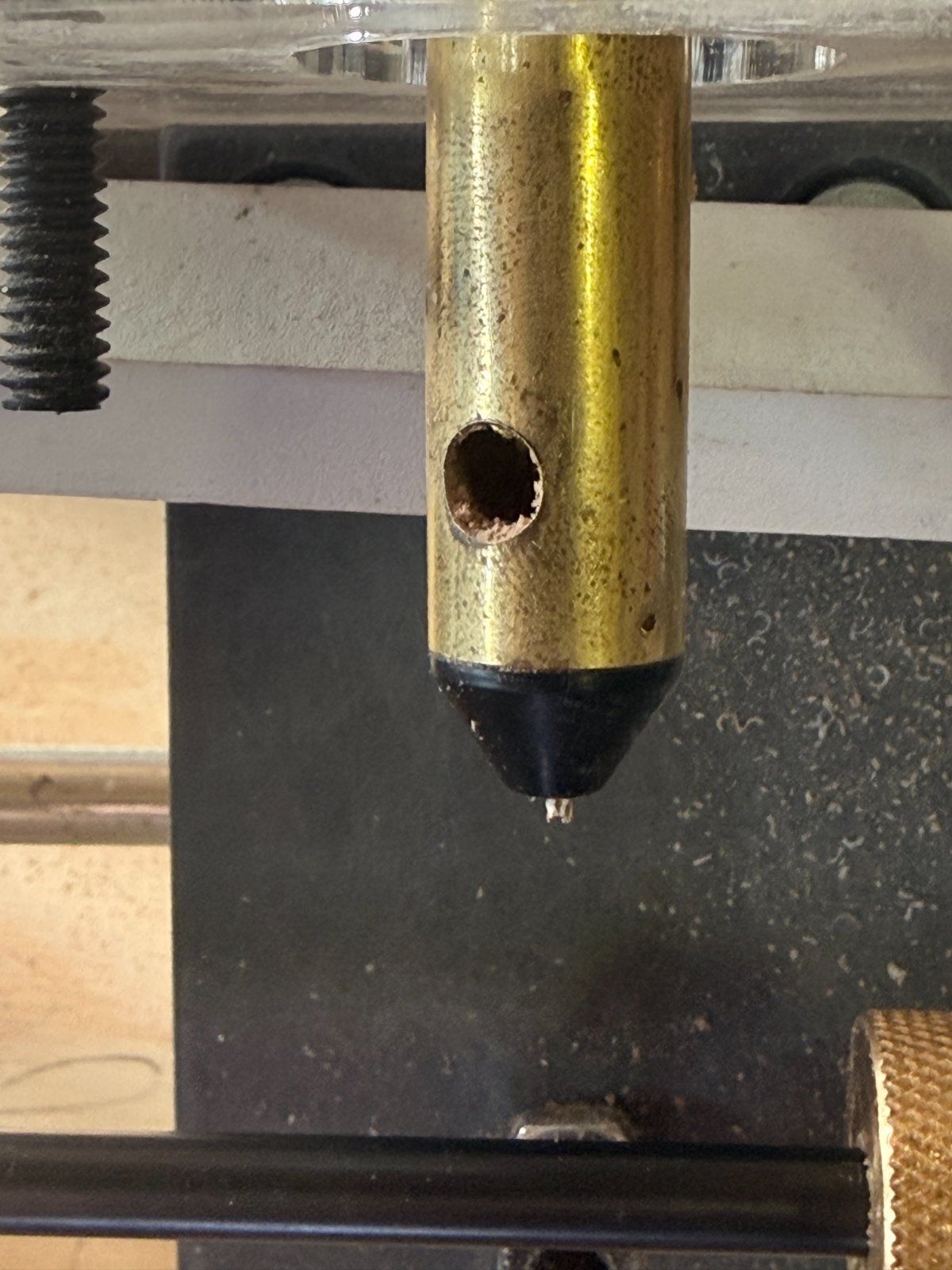

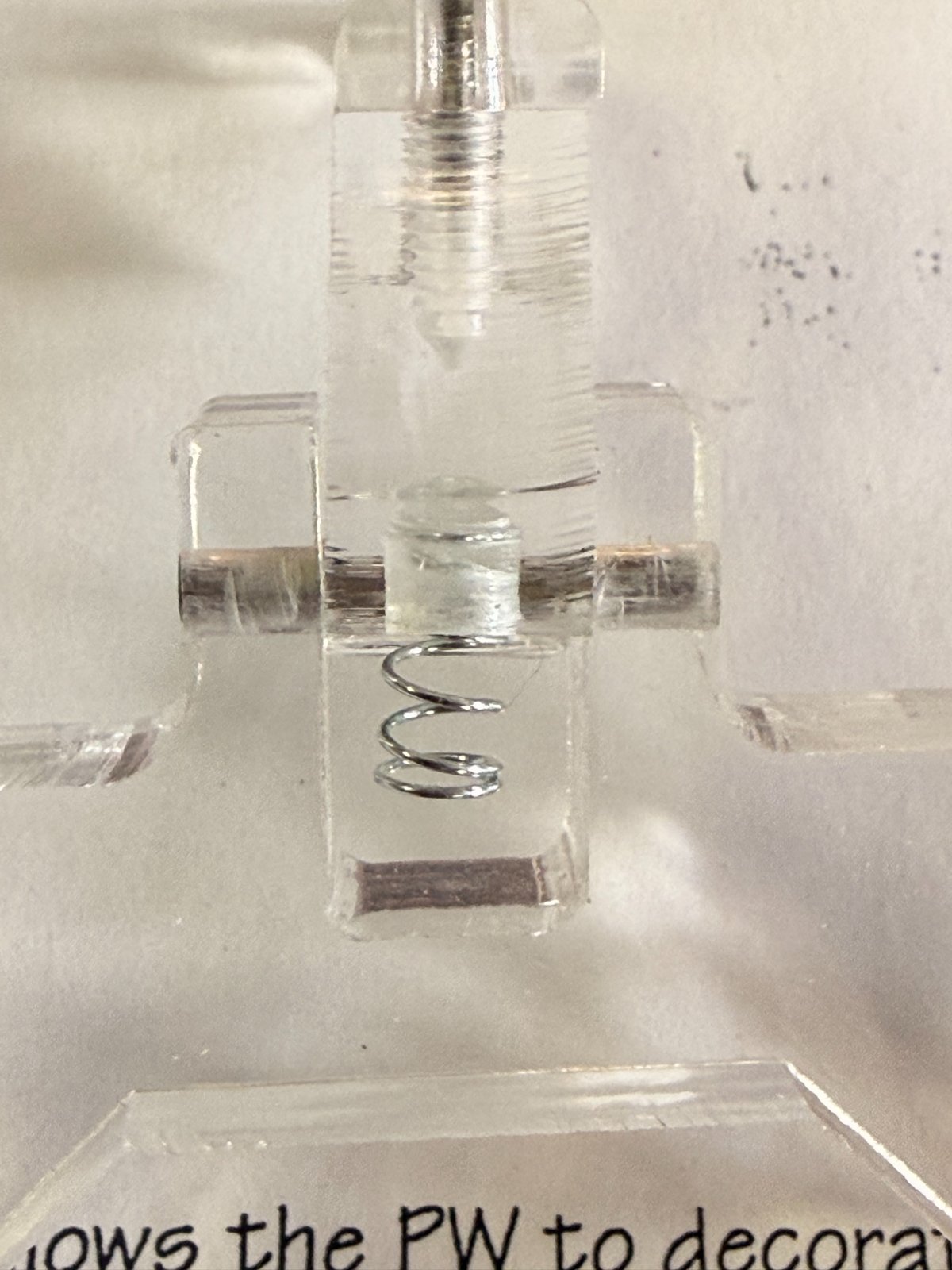

If it is a 14 mm or 1/2" brass tube, that would be similar to the diameter of the tube that came with the upgrade package for the Pen Wizard called the Transformer Package (see the first photo.) These upgrades allow the cutters to move along the contour of the work piece. You mentioned the other photo was of a spring, and the only spring I have is on the depth guide that comes with the accessory package (see the second photo.)
I was lucky and did receive the new Depth Stop with my recent Wizard purchase. What I really like is the older brass tube depth stop but unfortuate that my model Dremel does not have the recessed slot that the tube slips up into that Jerry Beall describes in his one YouTube video. Do you by chance happen to know which Dremel models happen to have that future? I made a tube type depth stop for my Spiral mater router I use and really love it. If I knew which Dremel to buy that has this feature, I'd look for one on Marketplace. They work GREAT!!
I believe the models that have this feature are the 275, 285, and 395. They are all part of the Dremel MultiPro family. The one I have is a 395.
I do see the Dremel model 395 is a rather interesting tool and differnent from the more current day Dremels. It has a small plastic fexible coupler that I hear needs replacing over time. Wonder if this has anything to do with how that brass tube in Bealls video slips up into the motor housing. Really strange and would love to learn more about this model. I do see it's variable speed and will run as high as 30,000 rpm's which is good when doing the small router work on the Pen Wizard.
