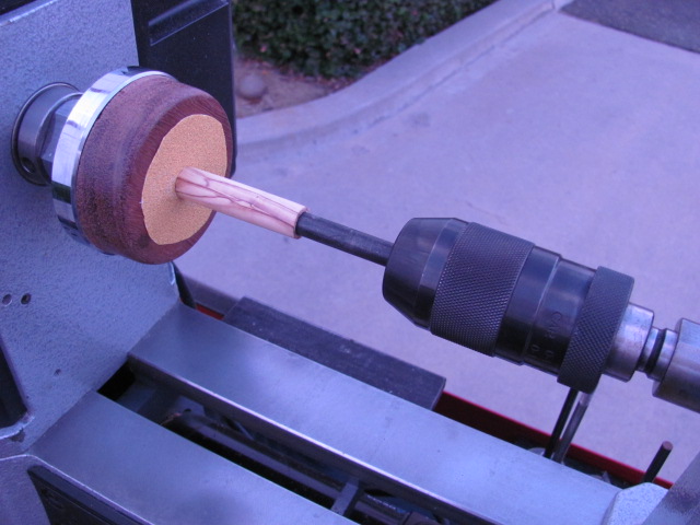

I learned here that the best way to do it,is to screw a flat piece of wood onto your faceplate that comes with most lathes.Turn it round,then affix sandpaper to the faceplate block.Then get the inexpensive transfer punch set from Harbor Freight that fits all the different tube sizes perfectly.put that into a chuck in the tailstock and you are all set.
I'm always in a hurry so I got some super-coarse 36 grit heavy paper disc that I cut to fit.These are easy to keep from clogging up.I use that to take the majority off,then switch over to a 120 grit one to put a finer finish on.
Ever since I went with this method,no more problems with blowing up blanks with a barrel trimmer & it's just as quick once you get used to it, & it's as accurate as can be since it's squared to the tube.

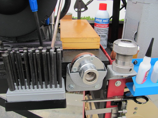

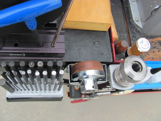

I attached some pics of it,amd the holders I made for my lathe stand to keep the face plate,transfer punches,and keyless chuck right at my fingertips so there's no looking around for stuff.My feet never have to even move.That made it so much faster and quicker.The sandpaper pieces I keep in the drawer.
