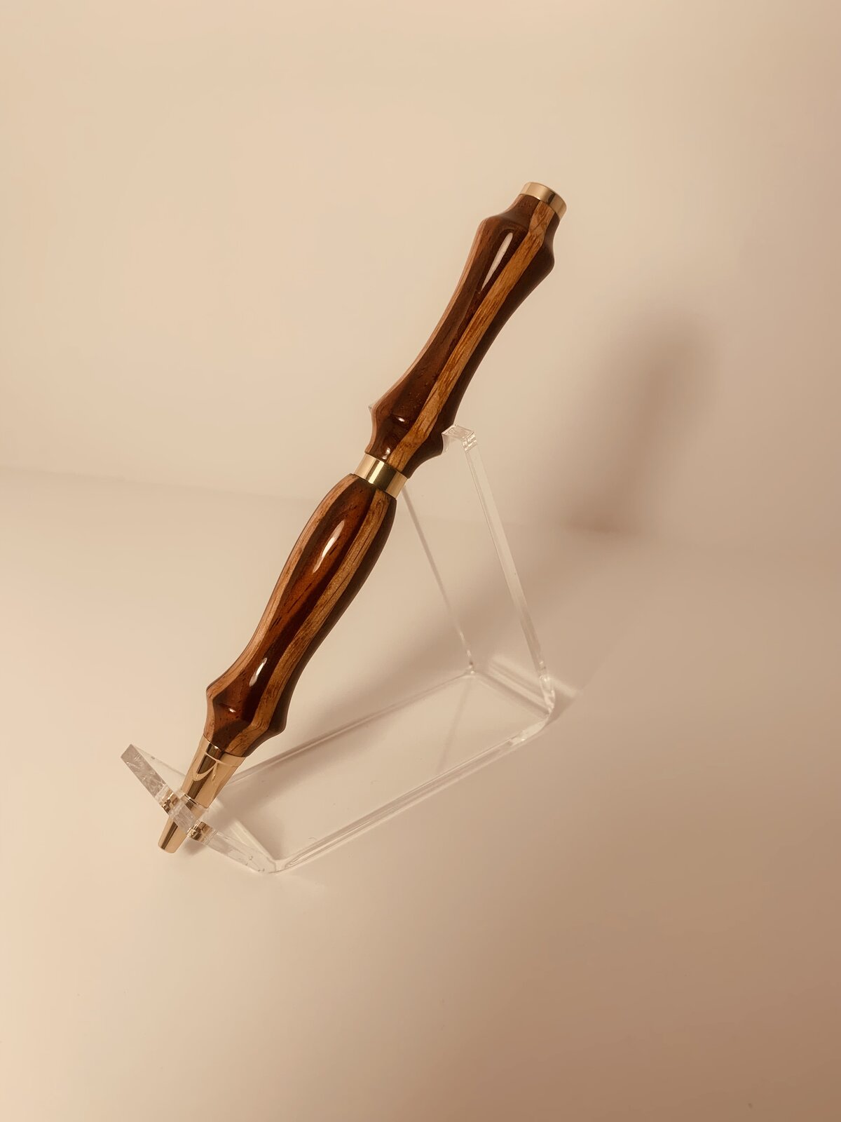

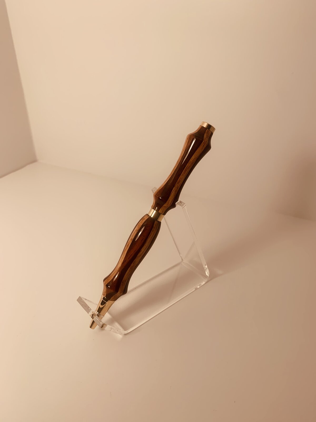

The first pen is a simple segmented pen made from Maple and Cocobolo. I cut the segments out on the band saw using a shop made sled. I cut out a more exaggerated profile to make the pen a little more interesting. Before I moved to sanding and finishing, I applied a coat of thin CA to help minimize any bleed out from the Cocobolo on to the Maple. I then finished the pen with Gluboost applying 5 coats of both thin and medium CA.

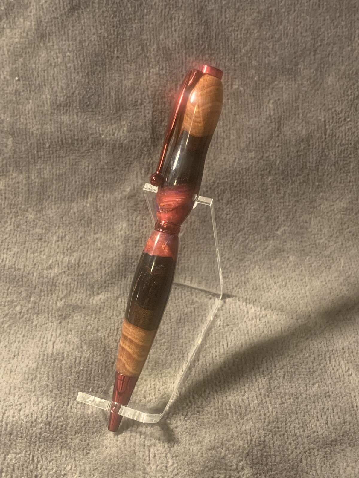

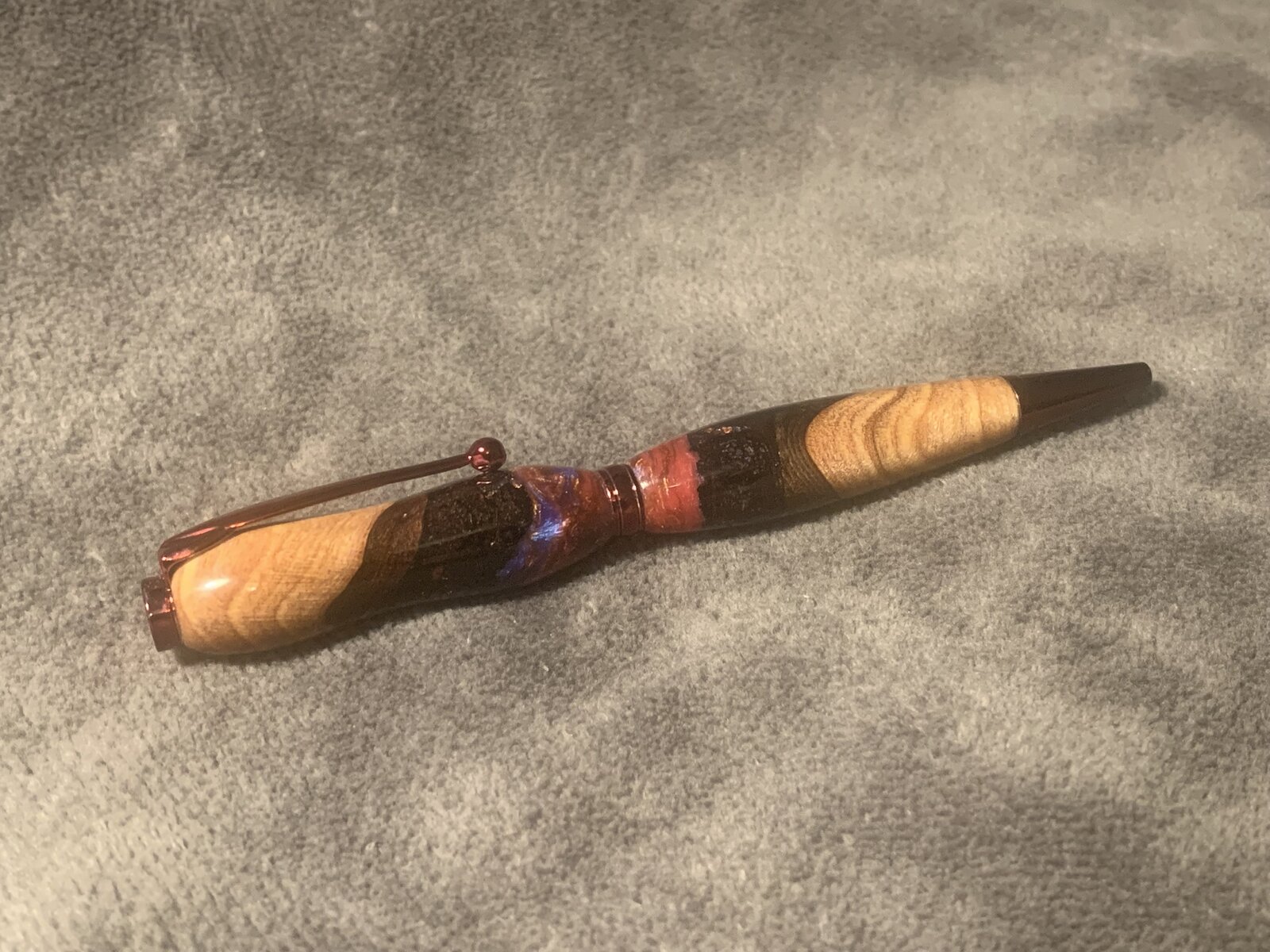

The second pen is made of Redwood burl and is a Hybrid casting using Alumilite clear slow. I first stabilized the burl with Cactus Juice and left it under vacuum for 24+ hours, and then let it soak for another 48 hours. The 3 mica powder colors I used were Flamingo Pink, Misty Lavender, and Super Bronze. I have had several blowouts with Redwood burl in the past, so I took my time turning these blanks and applying several coats of thin CA throughout the turning process. I finished the pen using the same process as the first pen.
