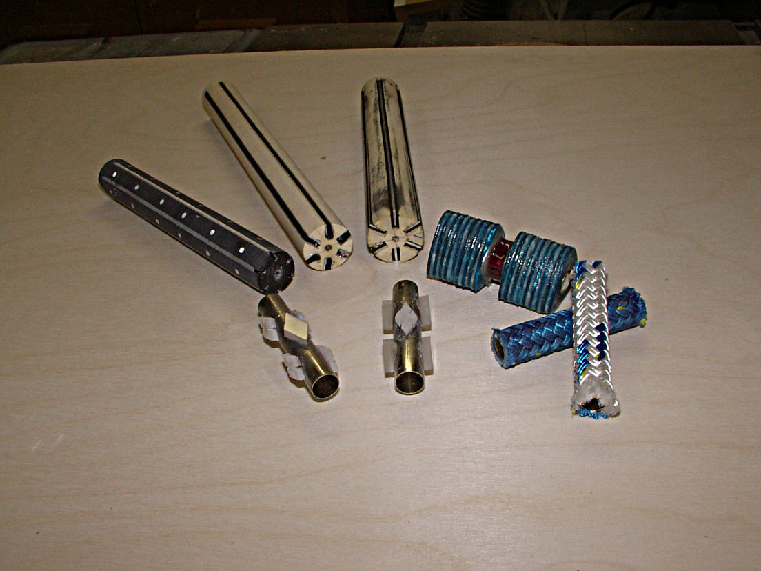

Thank you Bruce. I do have some like those. The thing with them is it requires a different type of casting because they are so thin. What I did with these is just glue them to the tube and cast in resin because they are thick enough I turn them down as I am turning down the blank. I have a couple ideas that require that type casting but will have to see how far I get with the rest of these ideas I am working. I have to make a green one of these for a friend as I mentioned. I have the mica picked so will start on that tomorrow hopefully. I included the photo awhile ago but if you look at the bottom you can see these tubes with the diamonds glued to them.

Those are pretty cool John.Like what you got going on here at the end.Did you braid those blanks?That black fluted one is gonna look sharp!
Will not comment on the other blanks just yet. It will take some time to put together the segmented ones and the other blanks because I am going to finish up the 3 pens I got orders for. Not that I am going to be paid for them but a promise to do them for the people. Started today getting a couple of the blanks ready for glue up tomorrow. I am waiting on a couple orders to come in but guess the virus has slowed things down and do not know if the vendor is even open. I have 2 other pens I want to start and they will be watch part pens with a twist. I can say that much. If I can pull the one off it will be a $500 pen at least but will not sell because it will be a one of a kind.
When I used them, I glued 2 together and then took a found file and tried to shape the bottom to the curve of the tube. Just another idea to put in the data bank.
That is how I attached the diamonds to the tube. I used a dremel to get the rounded shape and a small round file to clean it up. Have to do that or they will sit too proud of the tube and be cut away when turned to shape. Definitely need to shape to tube some. The thickness of these is just right for a Sierra Vista kit. Even though they are opaque I believe if turned down too much they will become transparent enough to see tube. That is why I chose the Vista.
