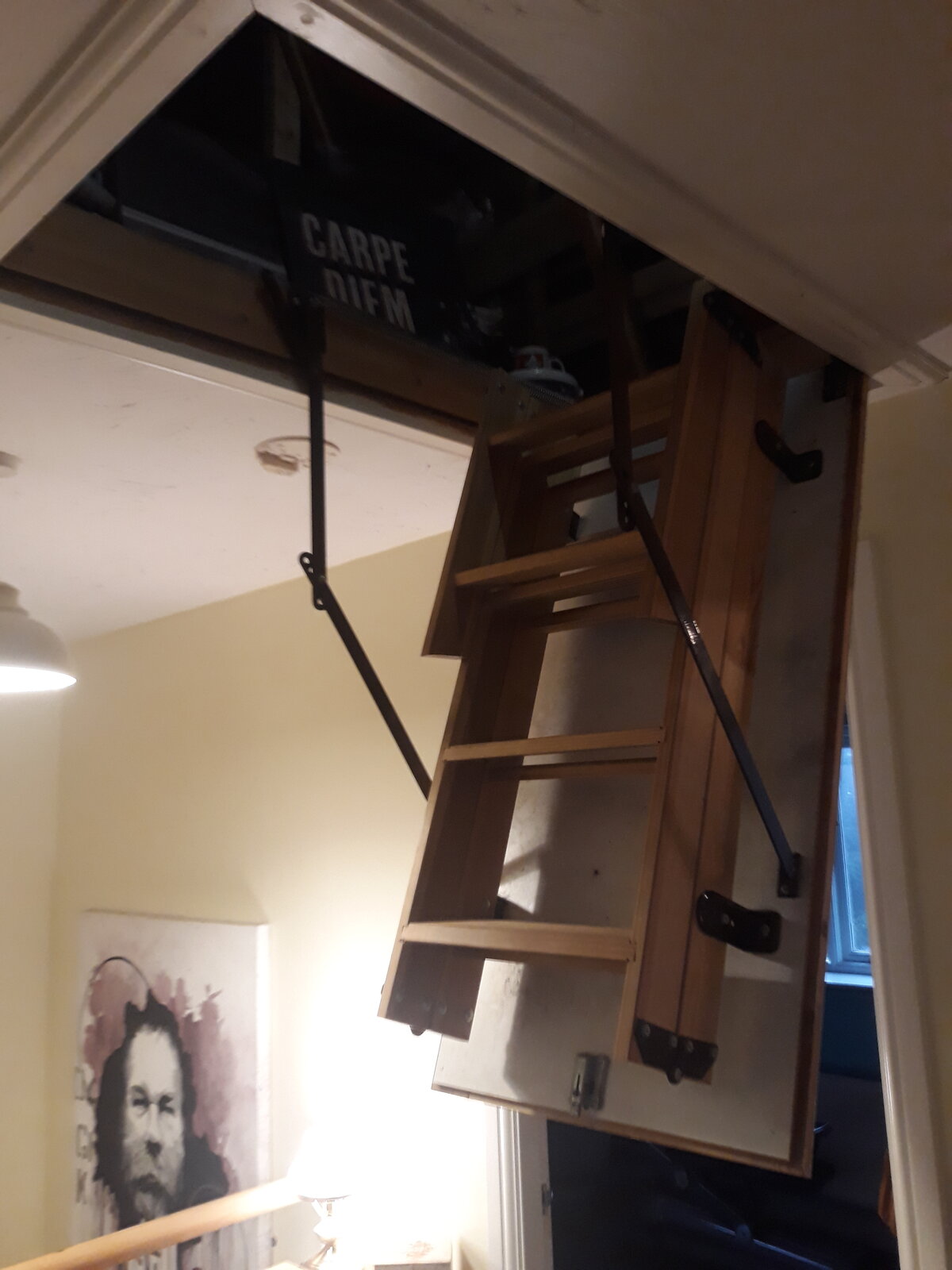

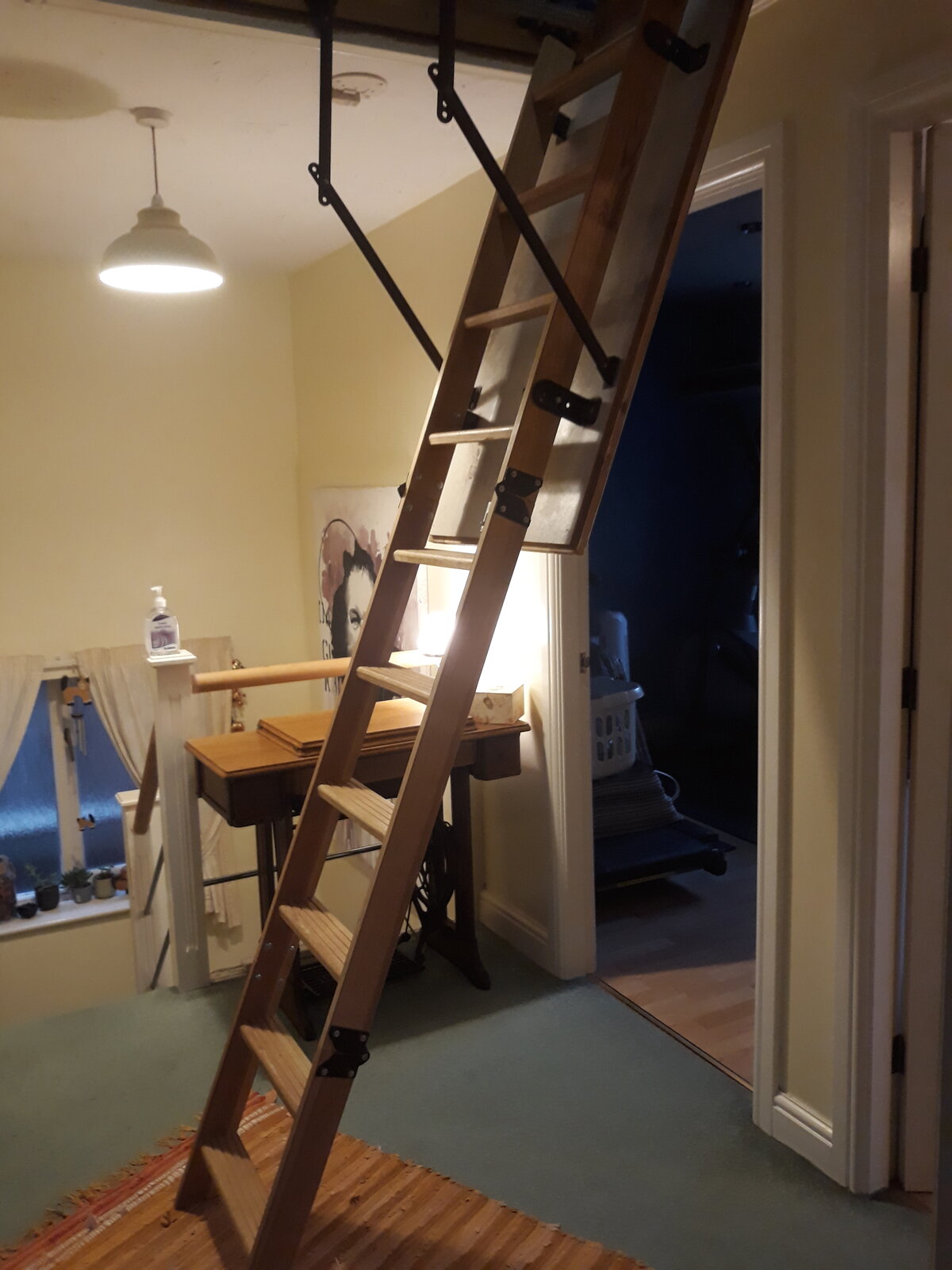

Hi John,
This is mine that I fitted about 20 years ago but this type is still readily available.
It doesn't have a brand, just came from our equivalent to your Home Depot.
I weigh 240 as well. My eldest son is around 280 plus and it has always been rock solid. It comes complete in it's own frame that you slip up between rafters.
All spring loaded so balanced for lifting/lowering.
Here is a link to the same thing but a slightly newer model. https://www.diy.com/departments/mac...-folding-loft-ladder-kit/3663602522508_BQ.prd

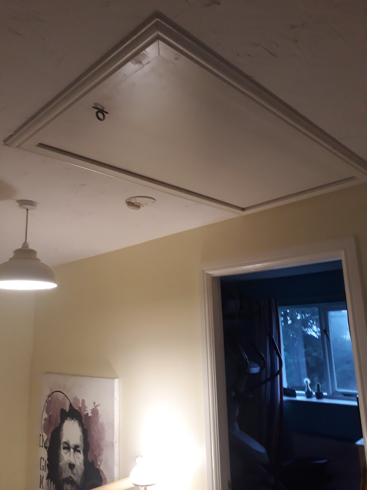

Here is a dumb question for you Skip and I probably know the answer because I will probably do this. But how do you pull the stairs down?? Do you have a pole with a hook somewhere?? That is what I am thinking. I have a linen closet right in the same hallway that I will probably store the stick. That actually looks like sturdy stairs compare to some I have seen.
John, I can just reach the catch and I'm 5.10. It came with a pole I think but we must have binned it. The beauty is that as it is spring balanced, it easy to gently pull down.
Missus just told me that we still have the pole. Maybe if you have extremely high ceilings, you could have a string and something you have turned, tied on and just within reach.
