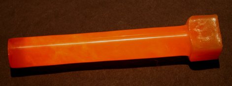

OK, I pulled my 4-color orange blank.
The good news is it set up beautifully and turned beautifully.
The bad news is that there was no layering of colors in the final result.
What you are seeing is a rough-turned and polished blank back-lit so you can see the colors. And back-lighting it is the only way to see the colors. [:(!]
I don't know what I did wrong but all the four colors blended together. I poured each color in "swirled" layers making S and Z patterns as I poured. Then I dragged a bamboo skewer through the layers from one end to the other. Had Light-Orange, Orange, Orange-with-glitter and Dark-Orange. Looking at the pen blank you maybe kinda see the dark-orange swirls. All the glitter passed through all the layers and settled at the bottom.
So, was I supposed to let the stuff start to set before I poured it so it would stay more stable? Was I supposed to add some gelling compound? Clue me in. Please!!

I've tried a couple times when I had a little left that wouldn't go in the mold. I'd pour the left over into a cup just to see what would happen. They pretty much just blended together. Someone will let us know. I think it has to do with when you pour the diff colors.
