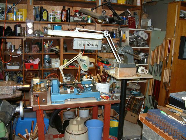

Jim, I use a bearing press (arbour press) as well. I fixed by gluing a thin pierce of Corian (sample from Corian dealer) under the anvil and also to the base aluminium having discarded the loose base thing
Built a stand mounted on a small table at my eye height I have a sit down bench for turning. I sit on a swivel chair so I am higher than the bench (ever so comfortable). the press I bolted the base aluminium in place through the casting. If you send me a pm I can send you pics of my set up and bearing press etc using your E Mail addy.
Kind regards Peter.
Quick pic for now.
Peter.
