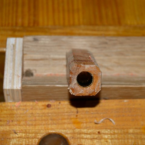

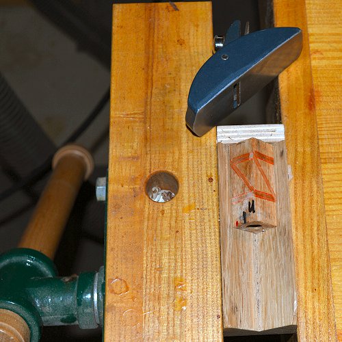

My shop is in my basement. On those nights where I want to stay late in the shop, but the other 50% of the house prefers to sleep, I do things that don't make noise.
One of those things is cutting the edges off blanks by using a small block plane and a holder made from a scrap of v-block.
A few quick passes with the sharp block plane gets to:
In this example, I used it to round the edges of a Celtic knot blank, to reduce the chance for a catch and a blow-up.
Worst part is, the other 50% get choice of the pens.
