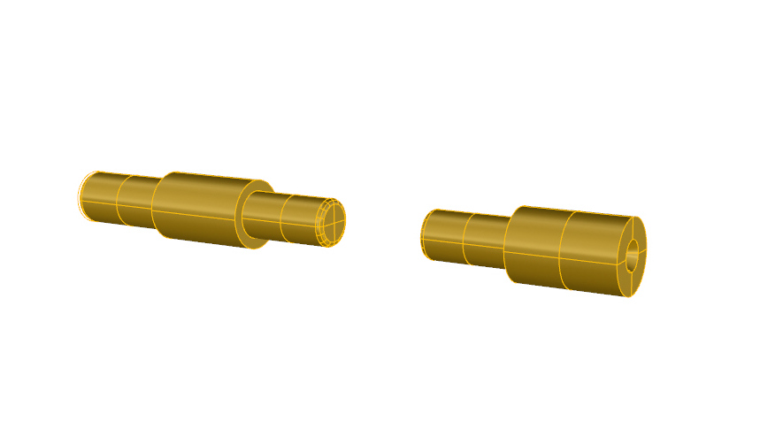

I make bushings out of brass for each tube size, one side is gripped by the chuck and the other has a 60 degree hole from a Center Drill bit to fit the live centers on my lathe. No mandrel.
Each bushing is only about .040 wider than the tube. (.020 each side)
Most pen kits have a .040 wall thickness each side. Since I measure all my parts I dont need but one set per any tube size. I dont have to worry about which bushing goes with which kit.
The one for the headstock side has a shoulder to fit up against the jaws and at least 1/2 and inch of free space between the chuck and the shoulder that stops the blank. That give me room for the tool as it comes off the blank. The one on the head stock is usually around 2 inches long and the other is about 1 inch long.

Here is a quick picture for reference of how I shape the bushings for any given size of tube.
I like the design and would probably have made virtually the same thing. I want a shoulder like you have to prevent pushing back into the chuck and it's long enough to keep you away from the chuck. Well done. Now to find some brass. Chutzpah I've got, but no brass thingees. :biggrin:
Brilliant idea. I will copy. No more buying bushings for every pen kit. Good money saver too!

I will add an important comment to Mike's post showing his design for brass bushings. Notice that the portion of the bushing that fits inside the tube is fairly long. There is a reason for that. The added length helps minimize wobble or runout as compared to typical mandrel bushings which rely on the mandrel rod to accomplish that, and often fail to accomplish it effectively due to low quality typical of many "kit" bushings.
attachment.php
How many of these did you make? Not being in the business I think I'll just start with one for slimline pens and just mike the wood down to size. Finally got my brass in after the obligatory glitch.

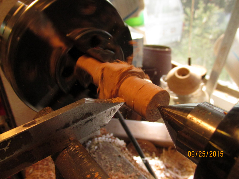

The following is just the way I do it. I use a skew and if I am in a hurry can get most wood round in less than 5 minutes on the lathe. As long as the skew is sharp the blank does not stop turning on the mandrel. Unless you have a dedicated lathe for each set up, the conversion of the lathe for each set up will take you at least a few minutes for each set up. If you have one set up for rounding one for drilling and one for finishing you are spending probably 15 minutes just setting up the operations on the lathe. I do everything on my mandrel and leave my drill press set up for drilling and the only set up time I have is finding the correct bushings.
My best process improvement was learning the skew.

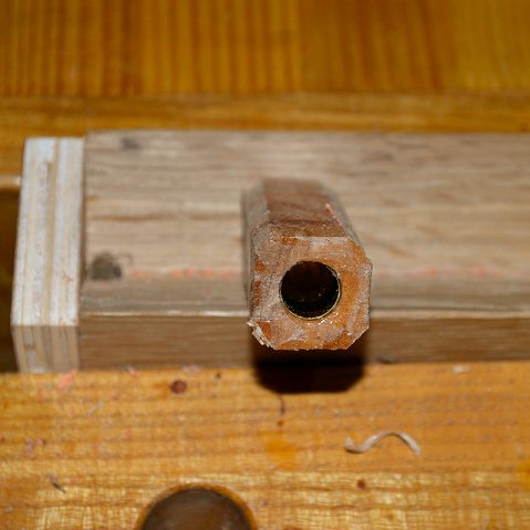

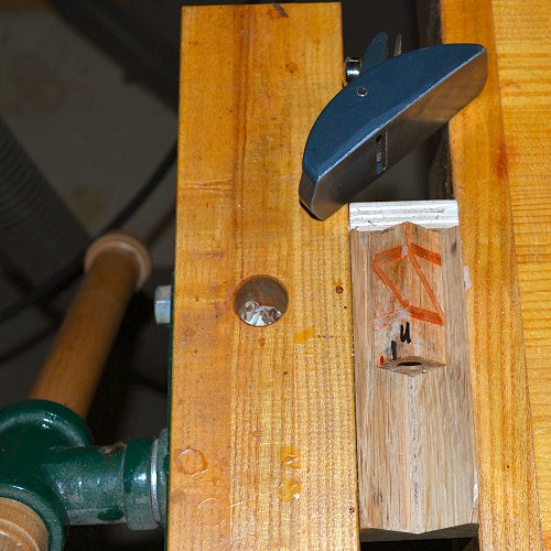

One of those things is cutting the edges off blanks by using a small block plane and a holder made from a scrap of v-block.
A few quick passes with the sharp block plane gets to:
In this example, I used it to round the edges of a Celtic knot blank, to reduce the chance for a catch and a blow-up.
