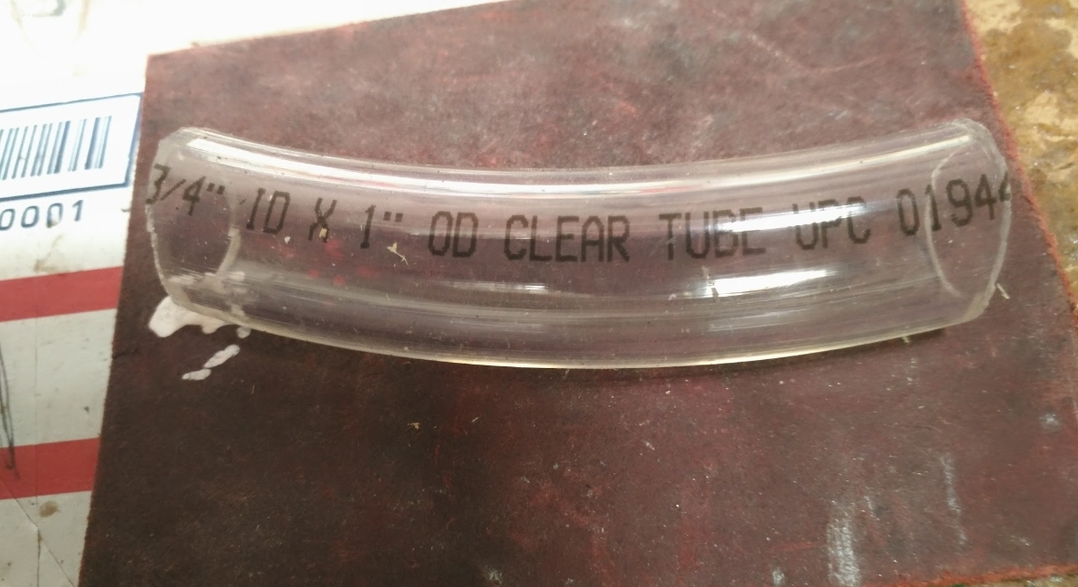

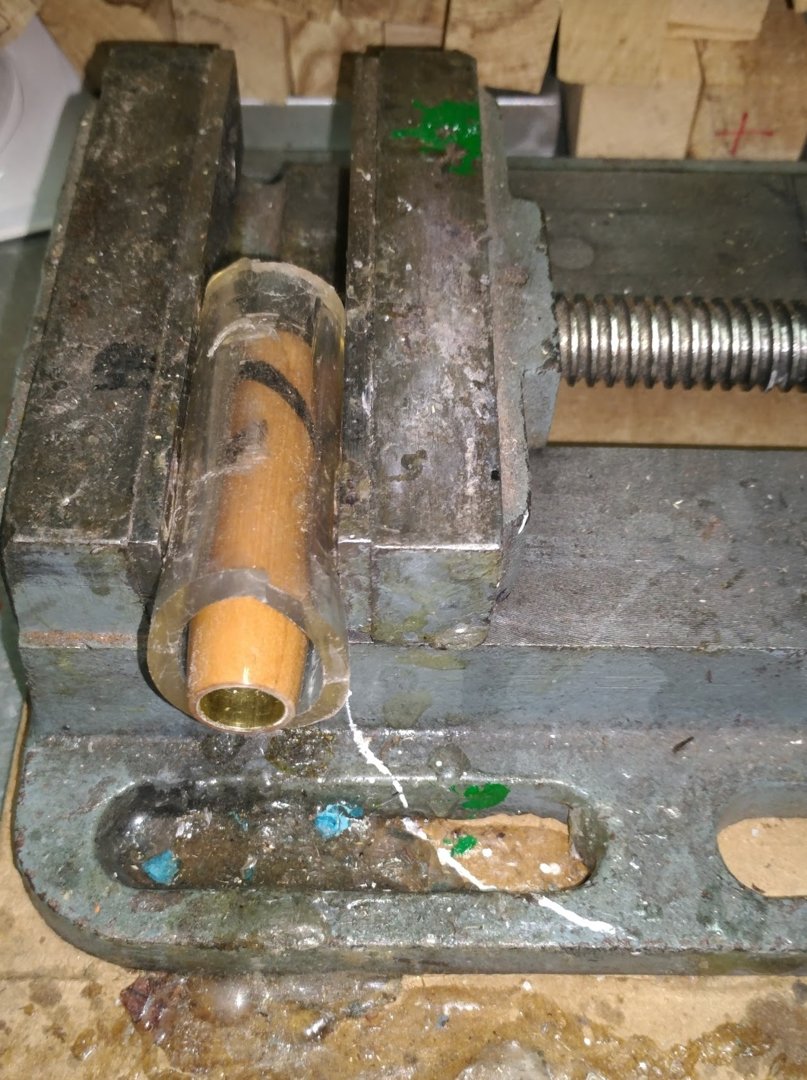

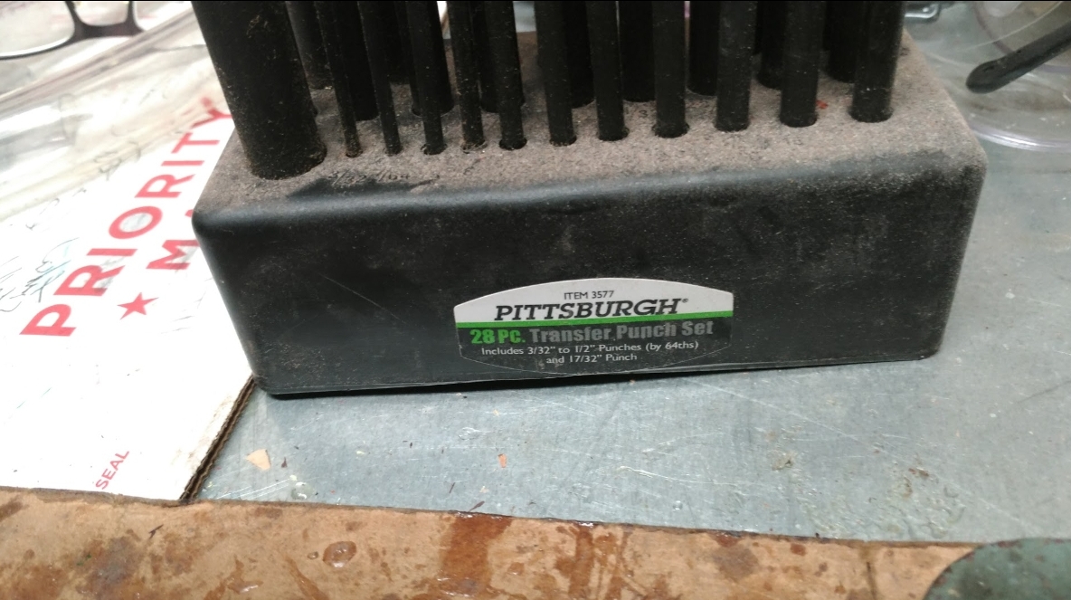

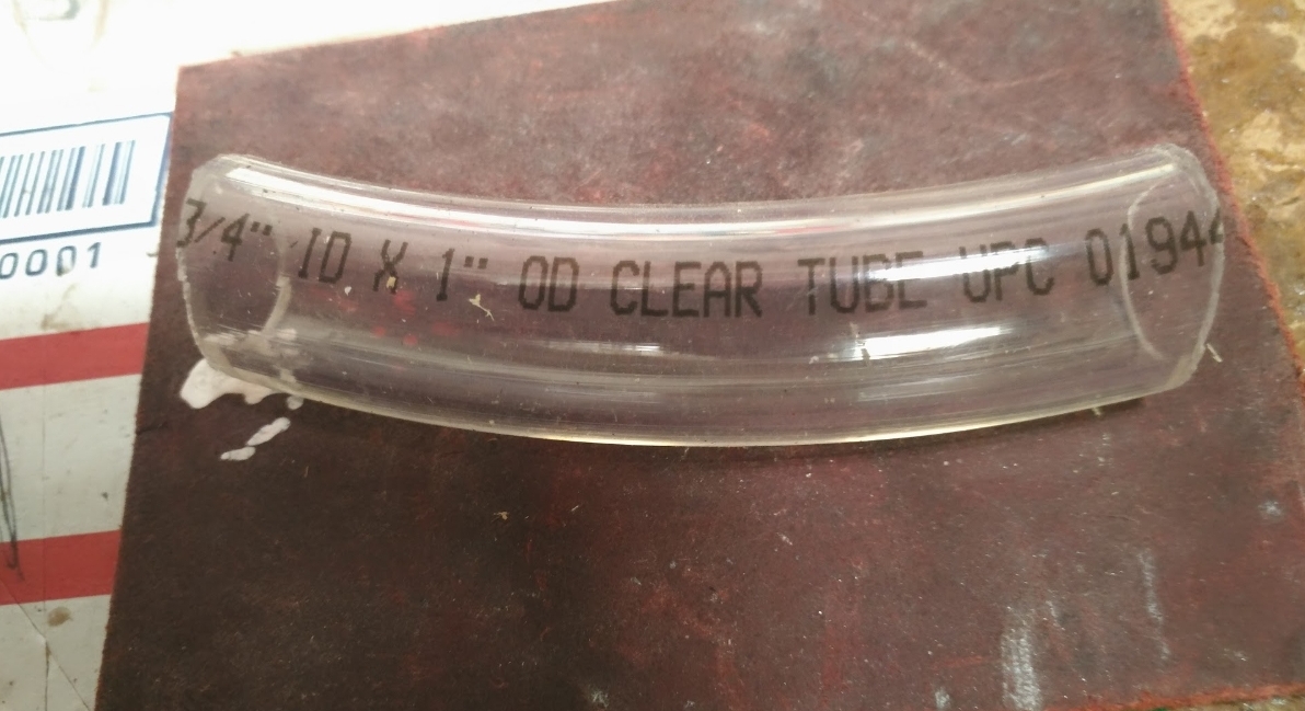

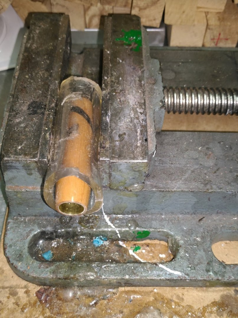

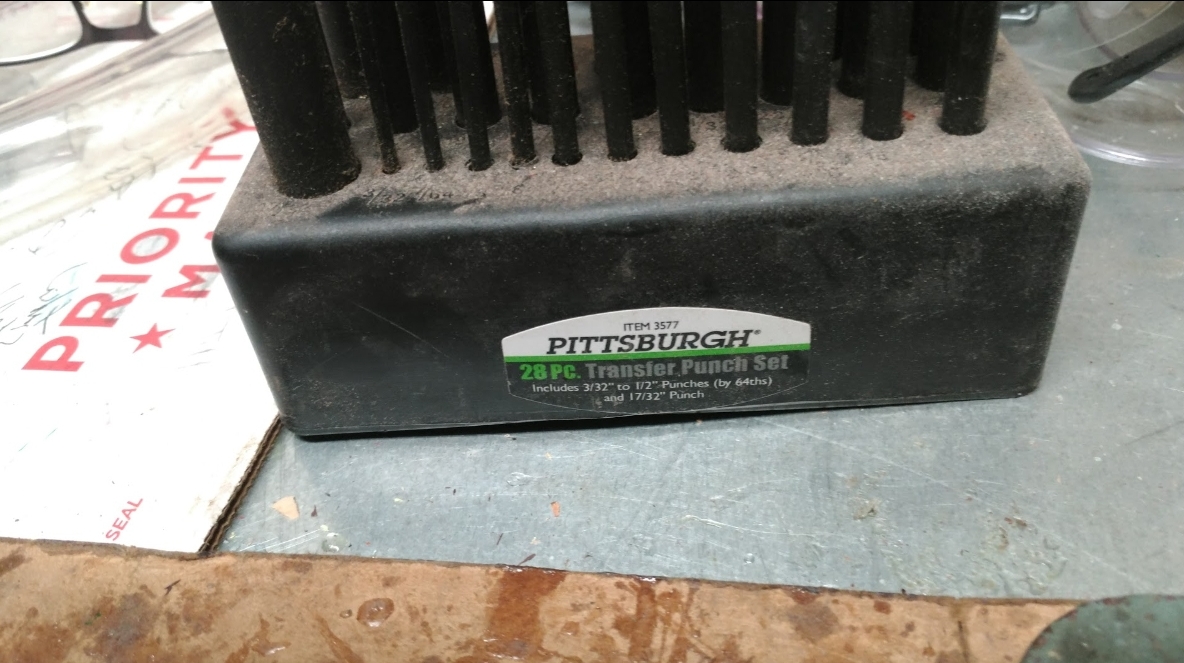

Yes, you do risk crushing the blank even with the rubber tubing. Perhaps a different material will pose less of a risk.
Here are a few pictures of what I use, the tubing is 3/4" ID & 1" OD.
I've found through trial and error a thicker tube allows you to clamp tighter on the vice jaws and hold a larger part of the pen.
