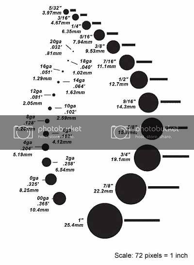

How are they sized? I know they are gauged but what does that mean in inches or mm?
I've been aske for some but I don't know what a 3 gauge is.....
this might help you.

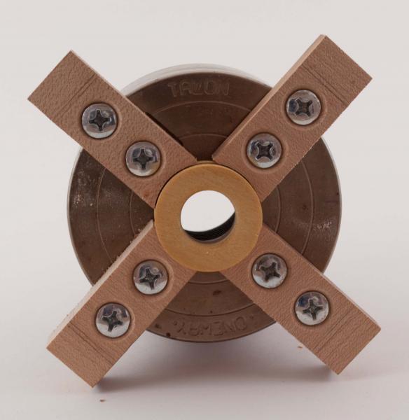

Here is a ring held in the wooden chuck jaws.
I just replace the standard jaws with some scraps to make the jaws. Run the chuck up to a good speed to force the slides against the scroll then run a Forstner bit into them. After turning on my DIY expanding wooden chuck and putting the ring in the wooden jaws of the scroll chuck, it runs perfectly true.
Sweet! Thanks for the info and pics. I will definitely put this to use.
