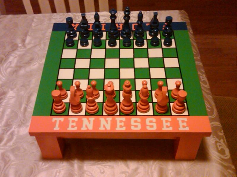

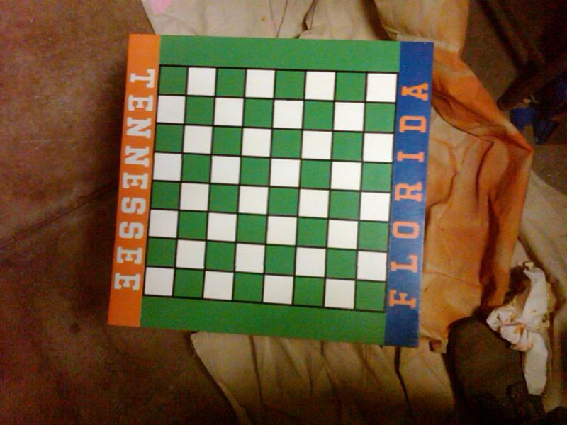

I did this one a couple of years ago. I used cheaper wood since it was painted. I'm an Ohio State fan so it was really difficult for me to do this with two SEC teams. Made the pieces on my lathe with a duplicator and templates from Penn State. Charged $250 for it.
