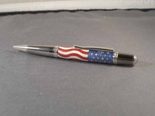

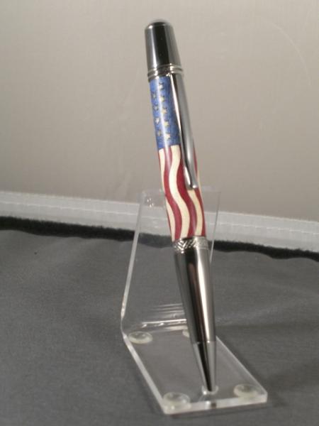

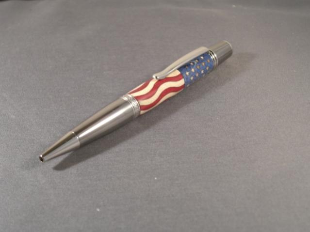

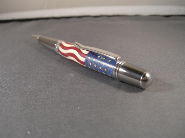

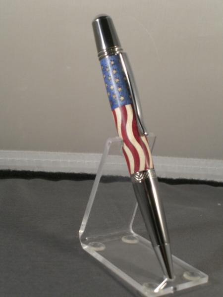

I just did my first one. I have to say it is nerve racking but try to relax. These are well made and seem to be hard to break since I dropped mine a few times. Anyway here it is. I got the kit from Constant.
The kit is a black titanium and platinum wall street II.

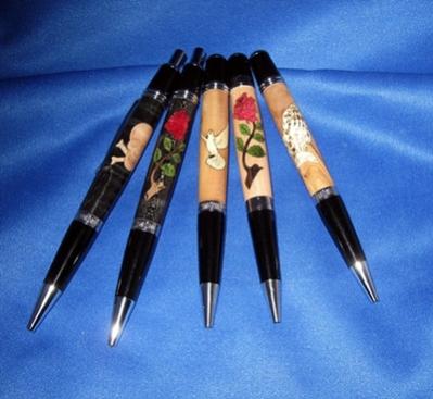

Looking at the humming bird, deer, poker, and puzzle pen. My friend saw Constant's web site and got ALL excited.
I've done a couple of Constant's kits and the scariest part was 'breaking' the parts to make them fit. :eek: But they all worked out perfectly if you take a little care and don't lose any of the small parts.
