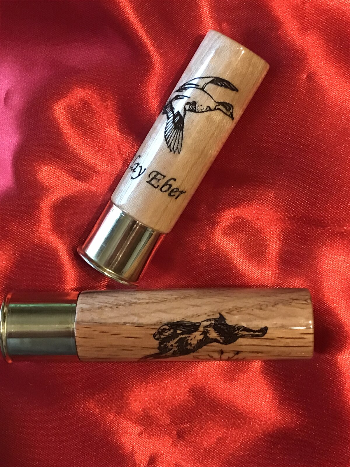

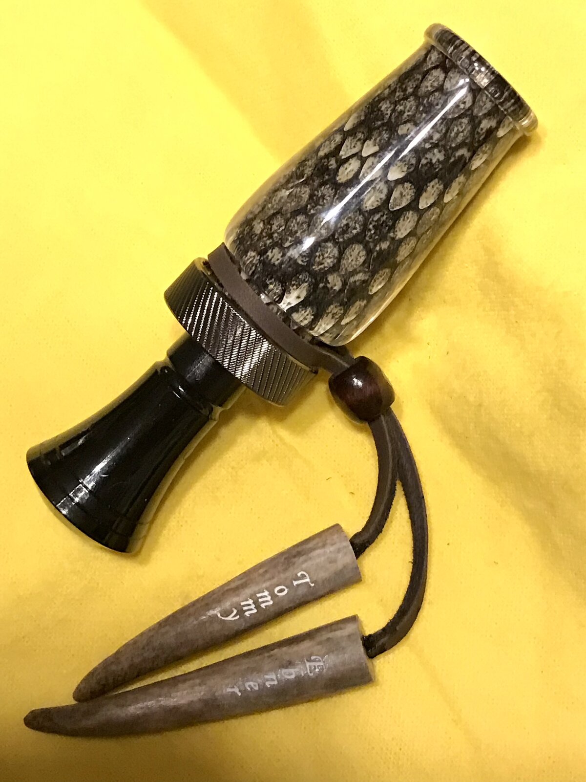

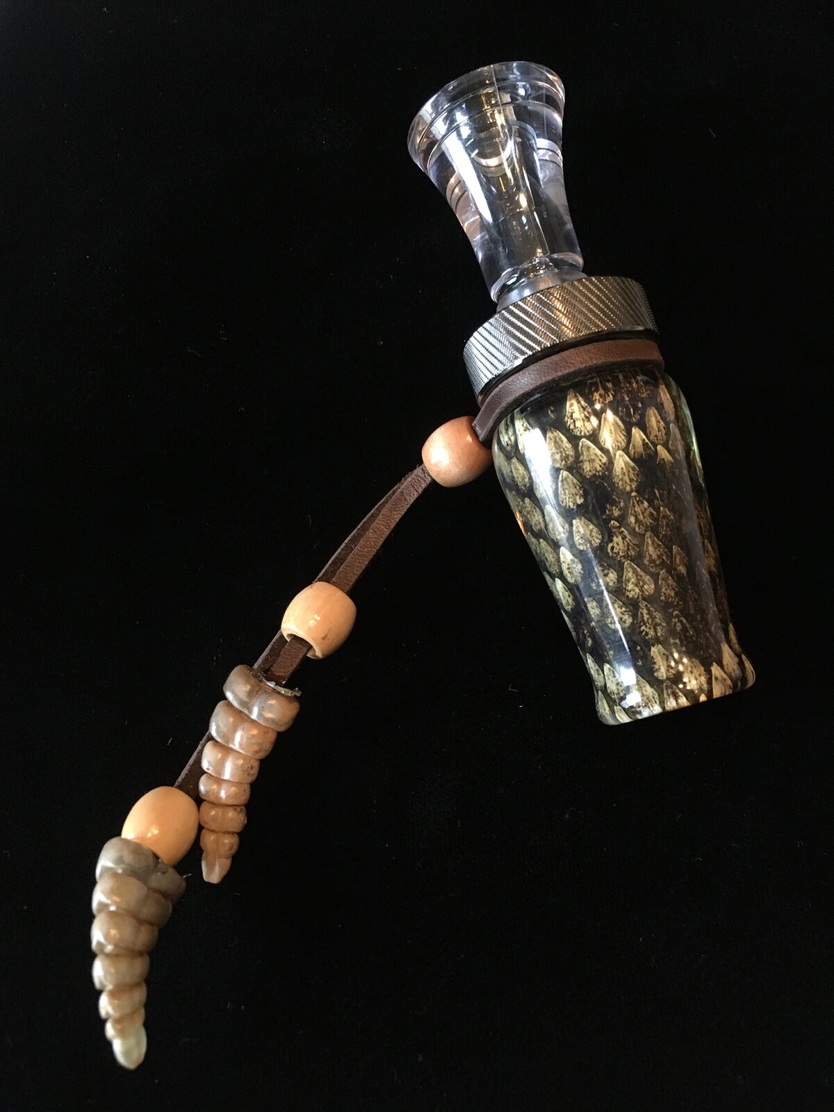

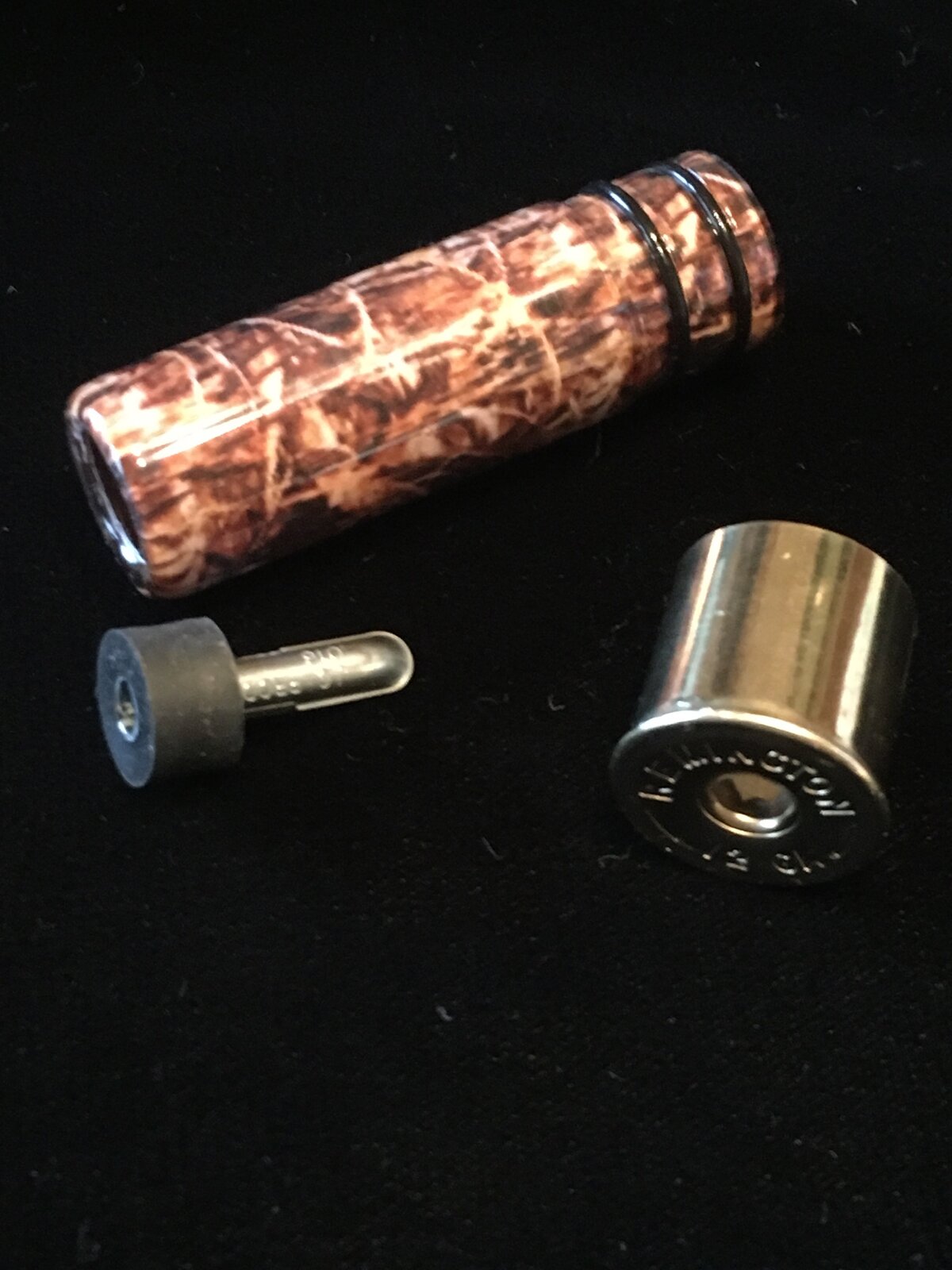

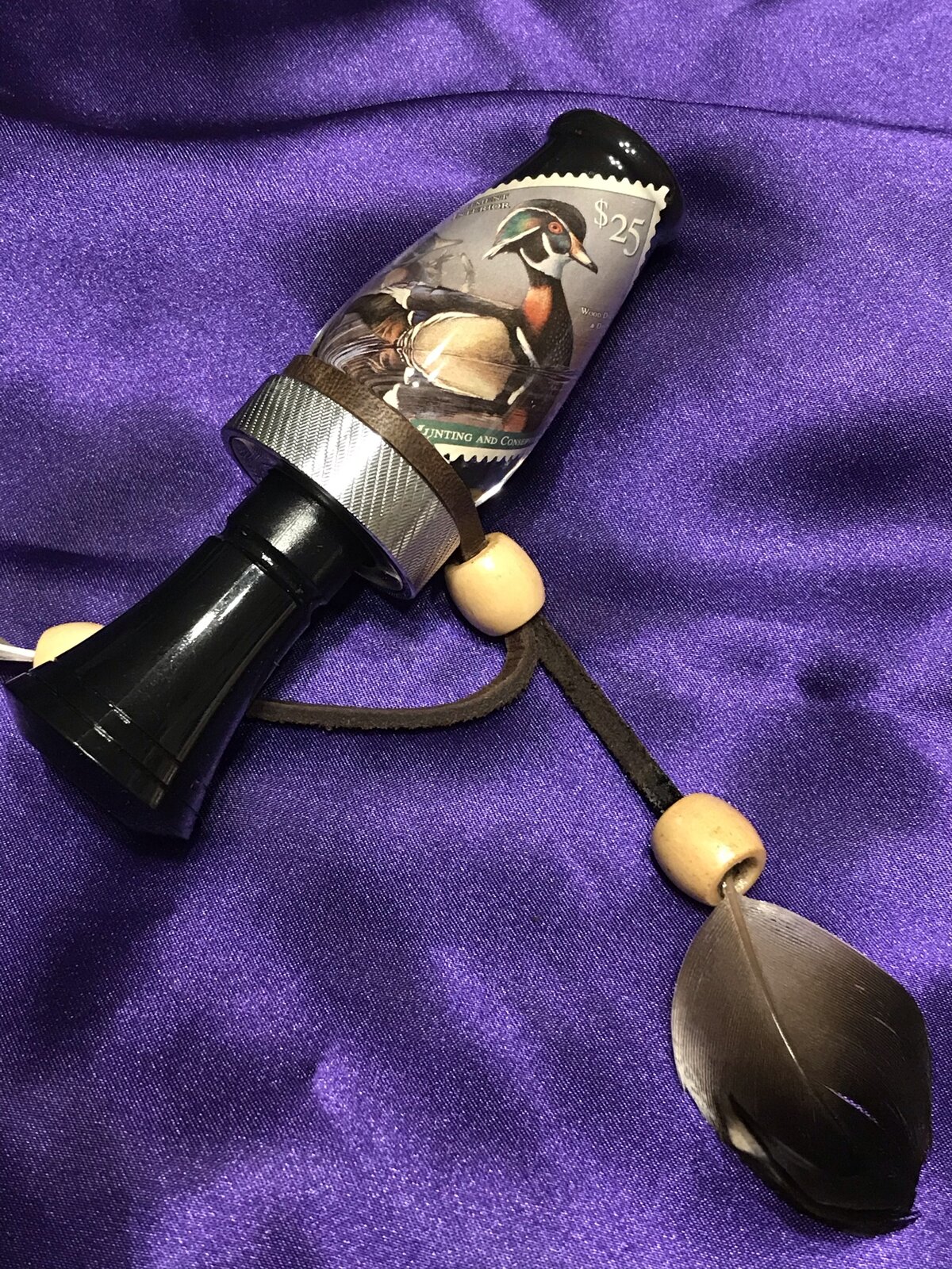

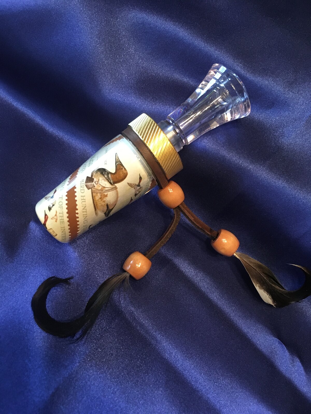

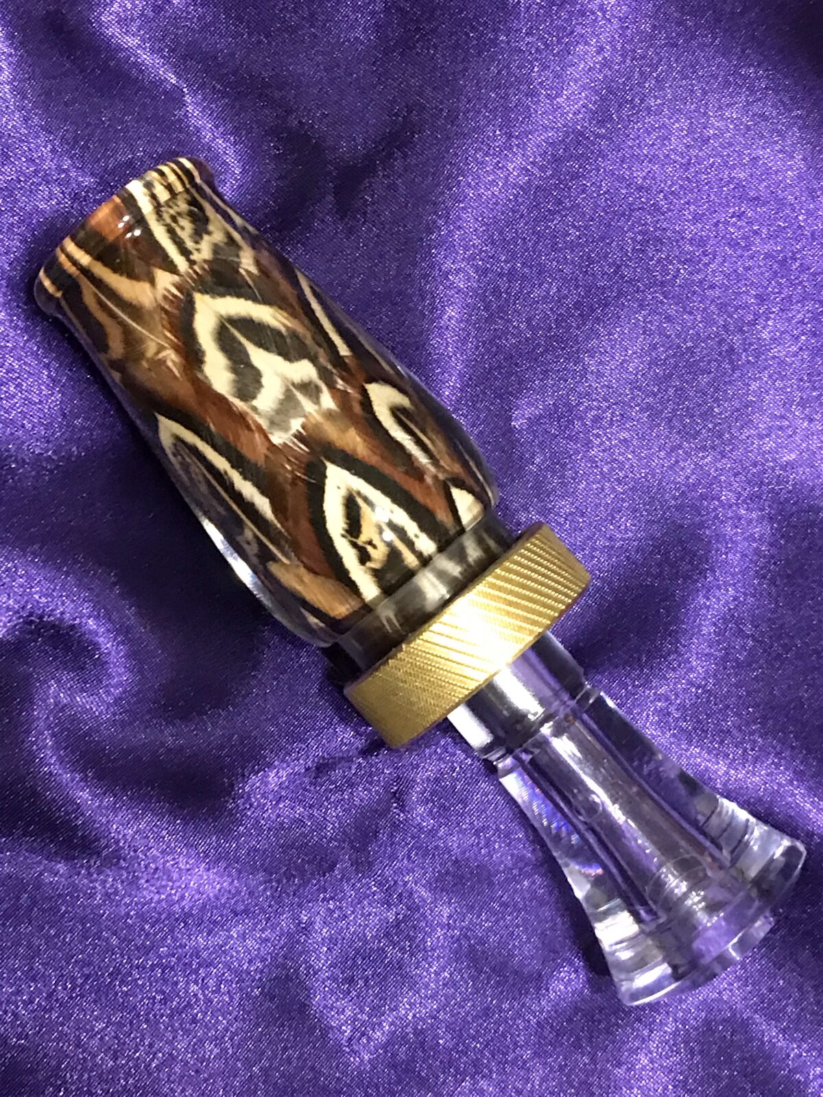

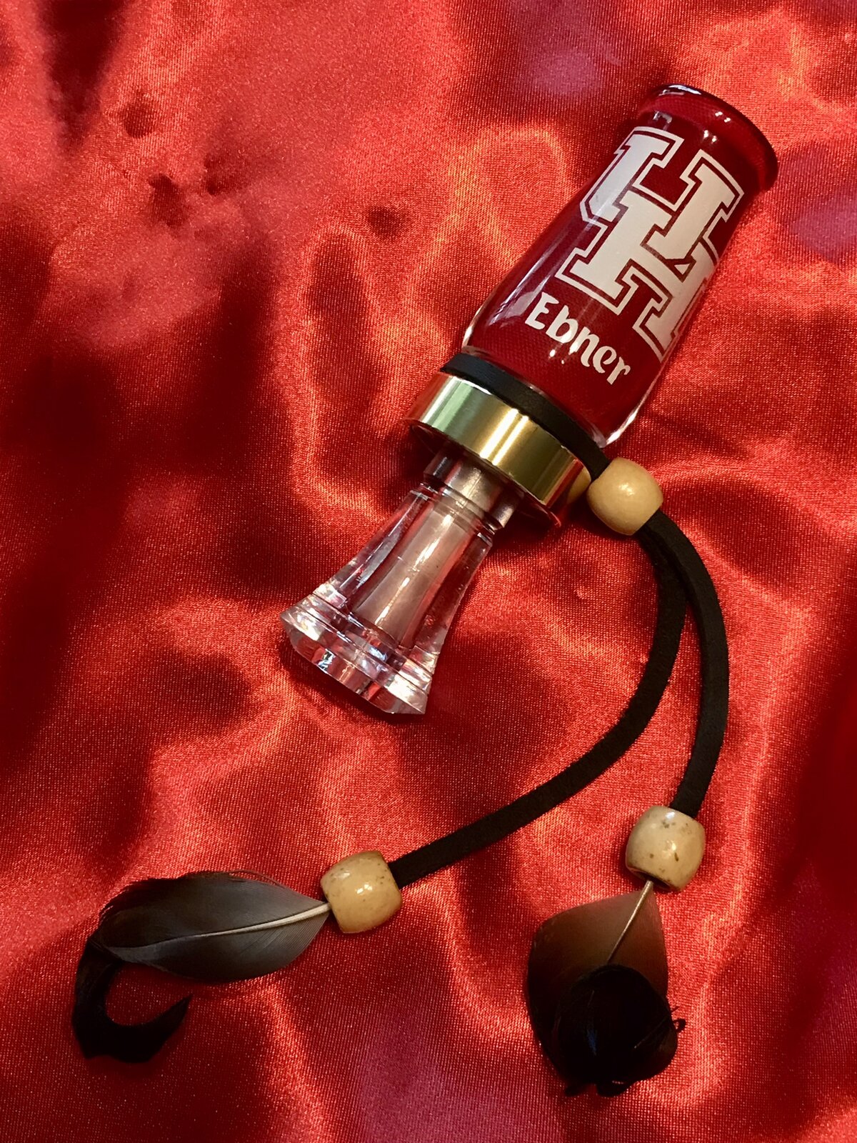

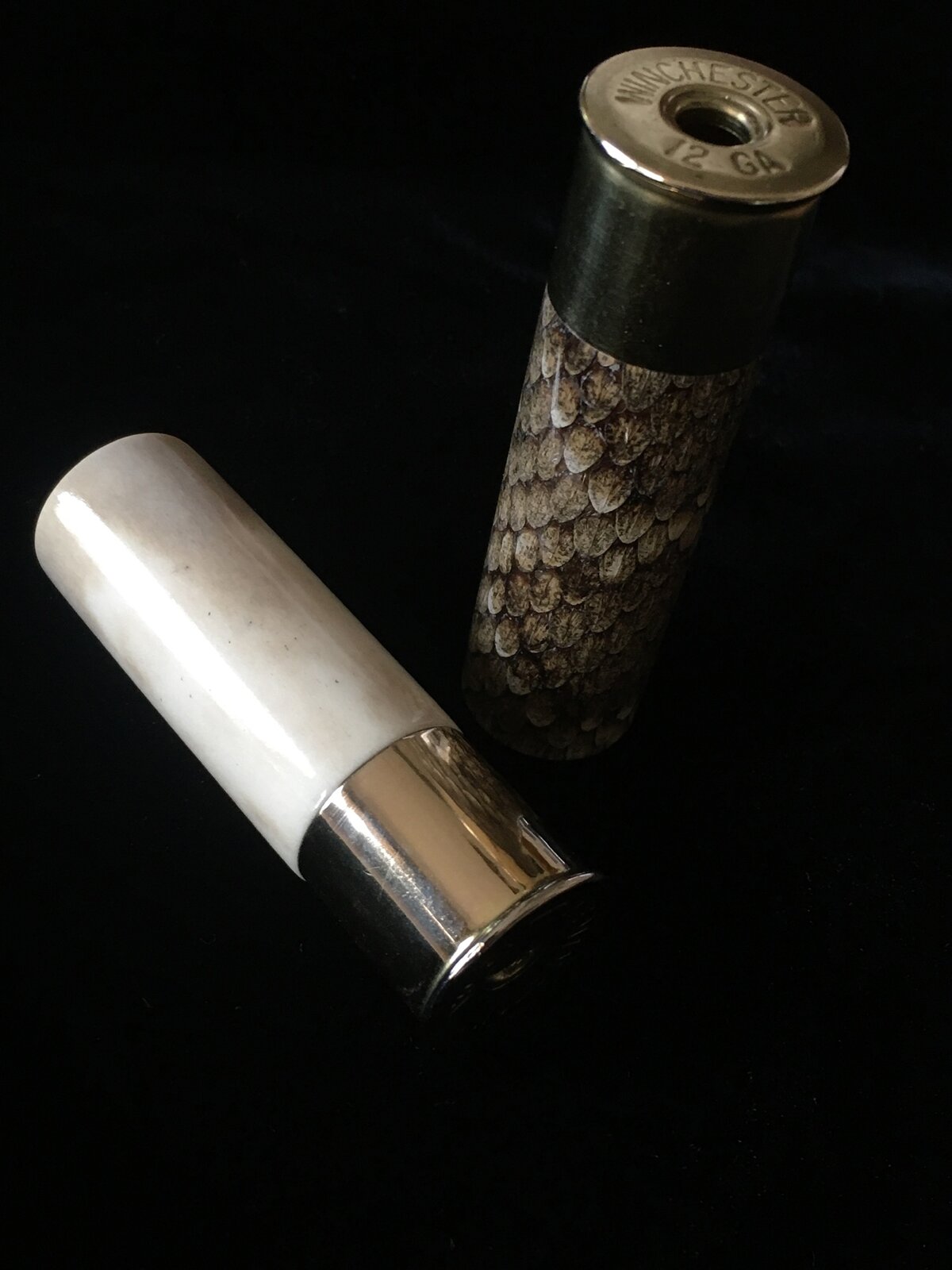

I've made several calls. I would like to someday make my own reeds but it's a complicated process, at least in my opinion. I buy the reed assembly at local woodworking stores. I like making the barrel about 23/4"-3" long. I don't want the call to be too bulky swinging on a lanyard. I also use a call mandrel to make it easy to flip back and forth while shaping. I also make shot shell calls with the brass from a 12ga shot shell. They have reeds with a 1/2" grommet that slides in the hole. Here's a few pictures to give you an idea of what I've made. Lots of fun and a nice break from pens every once in a while.

I really like those shot shell calls. With my shop just getting up, I really don't have any wood right now. I epoxied a couple short 2 1/2" pieces of wood I had and cut it at 4". Seemed to be a little long when I got done shaping it. I think I'll go down to 3" on my next practice piece. Thanks for the response my friend!
