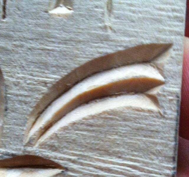

While completely re-doing my wood shop due to life's little glitches I've taken up trying to learn chip carving. Have had a few A-ha! moments already and wondered if any of you do this as well. Have to remind myself to let the tool do the work but getting there!
I don't know what kind of wood that is, but get some basswood. It's tough enough to learn a technique on the right material, but using the wrong wood will give you fits. At first thought, I'd say you went too deep, too fast. Concentrate on smoooooooooth. Long sweeping curves. Slide your bracing thumb on the wood as you pull the knife. Usually the end cut like that is one facet, made in one cut. Get any information you can from Wayne Barton. He is a robot at this work. Took a weekend class with him at a Woodcraft years ago. Also, if you can't see yourself in the bevel of the knife, it's not sharp enough.

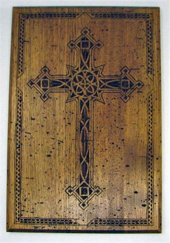

One of Barton's patterns on carved on Wormy Butternut!
