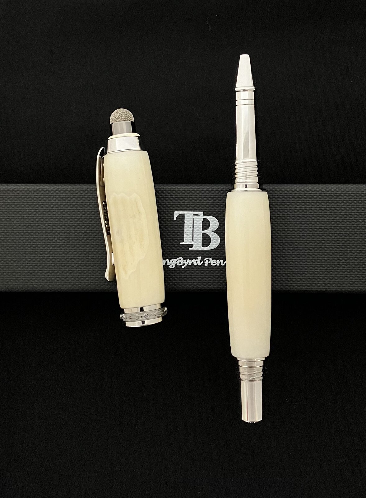

Here is a Hippo tooth Jr Statesman modified to have a stylus and some hippo teeth.
Don't know why the pictures came out so large.
