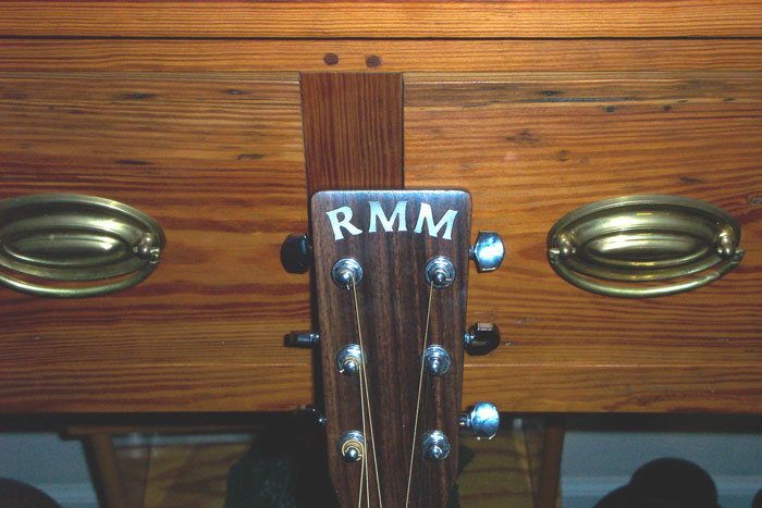

This is a photo of a Southern Huntboard made of 130 year old Southern Yellow Pine from a house built in Savannah, Ga. in 1868. The grain of yellow pine is as you describe and if you smell turpentine like odor from the wood then you got Southern Yellow Pine. I made the Huntboard around 1980 when I still lived in Savannah. The wood was left over stuff from the renovation of the house.
The guitar is a Martin Herringbone that I made from a Martin kit.

Thank you, thank you, thank you. I have been trying to find out that answer for two months now. Is all yeller' pine that loaded with resin? It feels wet, even and it does cake up when you saw it on a band saw. I am glad that it will take a finish. It is most like the stile between your drawers. I'm going to try angle cutting it. Thanks.

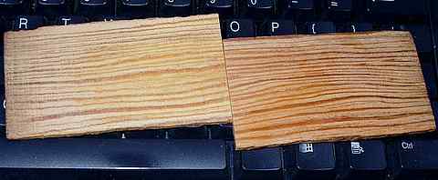

Rob--here's a thumbnail link of the longleaf pine...a relative of southern yellow pine.
It was finished with shellac for the base coat, followed by lacquer and topped with TSW.

That's a gorgeous pen. The two woods do look very similar. I think I'm going to make my first pen out of it, and if it turns out anything like yours, I'm going to post some blanks for sale. I will of course keep a bunch for myself.

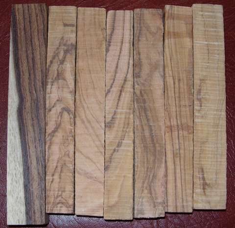

I just got a delivery to my door. It is a sample from a supplier in Jerusalem. Check out what I got as a sample. It contains 6 Jerusalem Olivewood and something else. I have to look that end piece up. It looks remotely like bocote, but with less color. My supplier is touring North America, so I can't ask him. I am trading bloodwood and some other things for it. I'll take as much as I can get. It isn't as dark as BOW, but it is nice.

Yes, the color is correct, but the flash made them half of a shade lighter. I finally found the original e-mail, which identified the wood as Indian Rosewood with sapwood. It doesn't look anything like the East Indian Rosewood that I got from WestPenn Hardwoods. This sample is much nicer, cleaner and crisper lines. It will make a nice pen, but I don't know if I can turn it, as I am hyper sensitive to most rosewoods, if not all. One of these days, I'm going to do an allergy test on myself, that I read about somewhere. You put a pinch of saw dust on a round bandaid and put it on your skin for a day. That seems like overkill, and I would want to use just a few grains, otherwise, I'd end up with a bad case of the itch. Any idea if the Indian Rosewoods are different? I'm off to do some more research. I've got an hour before my wife gets up (I am the cook around here).
