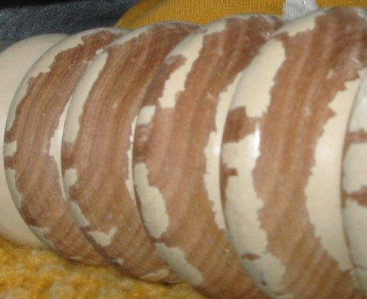

I examined the bed and found a spot on one of the posts where the paint was badly chipped. Anyone able to identify the wood from this photo?

True, but I think that with legs broken off and the rest drilled for casters and splitting from this hack; it is going to fall under the "not likely" category for collectibles.
As for the wood, maybe old growth pine? It may have the brownish look from the paint. Watch that paint too, there is a very good chance that its lead based. Send it to China to be stripped; maybe someone on the new pen site over there would have a good method of dealing with lead paint in consumer goods? [}:)]

As I look at the wood grain with a fresh mind in the morning, it seems like the grain runs perpendicular to the post, not parallel. Am I just imagining this? These posts are 5 feet (2.2 m) long.

What you are actually looking at is the growth rings. If you look at the grain on the end of a board, you'll see a similar pattern. The actual grain runs the length of the post. It just wouldn't be strong enough corss grained and would have broken long, long ago.

I wonder if the wood could be Kentucky coffee tree wood. I think that has a similar ring pattern from what I can see of it and the coloring is fairly close. That tree was used a lot during the mid-1800, especially in the Kentucky area.

The Kentucky coffee tree wood is an interesting notion as we had Kentucky coffee trees in the yard back in Louisville. My aunt just showed me some newspaper clippings from The Sunday Herald Post in 1930 where the beds are displayed in a beautiful homes of Louisville article.
It looks like I can buy this type of wood on ebay...
