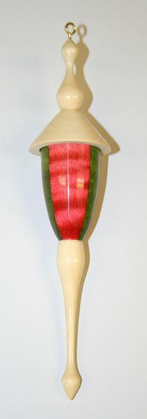

This is a ornament from maple and holly. There are a total of 7 pieces, and several hours. Thanks for looking, Russell

Can you enlighten us as to how it goes together so we can steal, ahem,...I mean try it ourselves.:biggrin: Possibly a tutorial?
I have used six pieces but the seventh is eluding me. Where do all the pieces go?

I think Cindy nailed it. Actually it is 8 pieces. 1 for the top finial, 2 for the round cap because it is too wide for the body by itself. 4 for the body and one for the bottom finial. Lots of glue, and put your glue joints in the narrow transitions. I will try to post a few in progress pictures on the next one. Hope this helps. Thanks for looking. Russell

Excellent work Russell - very creative and quite pretty. I'm sure it really looks great on the tree. May I ask how heavy it ends up being?

Hey Linda, the ornament is pretty light. The body has been hollowed out with a forsner bit. I drill the body and then reverse chuck it to turn the body and bottom finial. Then you won't mark up the finish. I complete the lower body before taking it off the lathe. Then bore the top and reverse it to turn it. Hope this helps. Russell

Great job as always. Not sure I understand how you did the hollowing, but maybe we can chat at the meeting.
