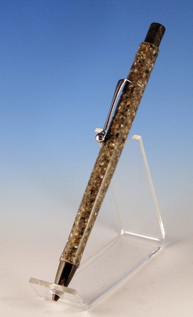

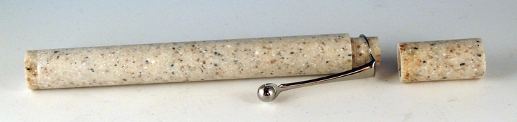

Here's a way to incorporate a different clip. Make the original blank a little longer, cut a 1" piece off and drill to fit a tenon on the lower piece which has the OD of a clip ID. You can also make the push button by using the original as an insert to what ever you choose. Just make the top hole a little larger to fit.

That's an interesting concept Bruce and may just have to give that a try. I am curious as to the nib in your picture as it doesn't look Pentel.
The nib is custom as well. The threads on a Pentel are 4mm x .5. I made a brass insert for the nib with those threads (tap bought on ebay). The hole for the lead is made using very small drill bits - I think its a #62 or close to that for the 9mm lead. A little tricky to get it centered but achievable.
