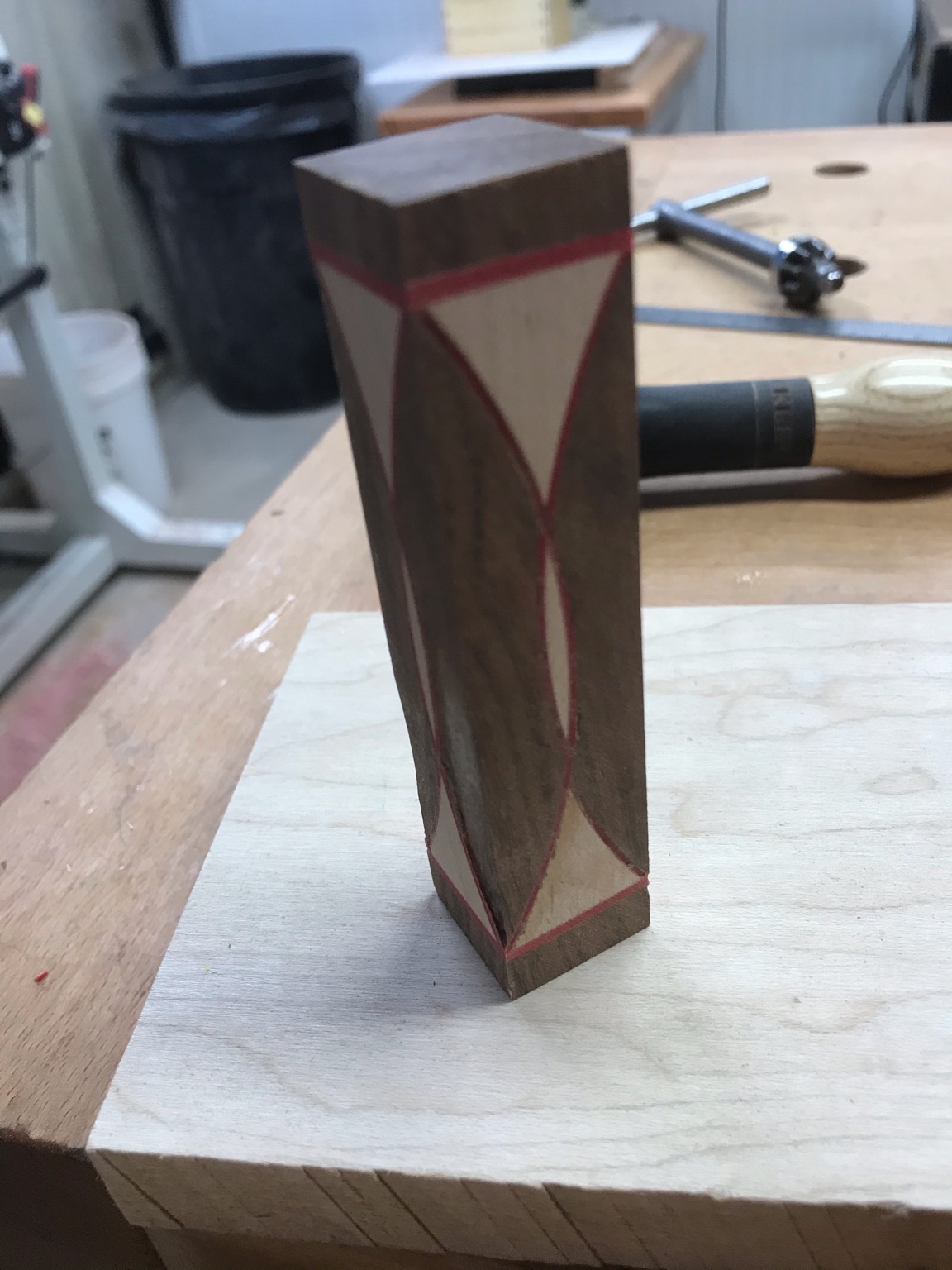

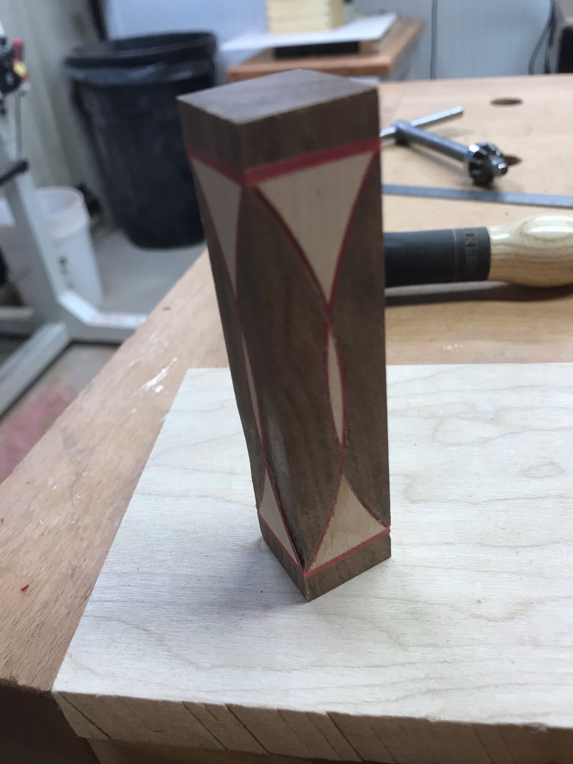

I seen this style blank posted here a few days ago , if I knew how to link it I would , but I don't. Anyways, I can't take credit for the design, but I can take credit for the jig. I wanted to make the jig a little more"elaborate" and more adaptable than the one I seen, what I came up with works great. I think these first two prototypes are a little too long, but I can shorten that up easily. I'm letting the glue dry on these and I'm just going to turn them round, to see what they look like. I'm planning on enlisting my wife to help make a little video of how my jig works. Not sure though if you can upload videos here. If not, I'll take some pictures.

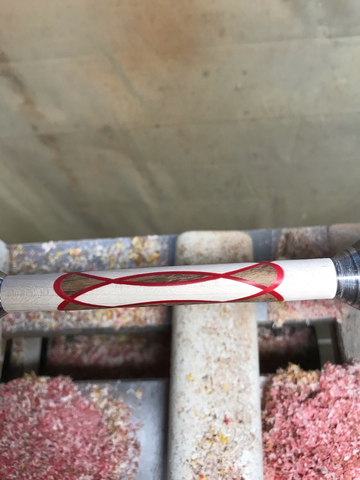

Well guys this may not be as cool as I envisioned. The design splits into two , badly proportioned Celtic knots. At least this one did, that I figured was too long. The one I'm making in the video, I shortened the radius up considerably. I'll see how that one turns out. Here's the first , turned to just over .500.

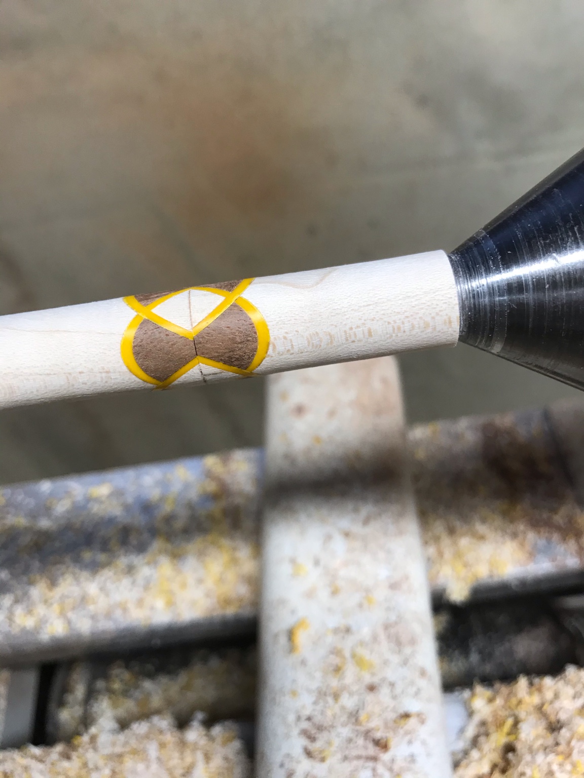

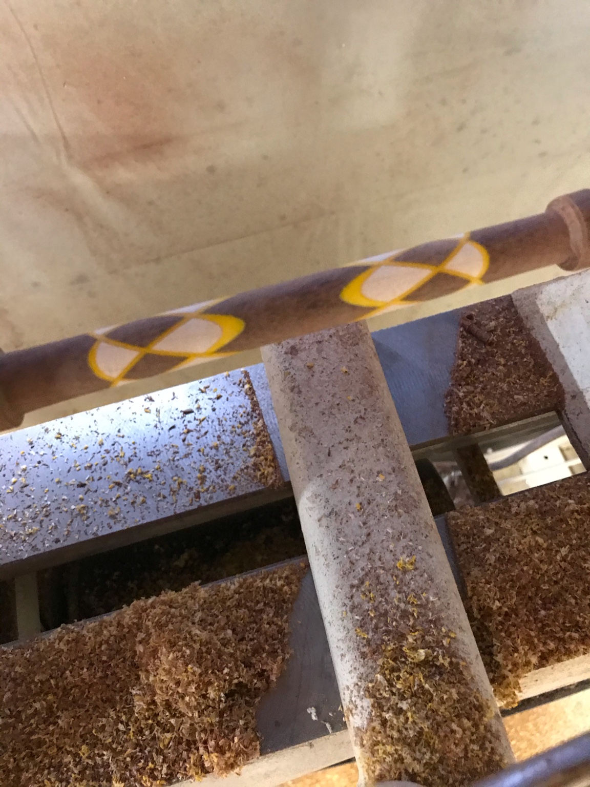

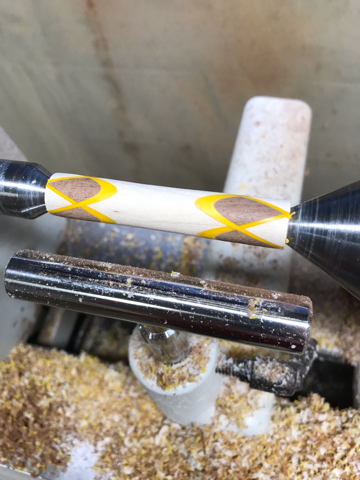

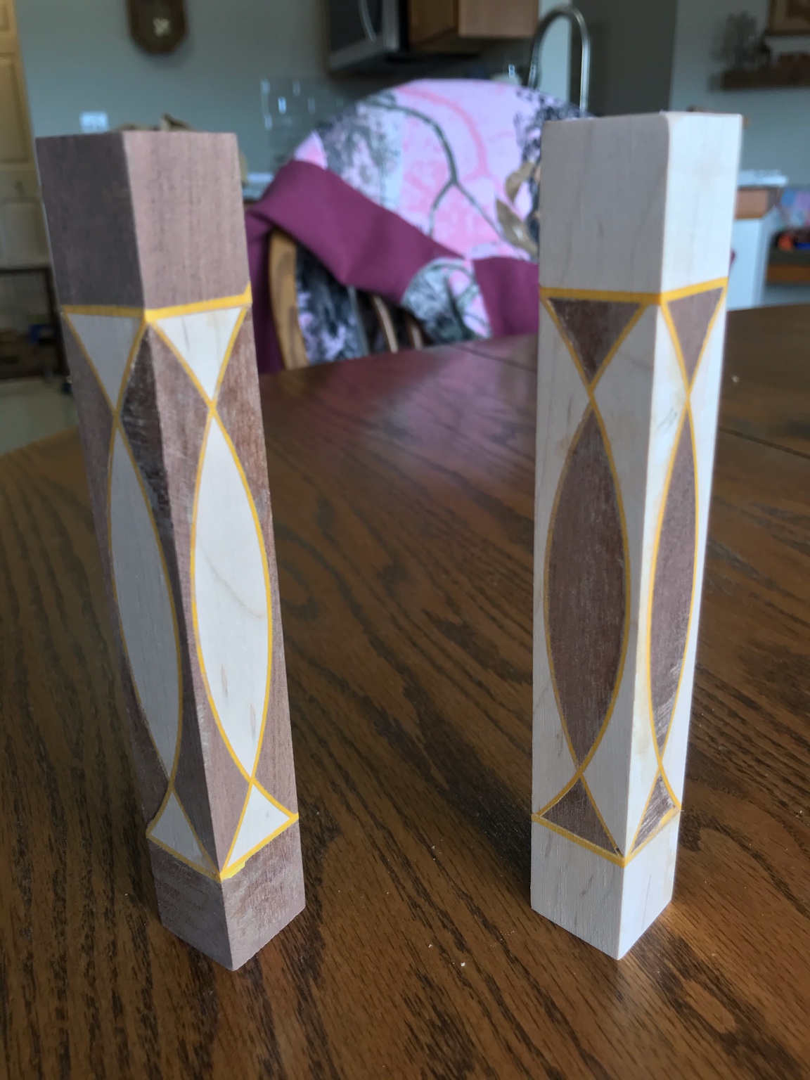

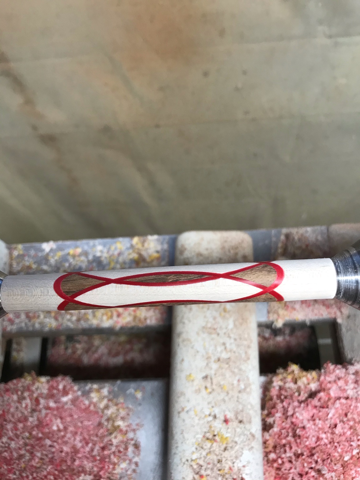

The ones I cut with a much smaller radius turned out like an elongated Celtic knot. This one I like so I guess the jigs a keeper. I forgot to take pictures before I turned the last one, so the pic I have is the opposite blank, cut the same radius. I was not picturing this in my head when I started. This last one is turned down to the GT Knurl diameter. These will work on long wood pens, like the Knurl or a Corona, anything with a 3 inch barrel.
It does not have to be a knot. Just another design. Do not like the glued up center portions. Even if you put some material in there not a good look in my eye. These are somewhat like making scallops in a sense. Many ideas can come from that simple jig.
The ones I cut with a much smaller radius turned out like an elongated Celtic knot. This one I like so I guess the jigs a keeper. I forgot to take pictures before I turned the last one, so the pic I have is the opposite blank, cut the same radius. I was not picturing this in my head when I started. This last one is turned down to the GT Knurl diameter. These will work on long wood pens, like the Knurl or a Corona, anything with a 3 inch barrel. View attachment 235908View attachment 235909
I like this one
I don't like that one either. Only way that one might work is in a seperation between a two barrel pen.
Ken I really like the one with the red strips. A keeper in my book for sure.
May I ask what the red material is.
Thanks
That red material is red vulcanized paper. I get it at USA Knifemaker, also available on Amazon. It's available in different colors. It's just resin impregnated paper and it so happens that it matches my bandsaw kerf perfectly. Another name for is fishpaper. Electricians use it sometimes as insulating material, so I've been told.
