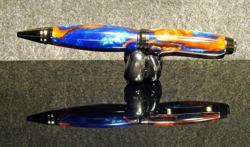

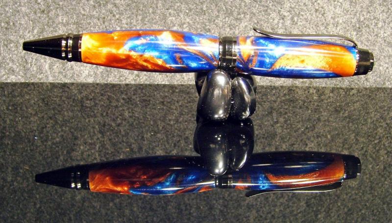

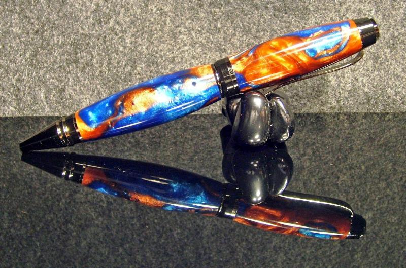

:biggrin: I got my new Lathe today a RIKON :biggrin: It runs like a dream come true. And this is my first pen with it, it is an Ancient Mars from Exotic Blanks on a Black Ti Cigar form Wood Pen Pro.It is MM to 12000 and then I used One step Plastic polish.
Any Comments Welcome and appreciated, And thanks for looking! :)

Great Job Max. What color did you paint the tubes? The colors are very bright
I didn't I used fine sand paper to ruff up the tubes then used a plain buffing wheel to brighten up the tubes then used medium CA and just let it air dry. I have turned about five of these for different customers, and I have used black, white, and the brass. I really like the brass on the Cigars because they are thick enough that you don't see the tube, but the colors really POP.
