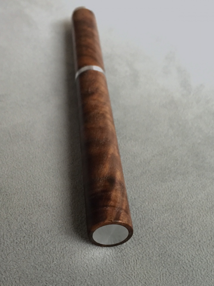

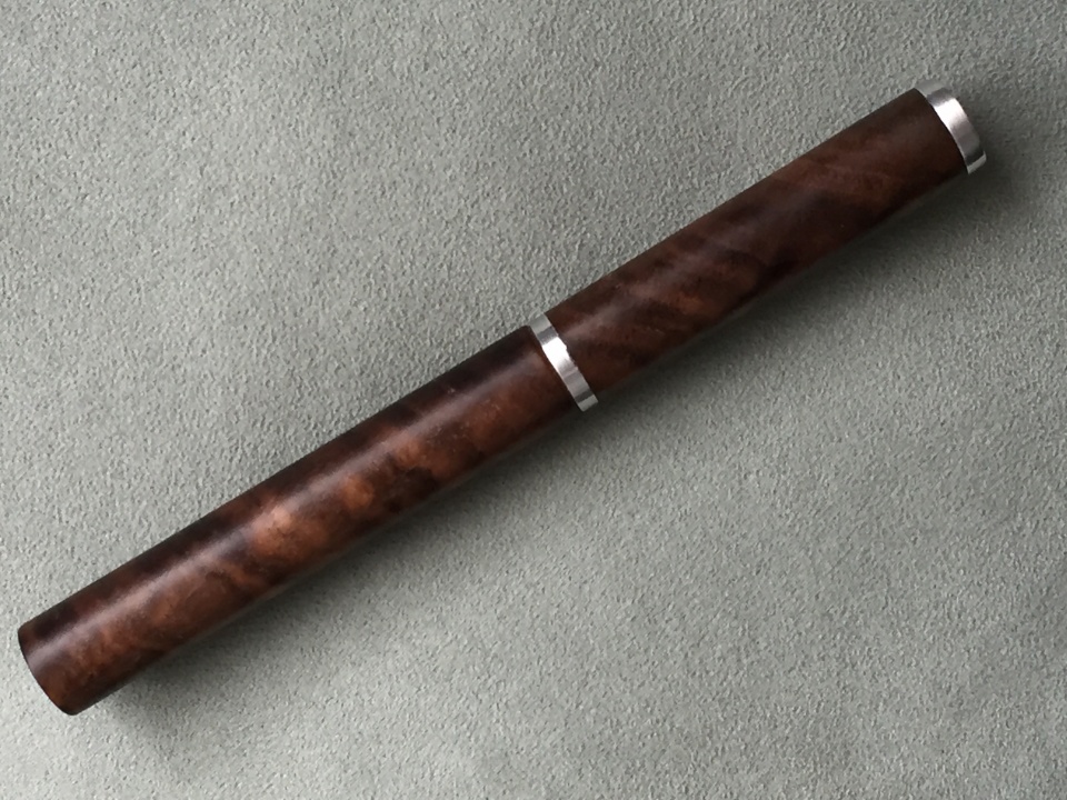

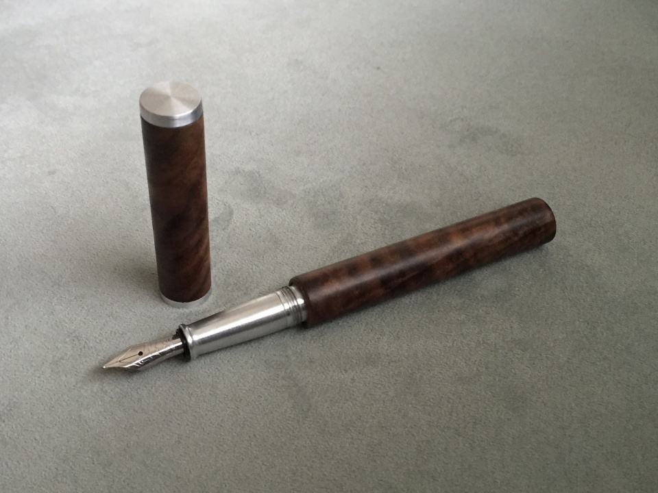

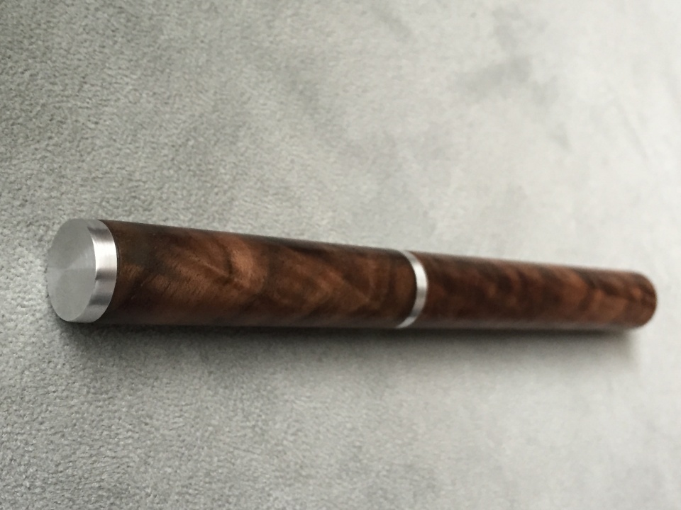

I had this concept pop in my head this week and needed something to show at the Houston IAP meeting Saturday. I essentially made a very slender aluminum closed end pen then glued it into a block of figured walnut. Turned the combined aluminum/walnut block. It is currently clipless but a clip can be added to the cap. Its a throw back to the 70's based aluminum and walnut architectural designs. The nib is a #5 Bock. Cap threads are 11mm and the pen OD is 0.55" (14mm).

I left the aluminum thick on the end of the body and center drilled the end so I could turn the body between centers. After turning I faced the end enough to remove the dimple. A black core peeking out the end would look nice. My next chore is to taper the aluminum core and match the taper in the hole through the blank to add a bit more character/curve to the pen.
Thanks everyone for the kind comments. This one was an idea that popped in my head that I had to crank out in a very long day. I've been working out some tweaks in my head to upgrade the looks a bit. A better transition from the body to the nib, tapered/curved body, finding the right clip for the cap, and a reverse inly in the cap finial to reflect the one on the body. I've also got several TruStone blanks to add to the mix.
