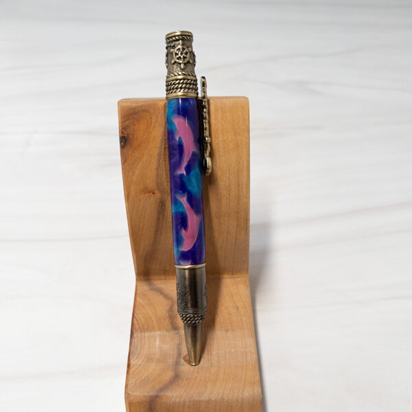

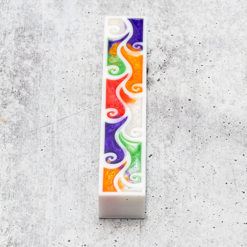

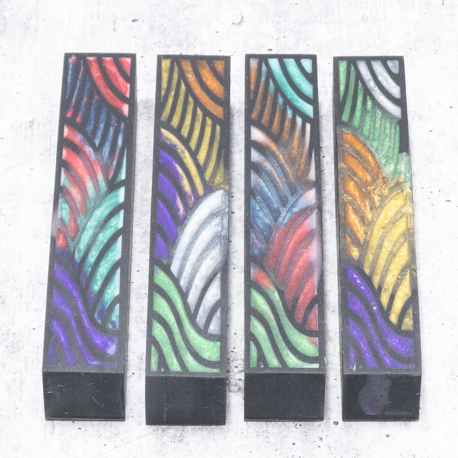

I print using sla printers and the cleaning step is to wash the parts in IPA, I have also used denatured alcohol. This is critical to clean the surfaces. Since this is a different process, I am not sure it will help much for your application but I do cast all blanks with Alumilite slow and in a pressure pot. Also I have had customers send PLA blanks to me to turn and the material is not always great to turn (chip out, adhesion, finishing). I would suggest looking at compatibility of filament options with the urethane resin and see if there are better options. Also try to clean your blanks with one of the two alcohols that I mentioned to avoid any surface contamination. The urethane does not adhere if there are surface contaminants.
Love the blanks! I'm adding a wash step in IPA for everything coming out of the printer just to make sure all is contaminant free. I think this will matter, as apparently filament printing must leave some type of residue on the printed object which sometimes causes failure of the print to adhere to the print bed if you don't clean the bed with IPA between prints. If printing leaves enough residue on the printbed to cause a failure, I think it probably also applies to getting casting resin to adhere as well. I'm also changing from PLA to PETG filament and going to try an epoxy casting resin vs the urethane to see if that also helps.
