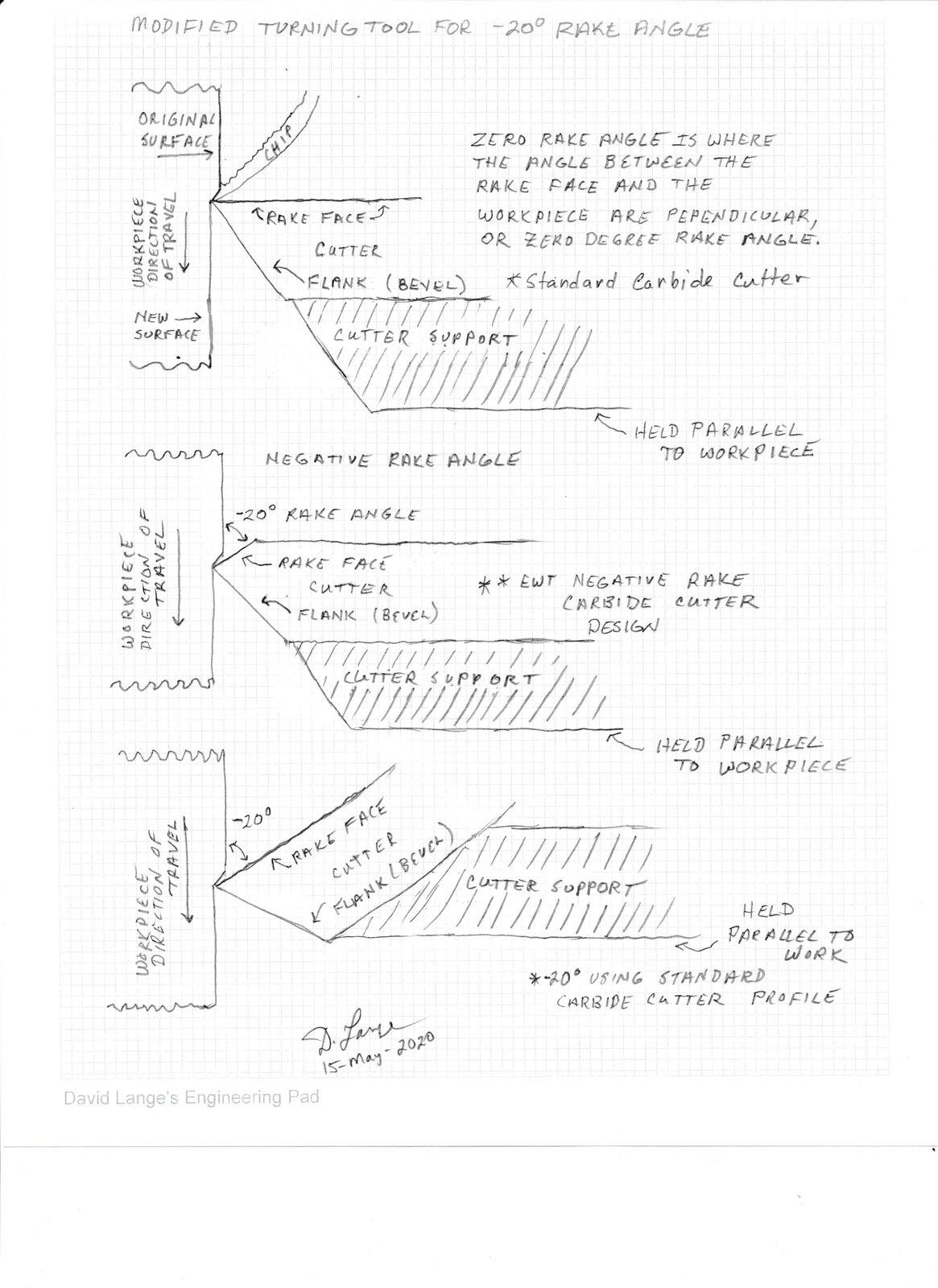

Regarding the subject of negative rake cutters and comments already posted from others, the Easy Wood Tools NR (Negative Rake) carbide cutters are patented and trademarked by Easy Wood Tools, so it is unlikely that you will find carbide cutters with the negative rake angle ground into them from anyone other than Easy Wood Tools.

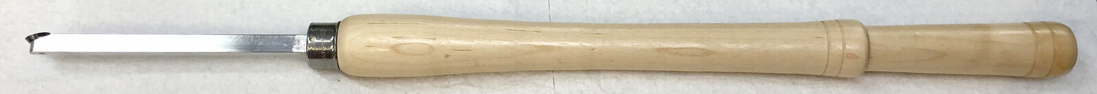

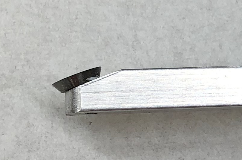

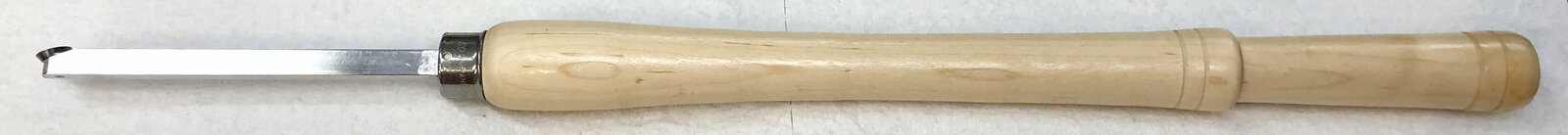

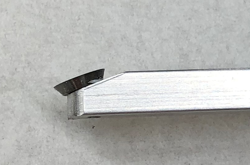

That being said, there are still alternatives. Standard carbide cutters have a neutral or zero rake. Rake is the angle of the tool or cutter relative to its cutting surface. A negative rake is when the face of the cutter slopes away from the cutting edge. The geometry and cutting forces with a negative rake angle makes less aggressive cuts which helps eliminate chatter and chipping of brittle materials. About a year and a half ago I made some tools where the mounting surface for the cutters was ground so that the cutter presented with a negative rake when the tool itself was still held level. So far, for me anyway, they have been working just as well as the Easy Wood Tools NR cutters. I attached a few pictures of one of the tools that I made along with the notes I made when I was doing the related research. (The notes show a standard "flat" cutter and how it presents to the work along with how an Easy Wood Tools NR cutter presents and how my tool with a standard carbide cutter presents.
