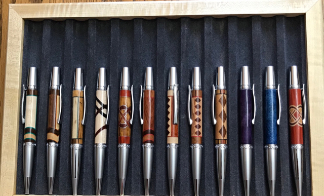

In the attached the purple and blue pens on the right side were dyed with oil paint diluted with DNA, they both sold rather quickly.

Good points. I should have said that I turned to size and then applied the stain, let it dry a week and then did ca over the top.

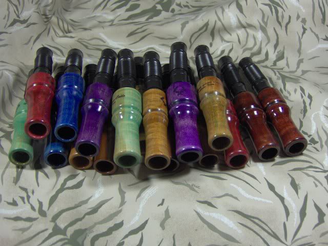

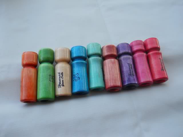

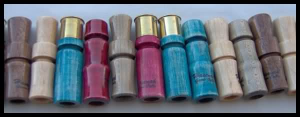

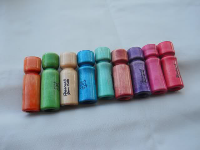

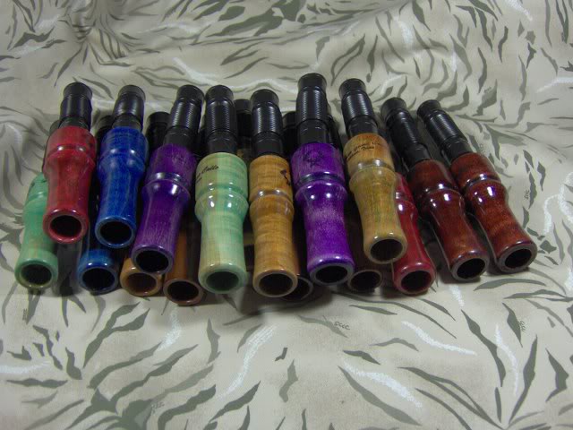

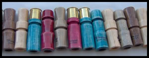

Try a dark stain like black right after you finish turning, even before sanding. Let the stain dry, then sand,, the softer grain will absorb more stain and go deeper into the wood. Then after sanding, use the stain color you want. The darker areas where the stain went deeper will be accented with your second application of the chosen color.
Have a lot of time to waste? Find one of the pipe making forums and read through the old threads about stain and finishing techniques. They work with briar, sort of like burls, where the wood has all kinds of hardness and softness factors. When you think you know enough to be dangerous, find one of the black powder muzzleloader forums and study their dye and finish techniques. Most of that will be chemical "stuff" that can be done to maple to change it's color and accent the grain. But quite a few use the easy route of Fiebings leather dyes., both alcohol and oil based versions.
Have you ever seen a star burst on a guitar? That is also a stain technique. Hard to accomplish on a pen, but it has possibilities. Think of member Bob in SF and some of his high end art. You can take plain maple blanks, that cost about 20 cents and make them into million dollar pieces of art. That hand full of calls I posted above, at Christmas time they would sell like I was giving them away. Not because they were better, but because they were unique.
