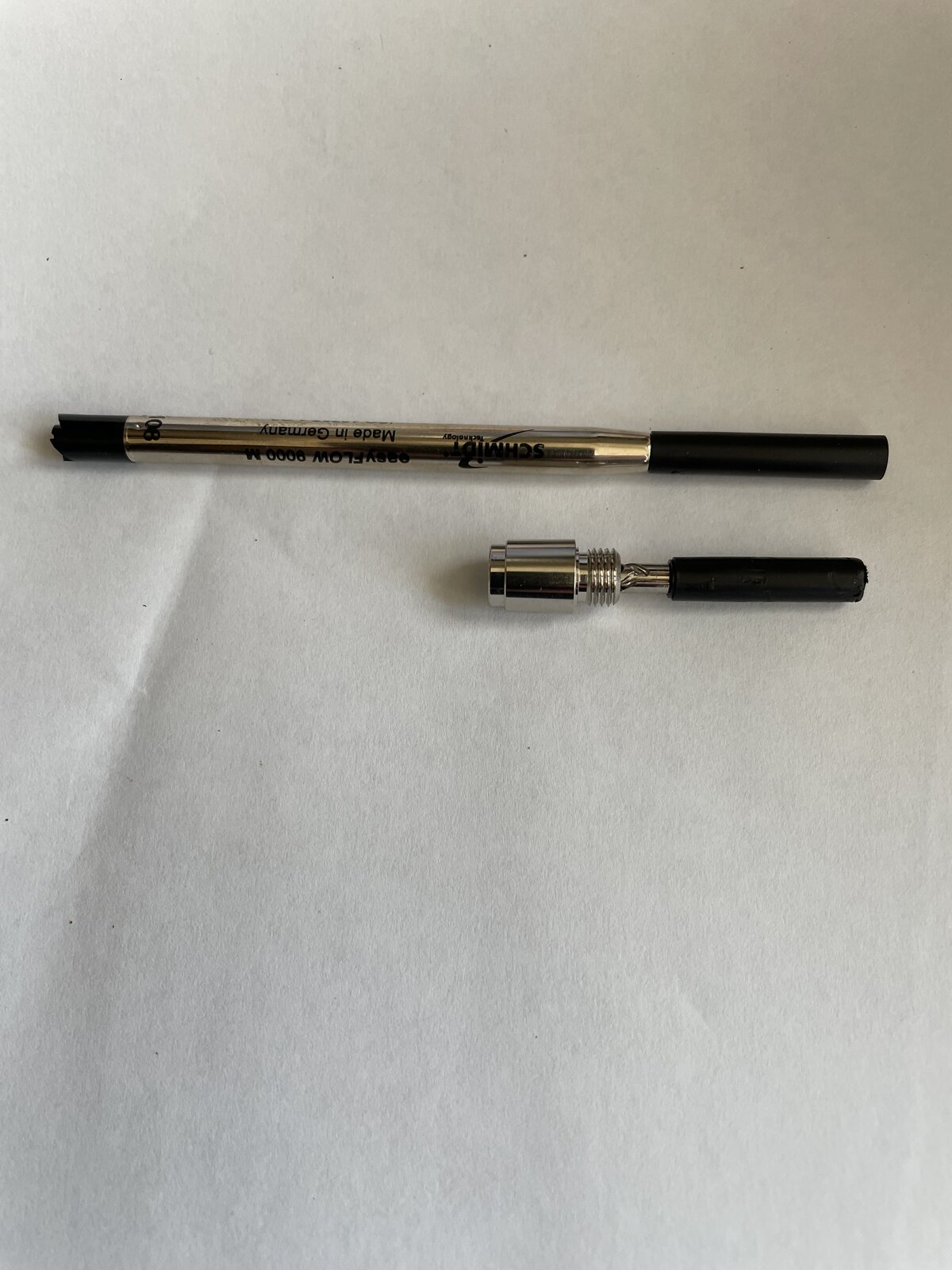

I have made a few of the DuraClick EDC pens and really like the design ......... except for the refill extension. Has anyone found an alternate/equivalent kit that eliminates the refill extension but still has the Schmidt mechanism?
An alternative to the extender.

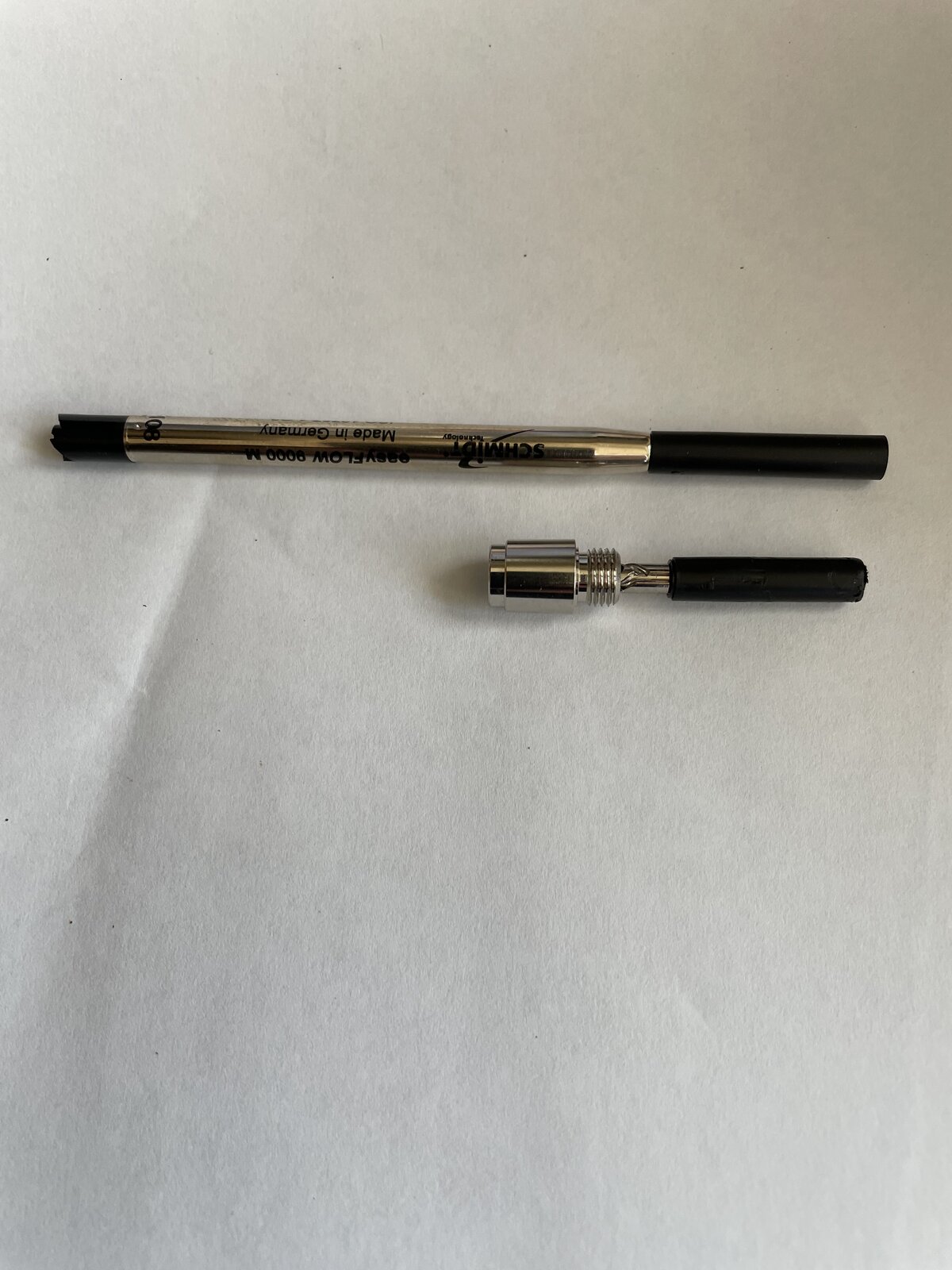

The Schmidt Easyflow 9000 refills from ExoticBlanks come with a black cap, I guess to protect the tip. Simply drill it out to 9/64" and cut it to length, approx. 21mm. Push it all the way onto the clicker until it touches the clip.
