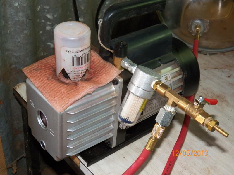

I'm guessing you're using this setup to filter your excessstabilizing liquid before putting it back in the container.

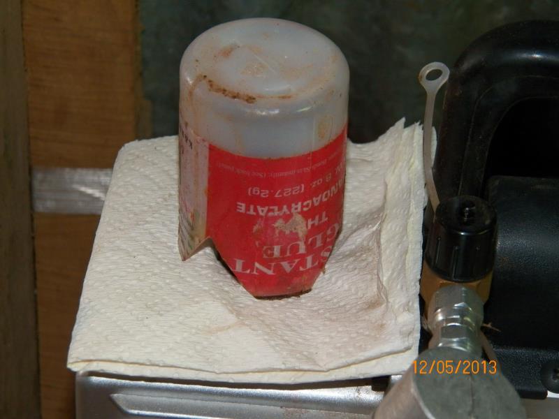

Based on this input, it is a filter you put inside the stabilization chamber to prevent the bubbling liquid generated by the vacuum from entering the vacuum line. The paper towels slide onto the CA bottle to serve as the fluid separator at the top of the chamber since air can pass, but liquid cannot. The CA bottle itself protects the opening from contamination with the v-cuts allowing the vacuum in the chamber.

Very well done Tim'sTurnings (Tim), I was starting to believe, this one would take forever to be answered correctly but, Tim got a bullseye...! congratulations:wink:

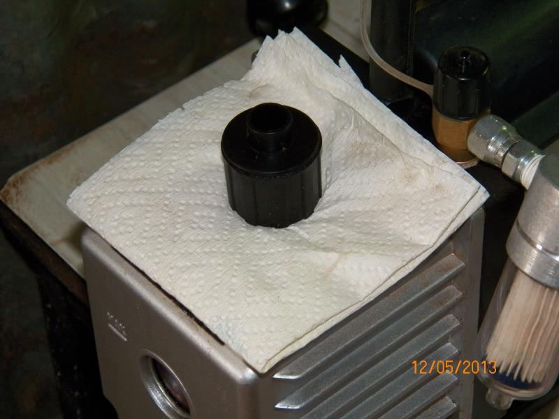

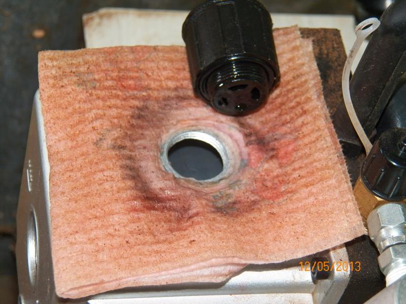

Yes, this is my take to resolve the problem of the oil spray/mist that most vacuum pumps have, very economically, particularly after I priced some oil exhaust filters that are made to solve this problem. Not only they are extremely expensive but they don't last long before they need replacement and that makes the whole thing, even worse.
My pump, and most of the vacuum pumps out there, in the cheap to medium price range do, lose a fair amount of oil from the exhaust at start and then when, opening the valve to let the air out of the chamber, there is when most of the oil mist is repelled from the pump's exhaust, the bigger the vacuum chamber the longer the mist will last so, I got my problem resolved by using this CA/accelerator 8oz empty bottle cut in half and with the 4 V cuts (to allow air circulating) and to "catch" the oil spray from the exhaust, that in turn, hit the top and then runs down to the paper towel for "soaking".

Vacuum pump oils come in many colours, clear is always better (allows easy detection on oil contamination) but, this one is a translucent red, what most Dairy farms used around here for milk extraction pumps.
I also understand that, not all vacuum pumps have the same exhaust configuration as mine and many others, I believe, this principle can be adapted to any vacuum pump that has the oils spray problem...!
There will be (very soon) a few extra pics and info on the issue on my thread The Good, the Bad and the Ugly of "home" wood stabilisation...!

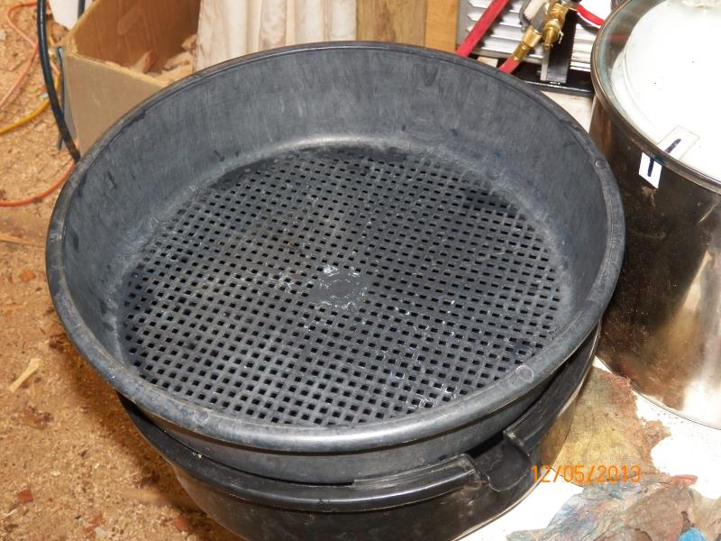

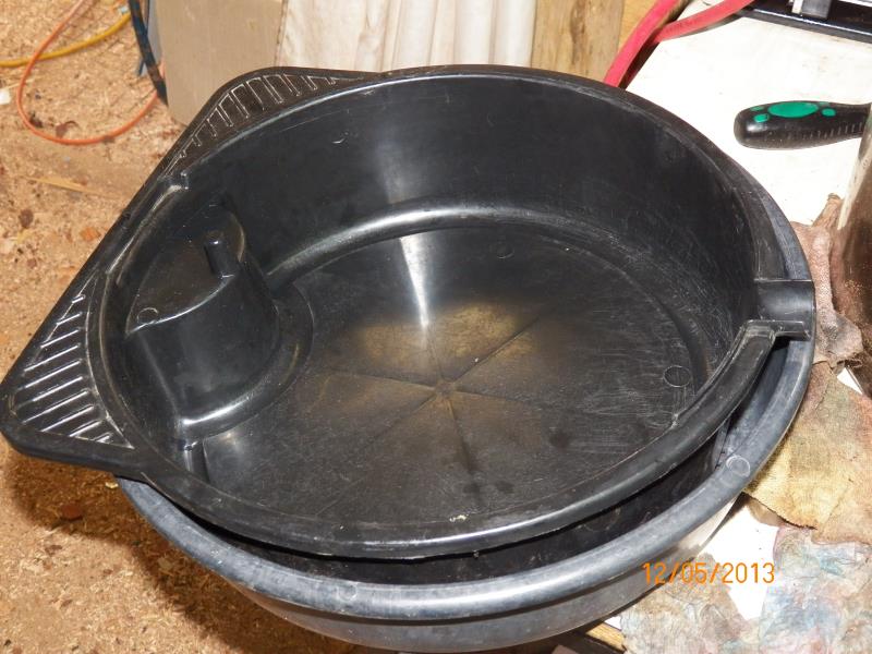

In the next 2 pictures, there are 2 plastic items, what are the 2 "main" purposes they were made for and, what do I use them for...????

I also believe they are for changing oil on a vehicle, you use them to drain excess liquids off your materials during stabilizing.
A little further on JDenis,
You put your blanks in the sieve and lower them into the oil pan which you have filled with turps or metho or something, let them soak and then drain when ready.
Being an oil pan with a pouring spout you can either recycle or dispose of your fluid as desired.

Oh mate, you are almost there, you've got 2 out of 3 and while you run the risk of giving the advantage to someone else by getting this far, there is only 1 more correct answer that has to be given, to get the prize.
The correct answer are as per the below order;
*- What are the 2 plastic items, "originally" made for...???
Item 1- Vehicle oil change pan.
Item 2- ...????????
*- What do I use them for...???
- Drain the Cactus Juice from the just stabilized blanks/wood.
This is all I'm going to say...!:wink::biggrin:

The sieve is for cleaning engine parts or from a worm farm.

oil change pan probably for a riding mower or some other small engine; holder rack for steaming vegitables in a round pot, Used by you for draining items placed in the seive and the drain off is caught in the pan.
I'll guess that the perforated pan is intended to be part of a plant stand... To allow excess moisture to drain away. The oil change pan and your purpose for them has already been identified.

You use the sieve to separate the juice from the grapes , which you mash barefooted. That enhances fermentation , leaving a product which is an effective antidote to the stress and pain caused by your failed experiments .
Wow, I can not believe that no one have got it right, yet...!:eek:
This item comes as part (accessory) of a much bigger item, normally made also of plastic, something that has to do with certain types of weather...!:wink::biggrin:

Screen out of the top of a poly rain water tank
