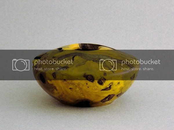

It is definately turnable if you find a big enough piece. I have made a couple pens and a nice hollowform from it.
Dario, you have to drill the center out right away. I actually drill it out and then immediately drop it in DNA for a few days. have not had any split where I did that.
Here is the hollowform:
And here is a pen:

The pic of the hollow form Curtis showed is MUCH MUCH better in person. [^]
