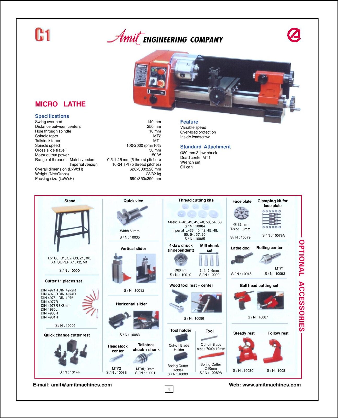

I am from India and new to Pen Turning. I am in a serious dilemma and would very much appreciate some advice. The problem is I am not able to find a proper lathe in India. I found a few options but I am confused on what to buy. My requirements are for pen turning only. I have listed my options below. All price excluding taxes and transportation to my state.
1. Jet JWL 1220L model. Its costing me around 641 USD.
2. Axminister AC240WL. Its costing me around 617 USD

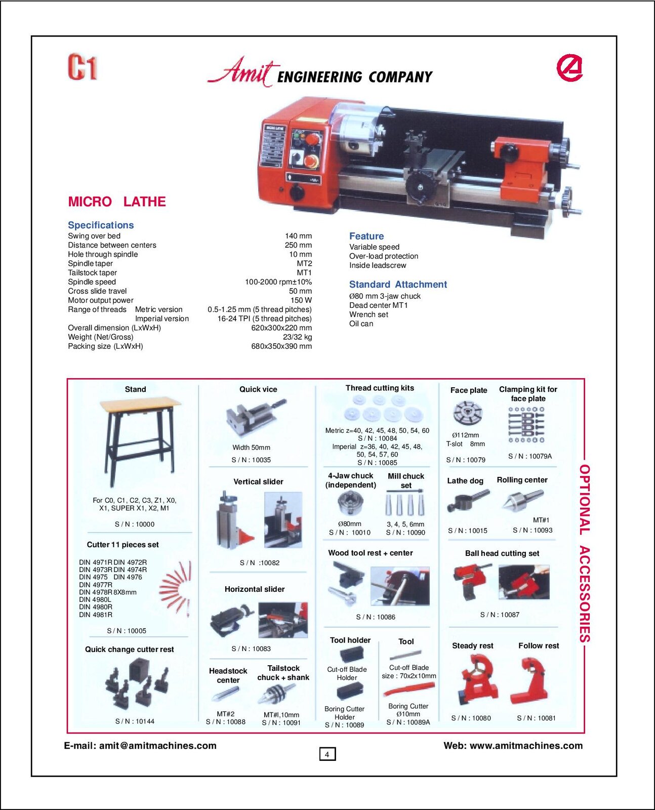

3. A metal mini lathe and that's costing me around 664 USD (Spec sheet attached)
Now which one shall I take. If I buy the wood lathe I might have to invest in the chuck and other add taps and dies to make a pen. But with the metal lathe I can use the same to put threads also(Correct me if I am wrong). Please advice on which one will shall I go for.

the Jet is the best value you have listed. Its a bit larger than the other two, so space might be a consideration. In my opinion start penturning on a wood lathe, if you still enjoy it and want to expand your craft then switch to or add a metal lathe. The metal lathe that you listed here is pretty small and would probably be challenging to work with even with pens.

My advice (maybe I am biassed) is to go for a metal lathe at the beginning since I get the impression you are headed towards kitless fountain pens.
However, the metal lathe that you picture is too small, as Sam pointed out.
You need a metal lathe of minimum size 7 inch x 14 inch, which translates to 180 mm x 360 mm.
If you go any shorter than 14 inch you will be cramped for space to fit in the chucks that you want .... 16 inch long would actually be better.
Don't forget that you need to allow room for a Jacobs chuck for drilling ... mounted in your tailstock.
And you will probably want to upgrade the headstock chuck to 4" x 4 jaw in order to grip blanks which are 3/4" round.
The Sieg lathes (made in China) are very commonly used by the pen-turning community.
They are available with a wide variety of brand names and it should be possible to get them (or suitable equivalent) in India.
It is true that with a metal lathe you can cut threads, but I think your initial thread cutting should be done with tap and die until you develop your skills at using the lathe to cut the threads.

Many people are now doing what you are considering with the metal lathe. But metal lathes are smaller. Make sure you get one long enough to allow for the length of the chucks and live centers or other items AND the length of the pen blank.
The metal lathe you linked has 10". If you need to add a special chuck that is 2.5 to 3", and a different tail stock center, you could easily lose 4 inches of turning space. You would be severely limited for space for the blanks.
A 12 inch metal lathe would be much better.
If you do go with a bigger metal lathe make sure the spindle taper is mt2 like the one you linked. I had to buy a mt3 to mt2 converter which at the time was not easy to find
