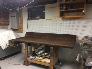

If you are considering using reclaimed framing lumber for building your workbench, I suggest that you take a look at Paul Sellers YouTube channel where he builds a bench entirely from reclaimed lumber using only hand tools. With the power tools that you have in hand you could make quick work of this bench. Granted, it is a bench that is oriented toward hand tool woodworking, but most bench work is, for the most part, hand or small power tool work.
My son and I are building this bench for him right now out of poplar since we didn't have a good source of dry construction lumber--what comes out of the big box store is still way to wet IMHO.

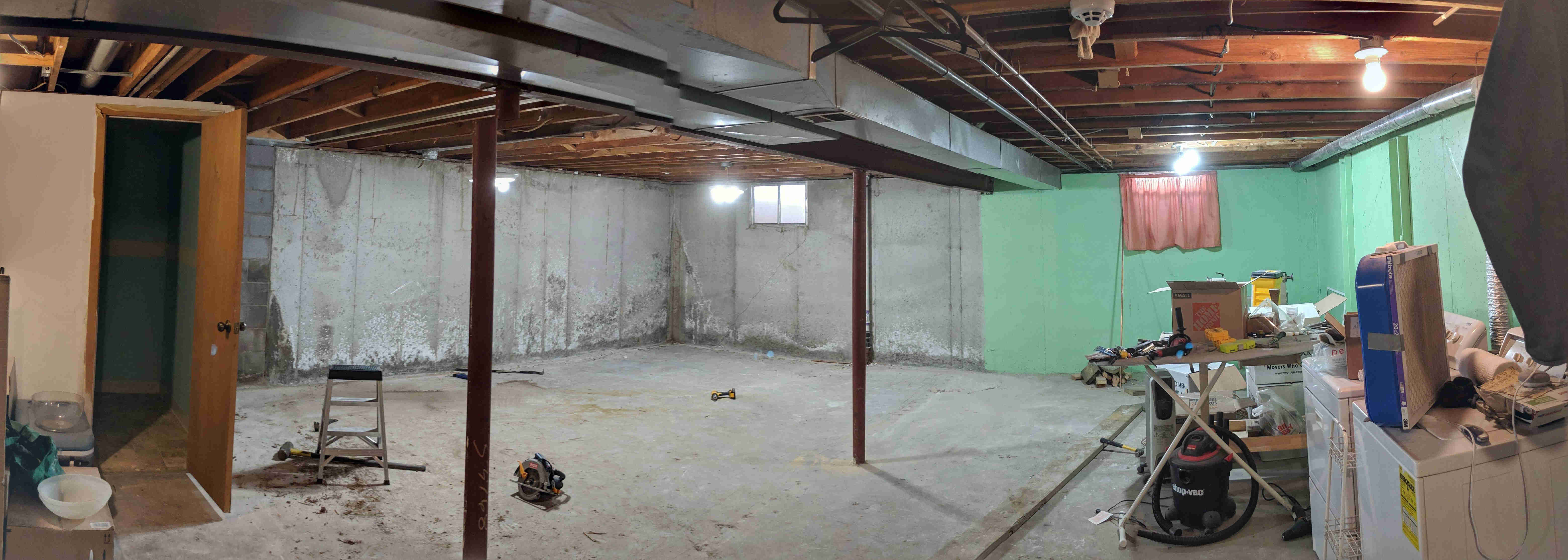

All cleaned out! Foundation work begins tomorrow, then electrical. Final dimensions are 25'x21' with room left over if needed for assembly. Today we ripped out some termite eaten floor joists and replaced them with pressure treated lumber, removed the carpet, and junk. After electrical I'll be painting the walls and ceiling white, then I'll start actually placing my equipment in all the wrong places. :D

Are you putting anything on the walls??? I would not sheet rock a basement ceiling ever. You will need access. I would hang a grid system and insert sheet rock panels if you choose. I used regular tiles. If you are not hanging any ceiling and just painting what is there, then I am out of suggestions for you. You have duct heating so that could present some problems for dust control if you plan to keep entire room open. Believe me dust travels no matter what dust control system you use. You keep saying foundation work, are you planning on blowing a wall out and extending the basement??? If you are painting the bare concrete walls, I recommend using DryLoc paint it is a moisture sealer. You can use the waterbased stuff indoors so less fumes.

Are you putting anything on the walls??? I would not sheet rock a basement ceiling ever. You will need access. ... You keep saying foundation work, are you planning on blowing a wall out and extending the basement?
Nothing but white paint on the walls and ceiling. The foundation work is repair only. Two of the walls have moved in a few inches, so they are pulling them back to flush and piering, which is common in the area due to the clay soils native to Missouri.

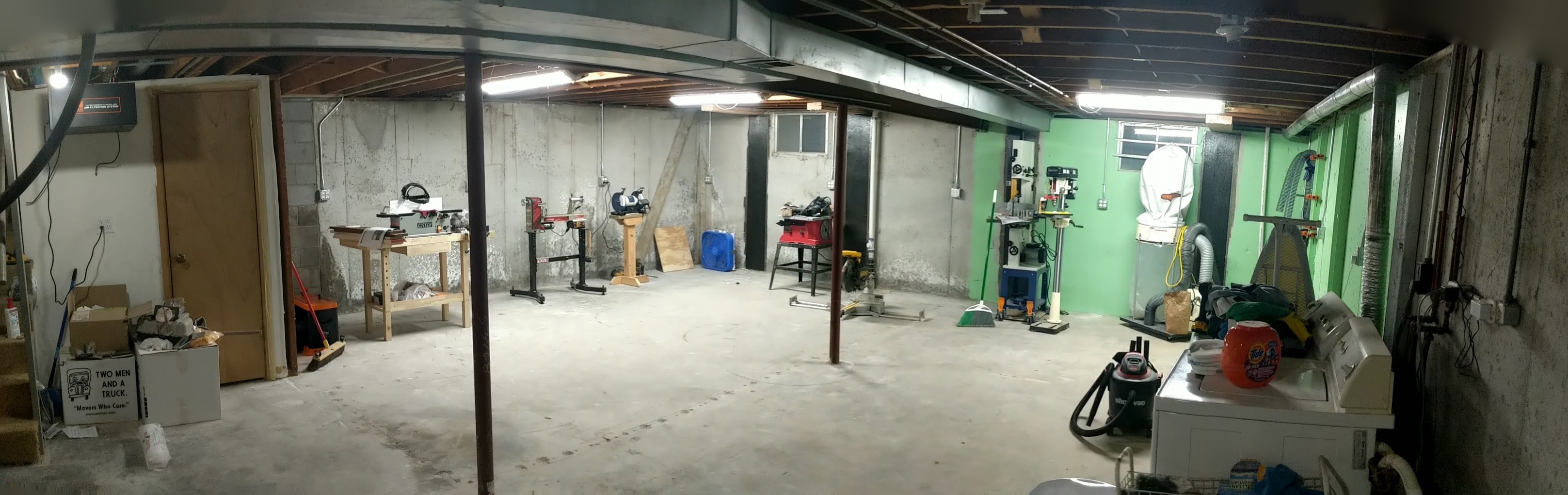

Electrical work is almost completed. I've got the big pieces of equipment set up, but still have a few benchtop tools that I need to get set up. Once I get it cleaned up, I'll post another shot. I still have a lot of work to make the space functional, but all my outlets are wired and have power now. I can't wait to complete the other home renovation work I'm doing so I can get into my shop making things.

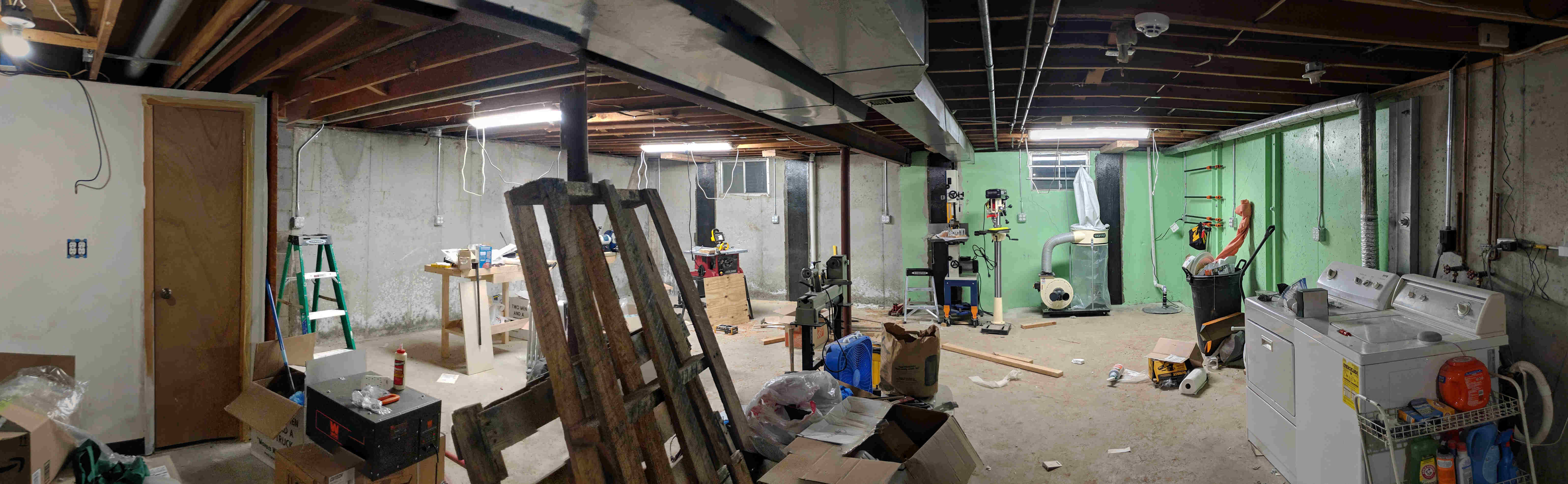

Well, I finally got all the home renovations done and got back to working on the shop. I'm finally ready to at least start making pens again. I hope to turn out a few over the next couple of days. I'm missing all sorts of stuff, like cabinets, a workbench or two, tool organization, etc... All in good time. I'm already scheming on where to add additional power, I have plenty, but none in the middle of the room. I already plan to run some power to the support poles. Anyway, thank you everyone for the advice.
