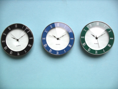

http://www.megaquartz.co.uk/contents/media/l_45mm facet.jpg
