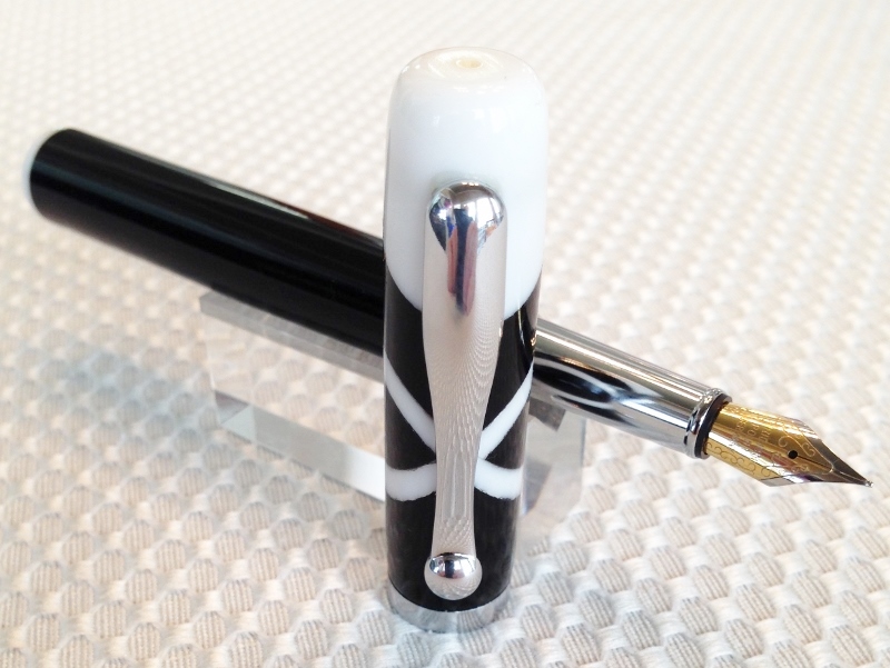

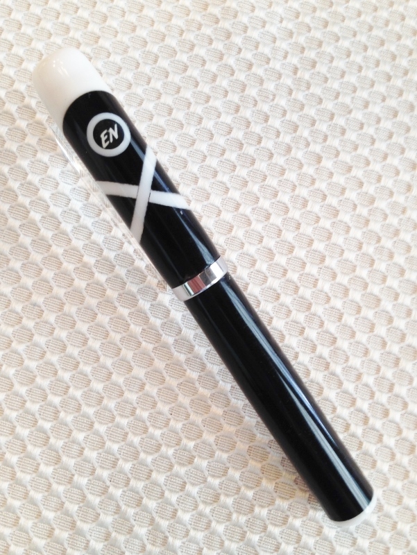

Entry 1
Statement:
After viewing high end executive pens by key manufacturers I came up with this design for an executive pen:
Kit: Atrex - Removed the end caps, retained the clip, center band and internals.
Pen body -- Black acrylic segmented with white acrylic.
Design features:
Closed ends -- very smooth, feels good in the hand, high end look
Multi blank segmenting -- unique, generates interest
Hidden clip -- adds a bit of magic
Cast and framed initial window -- Key focal point, one of a kind, personalized for owner (who retains bragging rights). Just plain fun!

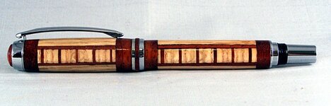

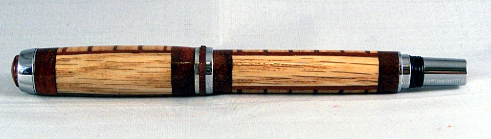

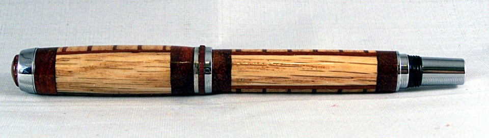

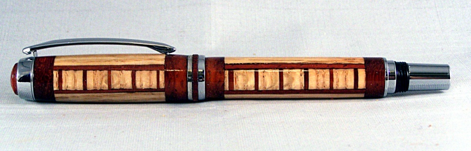

Entry 2
This is a Smitty Caballero rollerball. I created the blank using oak and padauk. I removed the stock black finial and the black center band accent and replaced them both with a piece of padauk.

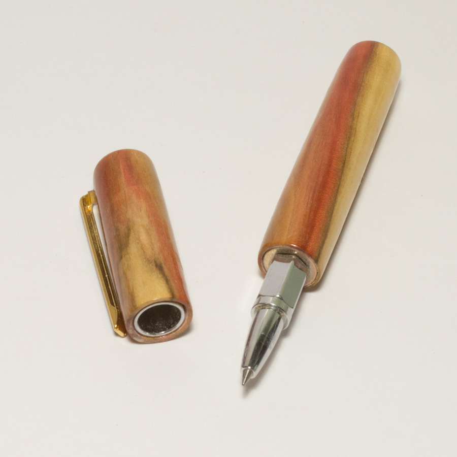

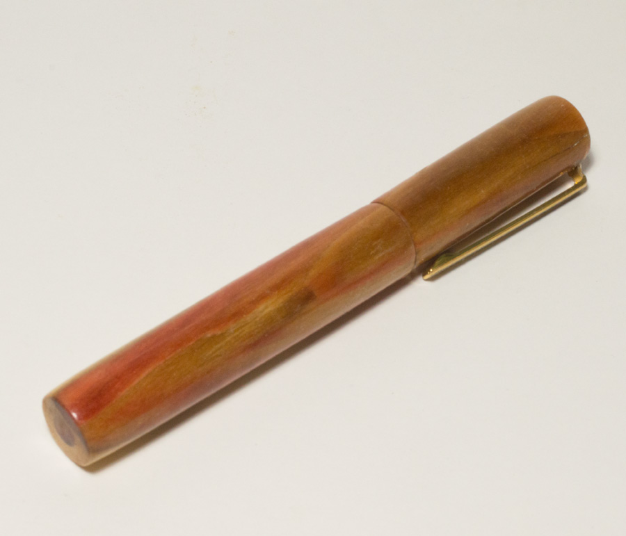

Entry 3
Long description:
Started with a nice 3/4x3/4x5" blank of Stabilized Flame Boxelder, and a PSI Vertex Rollerball kit. Turned the centerband/ring-magnet portion of the kit down, removing the centerband portion and leaving the ring magnet and nib housing tube intact and full length.
Drilled the blank with several diameters at different portions:
First a 1/4" pilot/mandrel hole was drilled through the length of the blank, before cutting. Cut into cap/body sections with narrow-kerf bandsaw blade to leave minimum interruption of grain pattern.
Cap drilled 9/32 to depth of 1 1/2", 15/32 to depth of 7/8". A 5/8" section of 8mm tube was flared to allow nib to fit and glued into 'top' of cap (9/32 portion). Turned-down centerband/magnet was glued into 'bottom' of cap, seated flush. Nib thus passes through magnet into protective tube in cap.
Body drilled 8mm to depth of 2 3/4", 10.5mm to depth of 1/2", 33/64" to depth of 3/16". A 2" section of 8mm tube was glued into bottom of body. Coupler ring from Vertex kit was pressed into a 1/2" section of 10.5mm tube and glued flush (inset) into top of blank body.
THEN the blank was turned on a mandrel. A "homemade" bushing was used to fill the centerband/magnet nib opening in the cap and the coupling opening in the body, to hold the blank halves in the same alignment as when the nib is seated. Blank was turned "straight" with very slight rounding at ends. Slimline clip added using "invisible clip" method found in IAP library!
(I tried to turn an earlier attempt between centers, but with no center band to hide slight imperfections, concentricity was not perfect - turning the cap gave a 'gap' or 'bulge' around the center at various positions. Using the mandrel/bushing approach let me rotate the cap periodically while turning and improved concentricity.)
Finish is standard CA. Openings at ends for mandrel were filled with Flame Boxelder plugs before finishing ends.

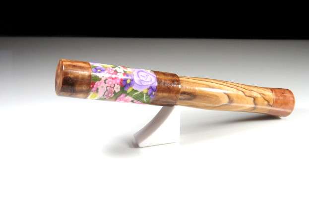

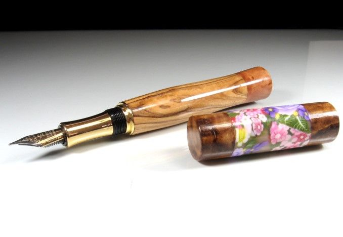

Entry 4
This is Sn. gentleman fountain pen kit
Polymer clay flowers on Myrtle wood burl and Olive wood
working on metal lhathe

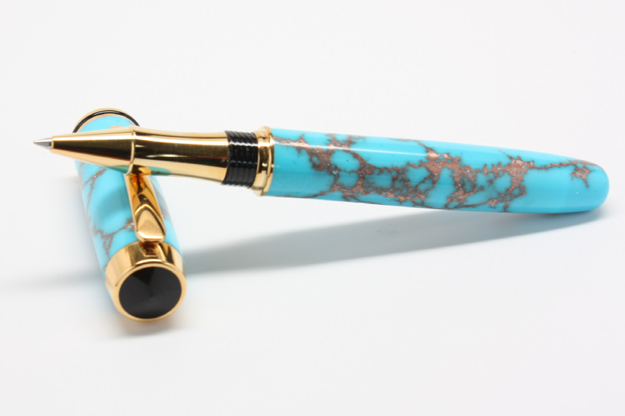

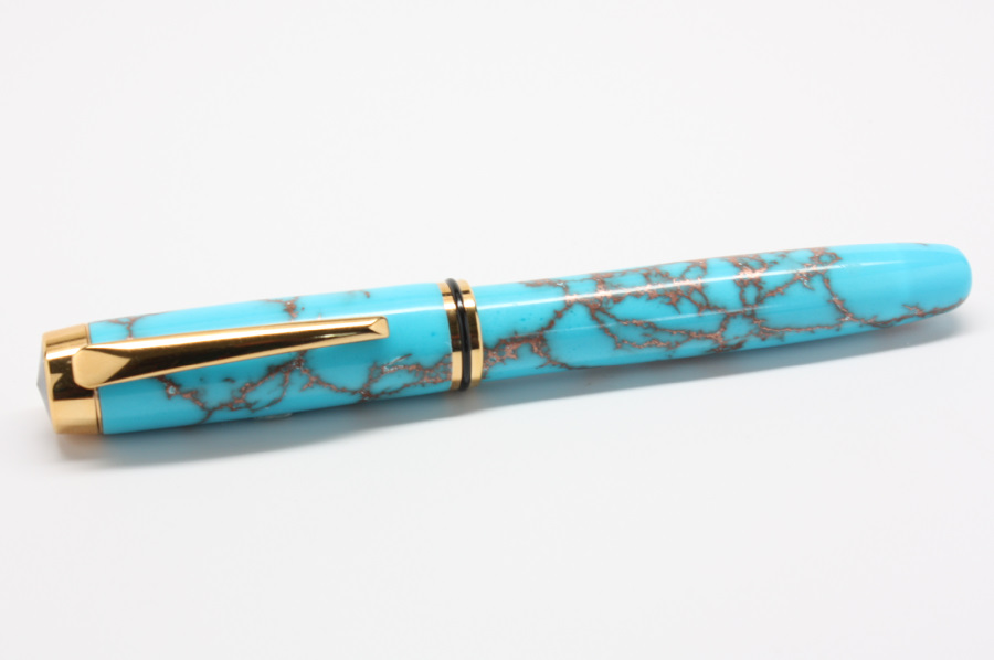

Entry 6
It is a full sized Gentlemen's from CSUSA. The blank is a Turquoise Trustone. I omitted the post for a closed end.

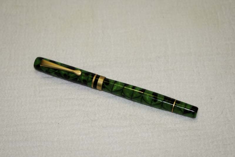

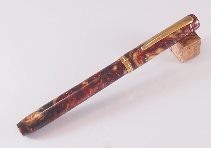

Entry 7
The pen is a Berea Flat Top American fountain pen kit with a Mutagenic blank.
I incorporated the top finial into the cap and turned a custom one for the bottom. The clip is epoxied into the hole in the top that was drilled on the lathe using a tiny dremel grinding bit. I wanted a brass ring look at the end of the pen so I turned off the threads for the bottom cap making it non-postable. I had to turn the bottom piece on a metal lathe to get it to drill and turn concentric. This was a lot more work than I expected but I learned a bunch.

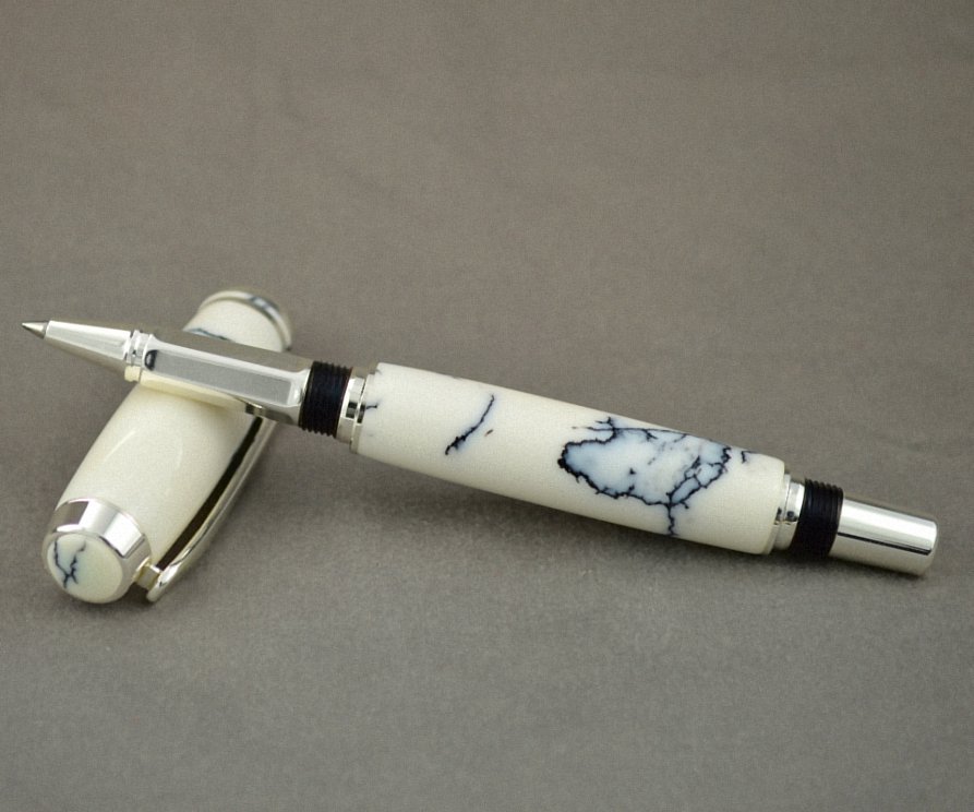

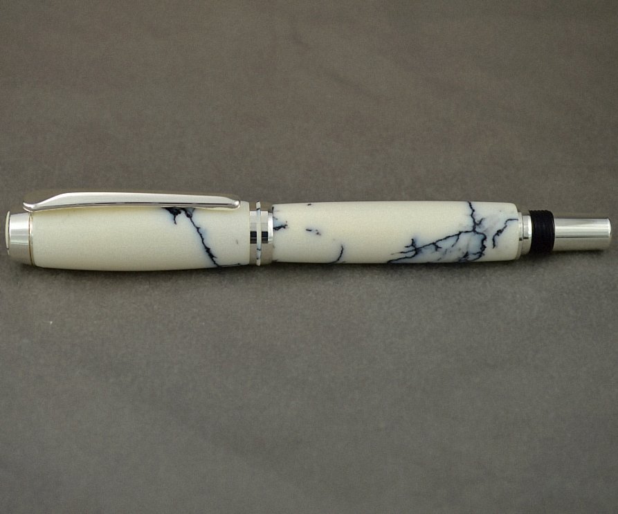

Entry 8
I used a silver Baron and a white marble Tru-Stone blank for materials. I kept the modifications simple. I replaced the finial button with a piece turned from the offcut from the blank. I also replaced the decorative center ring on the center band with a ring turned from the offcut from the blank.
