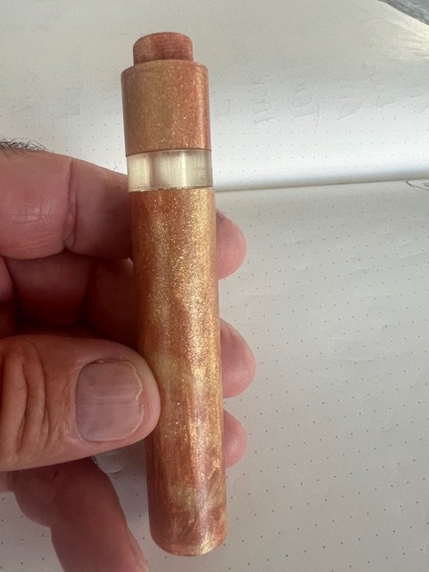

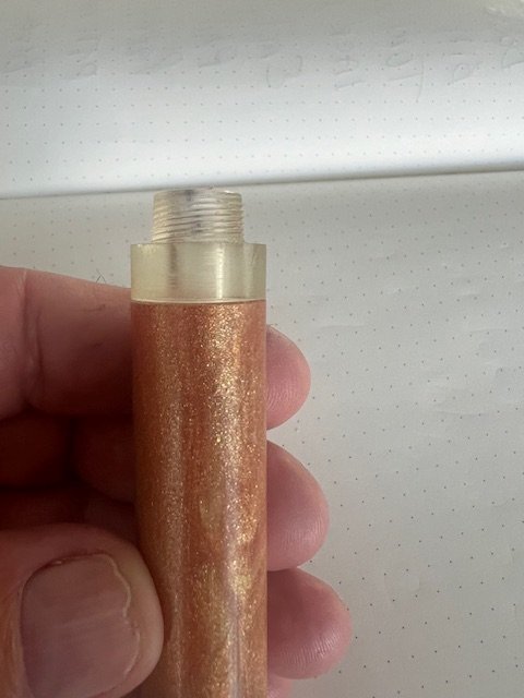

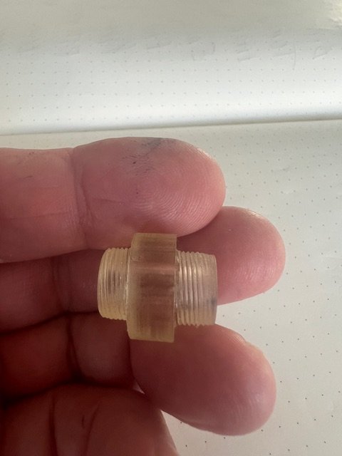

Following up on this - I took a 3/4 piece of alumilite and made a sample ink window for testing. I did M13 x .8 threads on tenons on both sides with the clear window area in the center. I threaded the body to fit the window in and am thinking through the section side.
As I am working this through, I was thinking it might be better to put a smaller tenon on each side to give me some wiggle room with turning. I bought the 12 x .8 in the last group buy. Not sure if this will work. Anyone making ink windows for their pens using tenons and if so, what size did you use? I plan on adding epoxy glue to the threads and making this a permanent piece then turning it to size.
Kevin
