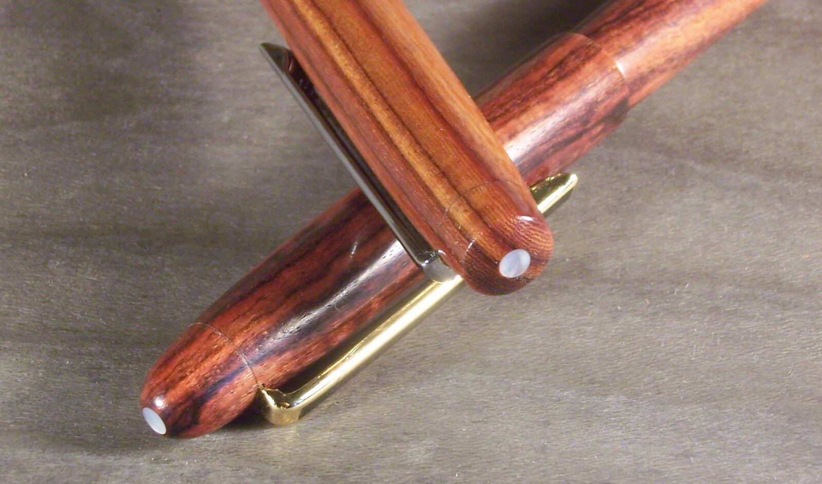

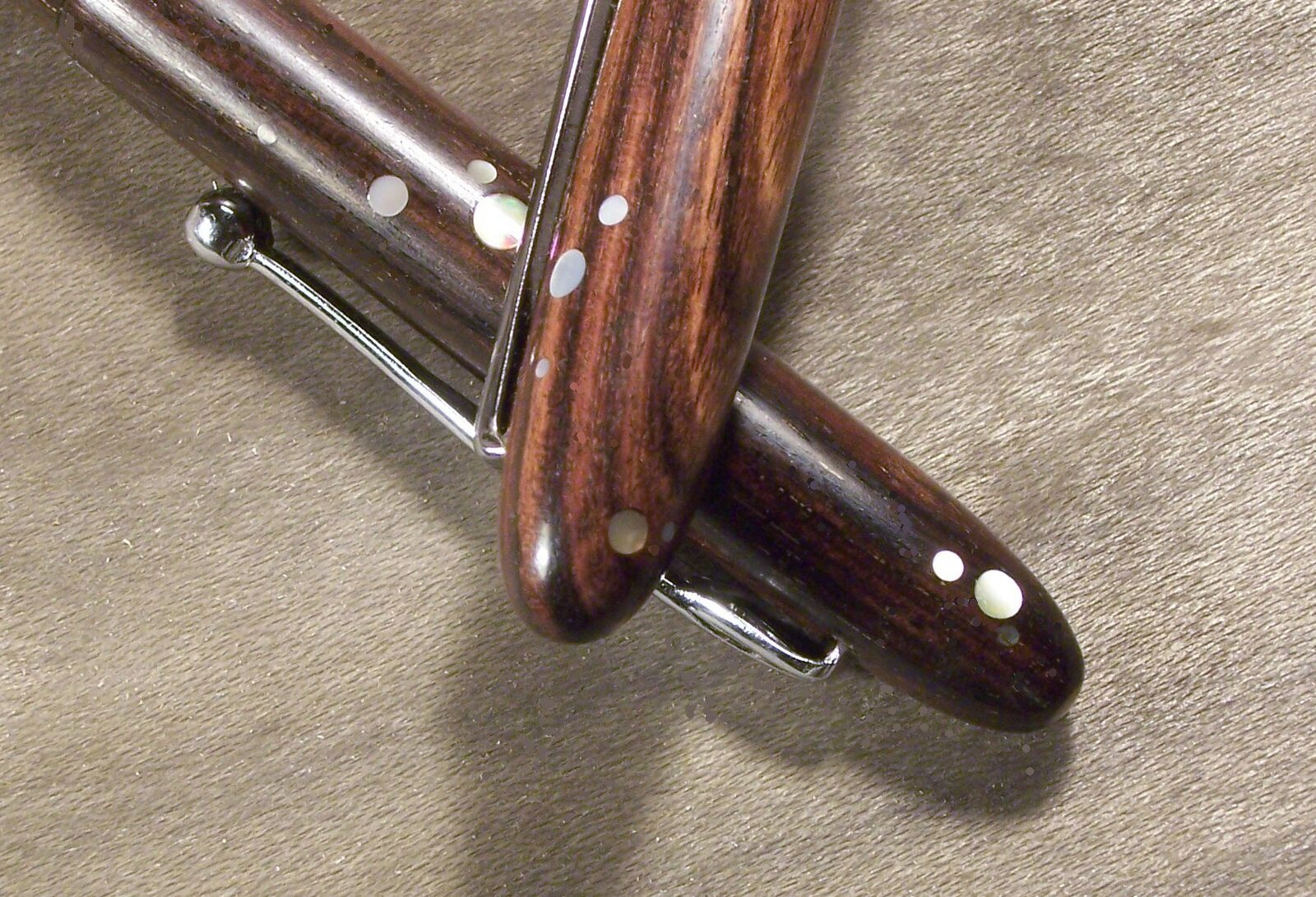

If you use the post and thread technique, you will always have a seam :
My solution is to dig a hole as explained here and glue the clip ring. Epoxy (a lot of it) is extremely strong, especially with a small piece of wood inside to compress everything :

Pierre- these are both really nice, but I see your comment on the seam. Could you check your link - it's not working - because I like your seamless pen very much. Thank you!
