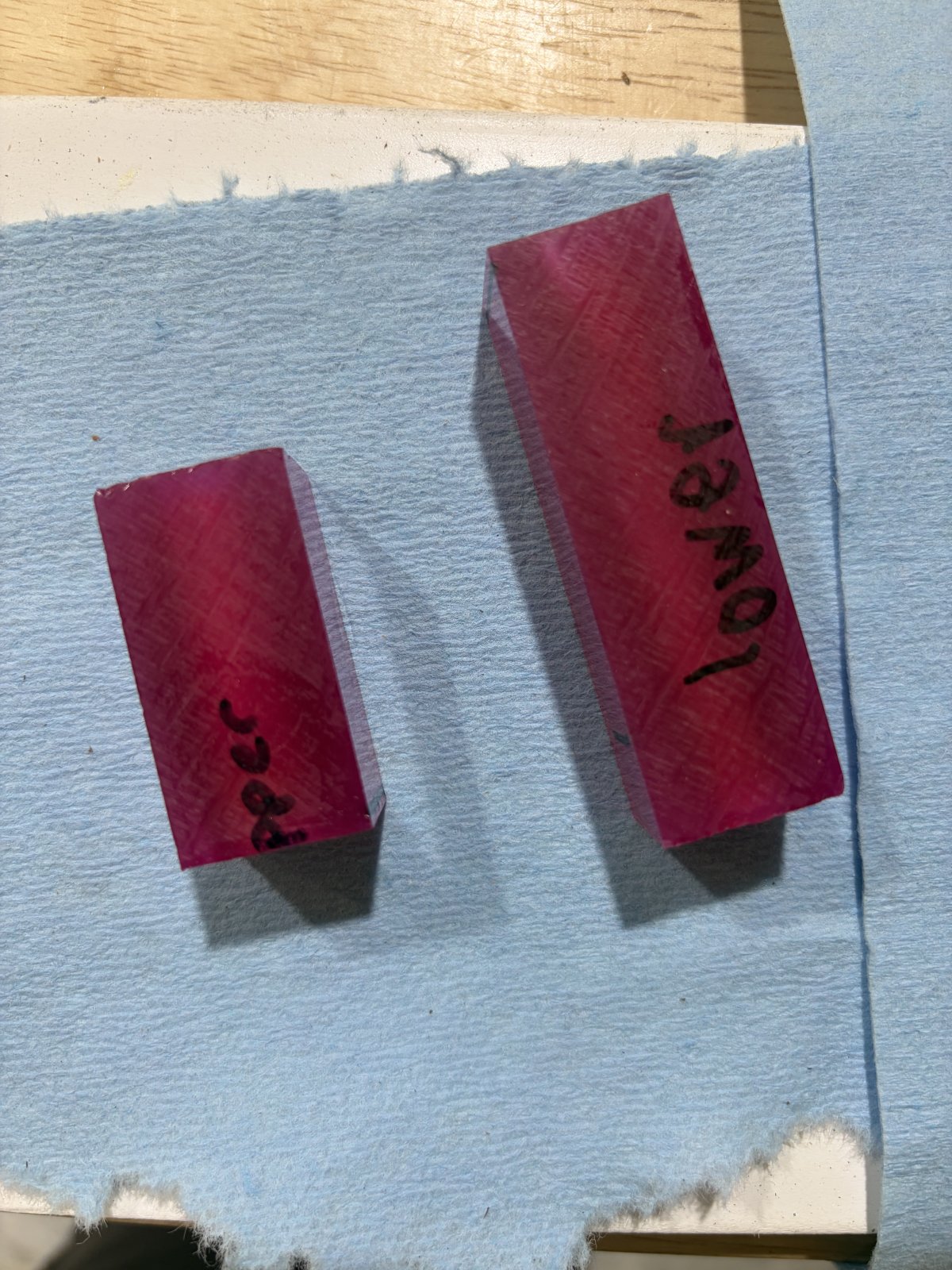

We are trying to make a Princess pen for my wife and after epoxying the brass tubes in I realized they will be visible. Do I need to paint tubes or is there something that will work for this pink color?

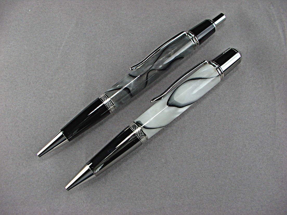

Now choice of color of paint will have an effect on the color of the blank. White will make it very light. red will make it very dark. A pink will between colors and should work well. Here is an example of color differences. Both white and black colors are within the blank. Painting the blank white makes it look light as with painting black it darkens it. Same blank 2 different looks. Just to give you an example of what people are saying here. Good luck.
That's a great illustration JT.
I'd never have thought it could make so drastic a difference , live and learn 👍

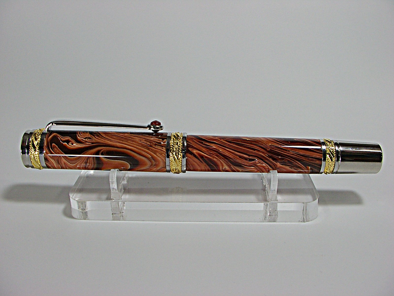

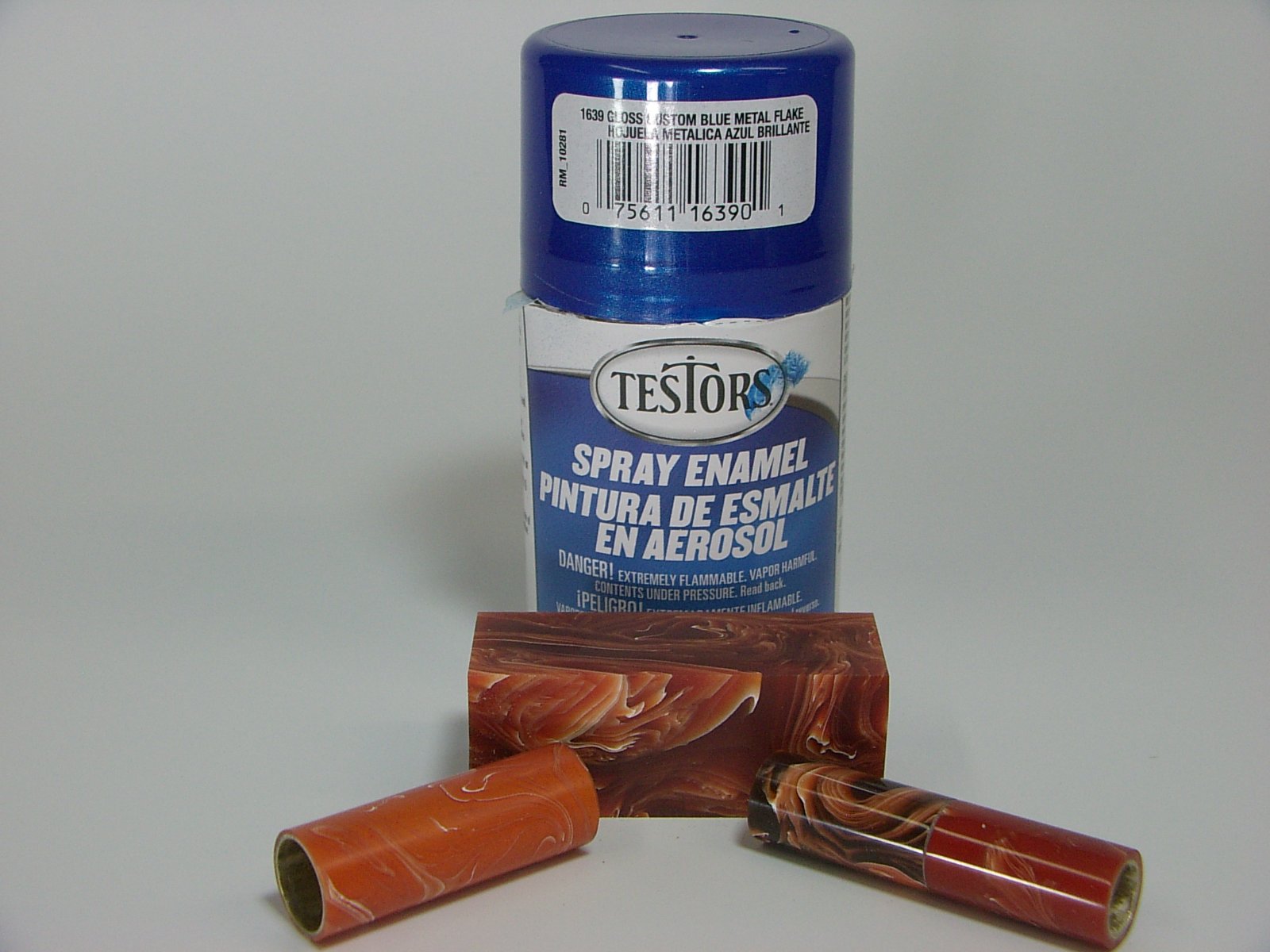

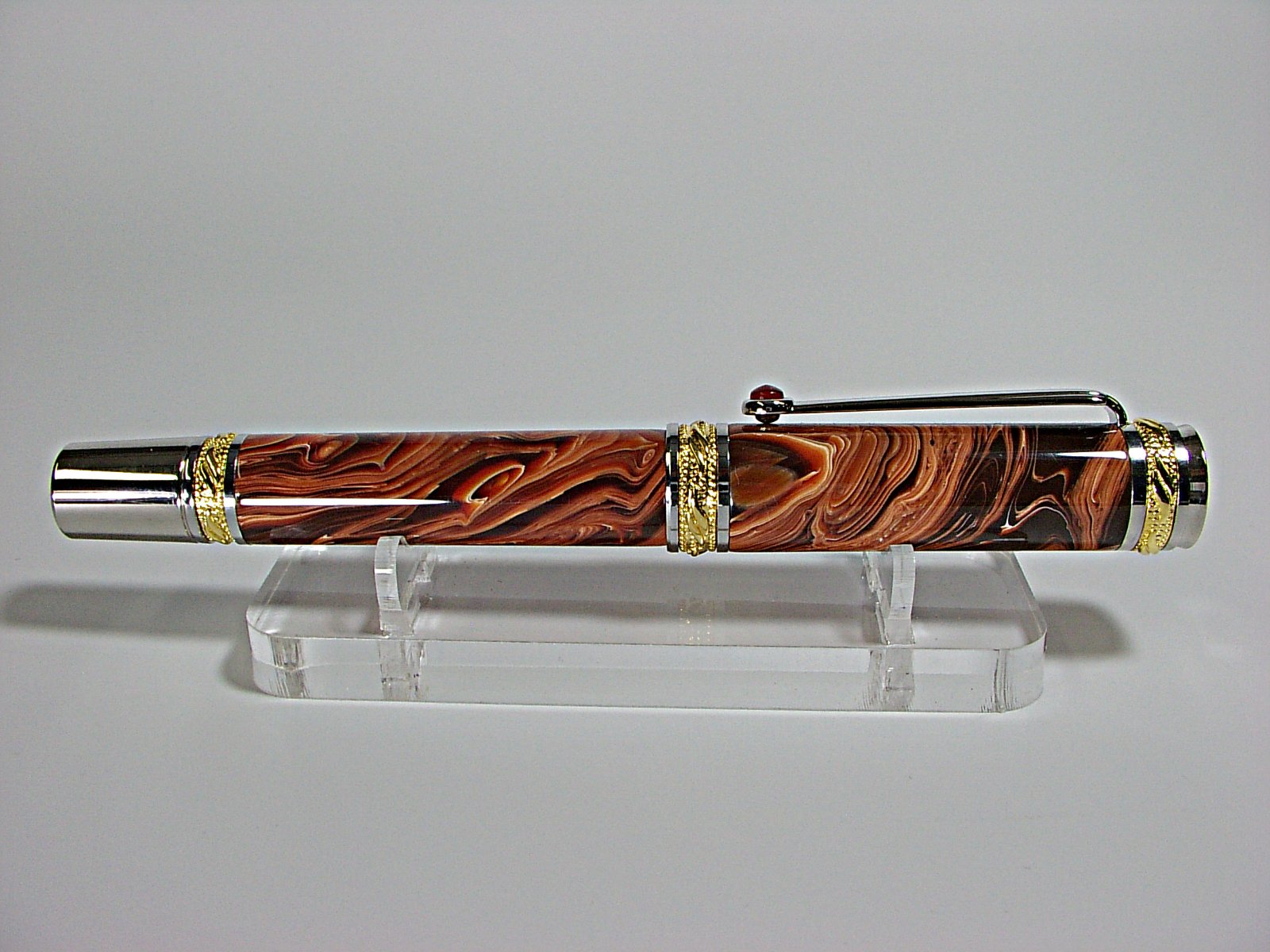

I have shown this example here too a few times. Do not be afraid to try various colors because it can surprise you. In this example, this is Mexican Agatate Trustone. The sample on the left is white. The other sample is red on the bottom and then the blue metallic on top. Turns out the blue brought all colors in the blank out the best in my opinion. There has been threads on this kind of stuff here that you can search for. The trick I picked up over the years here was to make a painting sample dowel with various colored paints on it. Before I install a tube in the finished blank I would push that stick through it and see which color would highlight the blank the best. You can use just a sample portion of the blank you are using and turn it down thin enough to where it really shows the grain patterns. Many times a blank looks so different when it has been turned down from original thickness and it can actually turn away some of the pattern you thought was in the blank. That comes from casting deeply and mixing of the colors. happens to many brands of blanks. Good luck. Have fun.
