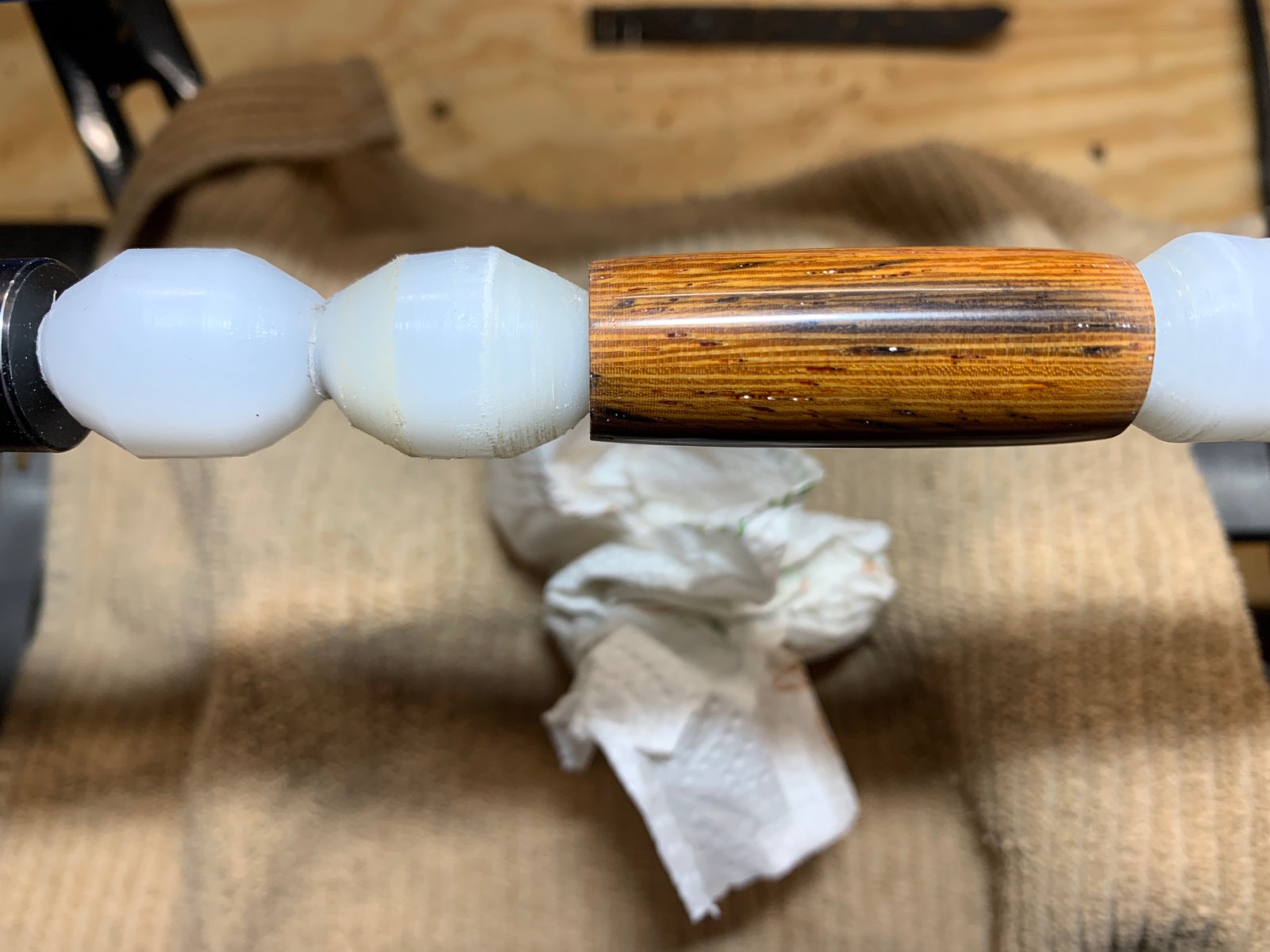

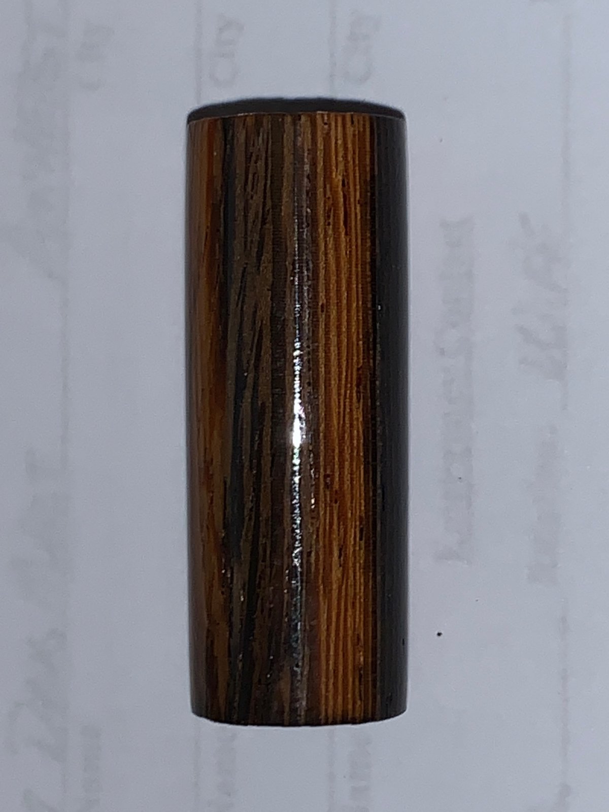

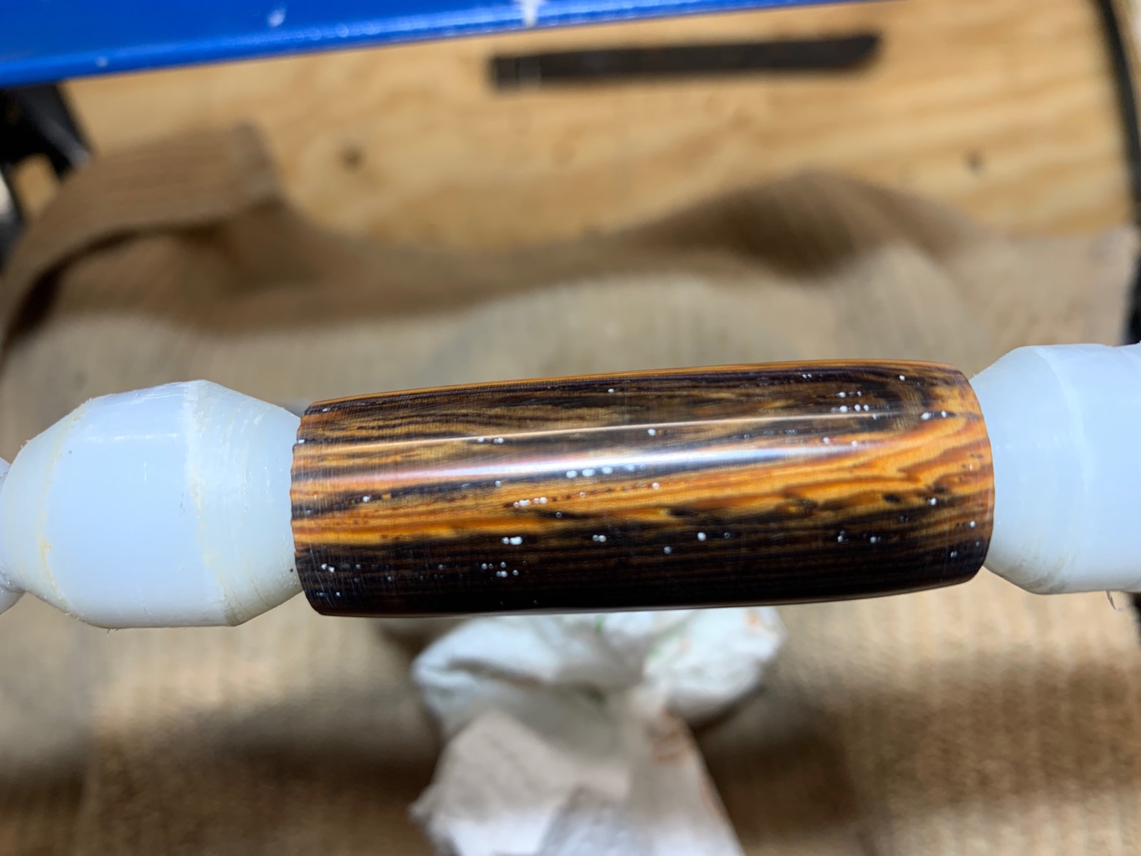

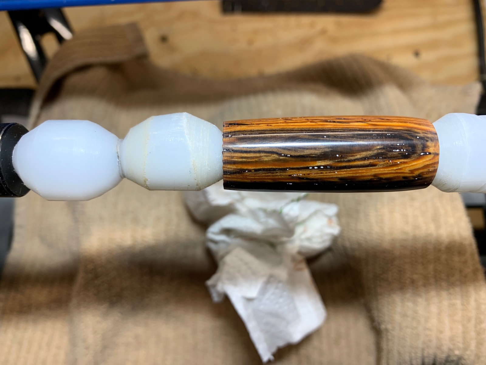

Gentlemen. First of all, thank you for your input on my issue. I decided to do a basic blank and use basic processes on some Wenge. This is what I did. After turning down to round, I inspected the blank for pits, crevices and indentions or tear-out. I observed some of each of those and proceeded to sand using 320/400/600 sand paper taking care to sand with grain after each use. I also cleaned with DNA between each grit. After getting the blank smooth to touch I inspected again after I cleaned with DNA. I saw that the sanding did not eliminate the issues I saw before sanding. I applied 5 coats of Thin CA. I the applied 12 coats of Med. CA. I looked after each application for inclusions and paid particular attention to those areas to make sure I concentrated to try and fill with the med CA prior to sanding. After my 12th coat, I believed that I had taken care of any of those. I next started to sand using 400 grit making sure (or thought I did) the entire blank was hazy from using the sandpaper. When I cleaned the blank, this is what I got.
My question is this. When I applied the Med CA, did I not use enough to build it up. Using 12 coats, I thought , would be enough, but apparently not. I did try and sand down to the spots, but have yet to reach them.
Appreciate more help and input.

Not quite sure what the white spots are. I do know that after applying all my coats of CA, that I go to mm starting at about 6,000. I never go back using sandpaper harsher than what I ended with. The 400 may be digging into your CA. Remember that after applying ca, you now have a plastic finish. If there are any porous spots on the blank, you may be forcing the ca into those holes using 400 grit.
I have heard of people using a water mist as an accelerator substitute. I have also done an experiment using an exhaled breath to set the CA. In most cases these result in "blooming" which is not what we want for finishing and I think this what you are experiencing. The following is from the Resinlab website.

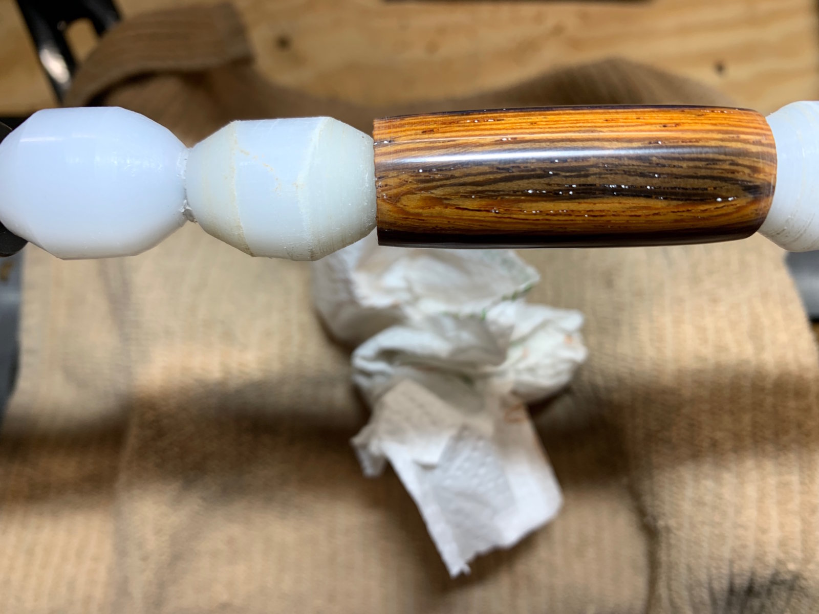

Good possibility of that. Never thought of it that way. I used your process as outlined above, and guess what. Positive results. I re-finish a cocobolo and a zebrawood trimline I did last evening. Originally finished with Pens Plus. Now finished with CA using your recipe and they now look great. Thanks for the help. (1st attempt at your recipe attached)
I appreciate all the input and will continue to try other systems offered. I don't want to muddy the water by mixing and matching some suggestions. I will try other ways and report on the progress. I sincerely appreciate all of your help as I want to be the best I can be in this. Thanks again.

The only time I have had similar issues as the white spots is when it was raining. I work on my lathe with the garage door open and I have learned to not even try and use a CA finish when it is raining, which fortunately for me, is rare here in So Cal. Not sure what your weather situation is, but just wanted to add one other variable that I have experienced.
Thanks John. Rain in SoCal.....no way. I lived there also and know that is infrequent to get rain except for this time of year. As a matter of fact, I ran a company in LaMirada until 2000. On Firestone Blvd. Thanks for the response. Tim
Regarding substituting denatured alcohol with acetone to get rid of water, acetone will also have water in it, and any acetone in a container will fairly quickly absorb water from the atmosphere. Only a solvent like terpentine or mineral spirits would have very little water in it, although I don't know if these would work for cleaning the blank before applying CA.

Agree with John T above. Do NOT sand between coats of thin when sealing. Sanding dust will get into the pores. Come back with medium or thick to fill in the pores. This is where I tend to disagree with the regular method of applying CA. You have already applied medium CA in numerous coats over the thin and still have open pores. The reason for that is that the paper towel is absorbing far more CA than is getting onto and into the pores.
As mentioned above, use foam or plastic baggies to apply the medium CA until it fills in and covers the pores.
Three Suggestions:
1. Understanding CA Application Medium i.e. Paper towels vs foam, bags etc.: Estimation of application pressure is HIGHLY SUBJECTIVE. Many recommend Paper towel and some do not. So which is it? WHY? . . . What is NOT understood - is the difference in people. We all assume that we are the standard or that we all are like everyone else because the application of CA is not dependent upon the individual. WRONG. What one person thinks is "light pressure" to another is "heavy pressure". Light pressure in applying CA will allow more to get onto the blank, while heavy pressure will force most of the CA into the paper towel and less onto the blank.
A 175 lb pipe fitter or farmer or plumber or construction person will call "heavy pressure" as "light". A 225 lb accountant will say that he is applying heavy pressure in applying the CA with paper towel when in fact it might be light pressure as judged by most. On another woodworking forum about 10 -12 years ago I was taken aback by one fellows comment that the black hand spring clamps with orange tips are too strong for him to use. He also said he had no cordless drill or impact driver beyond 12V. In observation of his pictures in his shop, he weighed a good 200 lbs. At that time, I weighed less than him but thought that the 18-20V cordless tools were still relatively weak and the clamps were not strong enough. When it comes to apply CA, the amount of pressure to get CA Buildup Onto the Blank is determined by the actual pressure, and different individuals will consider it differently, and argue about it. What one calls light, the other will say heavy. Apply too much pressure to rub it in will force more into the paper towel. The pressure level is highly subjective to us and we don't realize the contrast value from one to the other,
I lived overseas when I started turning, and CA was expensive and harder to get in anything more than 1 ounce. Paper towel absorbed as much as and more than got onto the pen. So I learned quickly to use other methods that did not absorb the CA. For others who tend to grip and want to force just a little more onto the blank - they may find that they are not getting a good build up. Nothing wrong with that, but it takes one to recognize if it is working for them or not, an if not, try another method. If one barely grips the blank with the CA/paper towel application, they may get a great build up of CA rather quickly. Again, this is a subjective issue.
2. Calipers. Get a good pair of calipers and MEASURE the amount of buildup. Calipers will tell you how much build up you have. Measure the turned blank. Then CA with thin for sealing. Next apply a couple of applications of Medium. Measure. You may find that you are not getting as much of a build up as you think.
3. Practice, practice, practice. I have only seen one person reject this idea in writing on this forum, although there probably are more. After 4 or 5 pens and inconsistency, I got a 2x4 pine cut-off and cut it into 10 to 12 blanks, drilled holes, inserted some extra tubes and spent a Saturday practicing. The end goal was not a pen but to learn the processes. Kind of like the Karate Kid's "Wax On, Wax Off" lesson. I learned reasonable application of CA in that one day. The problem for me (and many) with making a pen in the process of learning is that I tend to look forward to the end results and concentrate less on the process at that moment. This is what causes problems down the road. "This did not happen before" we claim. We skipped the detailed learning process and kept anticipating the finished product before it arrived.
I don't know how much you are an American Football follower but a great example is this: Ever see a star receiver who is the best at what he does, but suddenly he sees the football coming and he looks to see where he is going to run before he catches it - then he drops it. Pens are like that. As one guy said, I don't want practice, I want to make a pen. That comes with lots of mistakes down the road.
If you are having a problem with one particular point, step back and focus on that and practice on that. You will make far better pens faster in the long run - than jumping past the minor problem to complete one pen.
Wow! So many different techniques. Don't see the need for sanding sealer or DNA wipe down (I use compressed air) between sanding grits or the need for so many coats of CA. Wondering if the water in the DNA is soaking into the blank & contributing to your issues and who knows what's in sanding sealer? (water based?) I think the more chemicals you put on the blanks the greater the chances are of them interacting with each other. I have greatly decreased my finishing time by switching to GluBoost then EEE then plastic polish. I honestly don't see a difference in the final product between that and using a bunch of coats of CA and Micro Mesh.
If you used lacquer on your pens you would not see a difference either. It is just a matter of choice of the product you choose and the method you choose to apply it. There are many variations of both and that is what makes this site so good. People share their thoughts and ideas. There is no one way to anything in life so we roll with what we think works for us. To me Glu boost is just a hype. It is no better than CA and will not protect a pen any more than CA. Does come with a higher $$ cost.
Sorry. I didn't at all mean to imply that one method was better than any other. Not sure what you mean by hype. GluBoost is CA. It's just another product but I like using 4 coats and also not getting any white boiling spots. I think $ wise it works out to be similar since you are using less than half as much per pen. So as long as I can get the same job done in 1/3 the time I like that. I see people using up to 15 coats of CA per pen which to me is overkill but that's just me. Same as skipping the time and mess of Micro Mesh.
If you take out the part about GluBoost the point of my comment was in response to the OP's original question, not to discourage him from using CA...
. . . but I like using 4 coats and also not getting any white boiling spots.
Made me think about something - I haven't had white spots in 13 - 14 years. I don't know If I just learned something I am not aware of, or as John T said: - fill the holes with CA before sanding or turning down the finish. Probably the latter. That is and has been instinctive for me.
. . . So as long as I can get the same job done in 1/3 the time I like that. I see people using up to 15 coats of CA per pen which to me is overkill but that's just me. Same as skipping the time and mess of Micro Mesh.
Another John T, and my habits - but I will speak for myself - I use and keep my scraper very sharp, honing it two or three times or more per pen. (John T uses a skew [correctly] ) and when I get through turning, it is so smooth that it does not need sanding at all. Smoother than 600 grit and 800 grit. Sanding is left to - sanding the finish if needed to level it out.
If it works for you then you have found your method. Congrats.
Hi friends, one thing I'll add, hope it hasn't been said yet: Shooter-55, when I get a blank with pits and holes and such or one that looks like yours in the original post, I'll fill them with medium CA, accelerate and then use a skew to smooth it all out. Then I sand. When I'm ready to apply CA as a finish, the blank is smooth. Then there's no chance for dust to get in the holes and the finish is uniform. Hope this makes sense.
