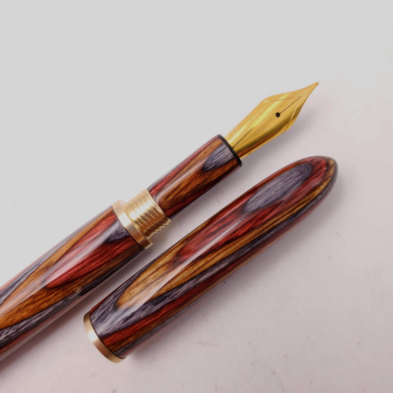

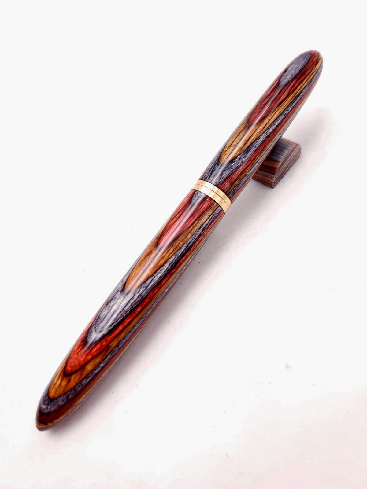

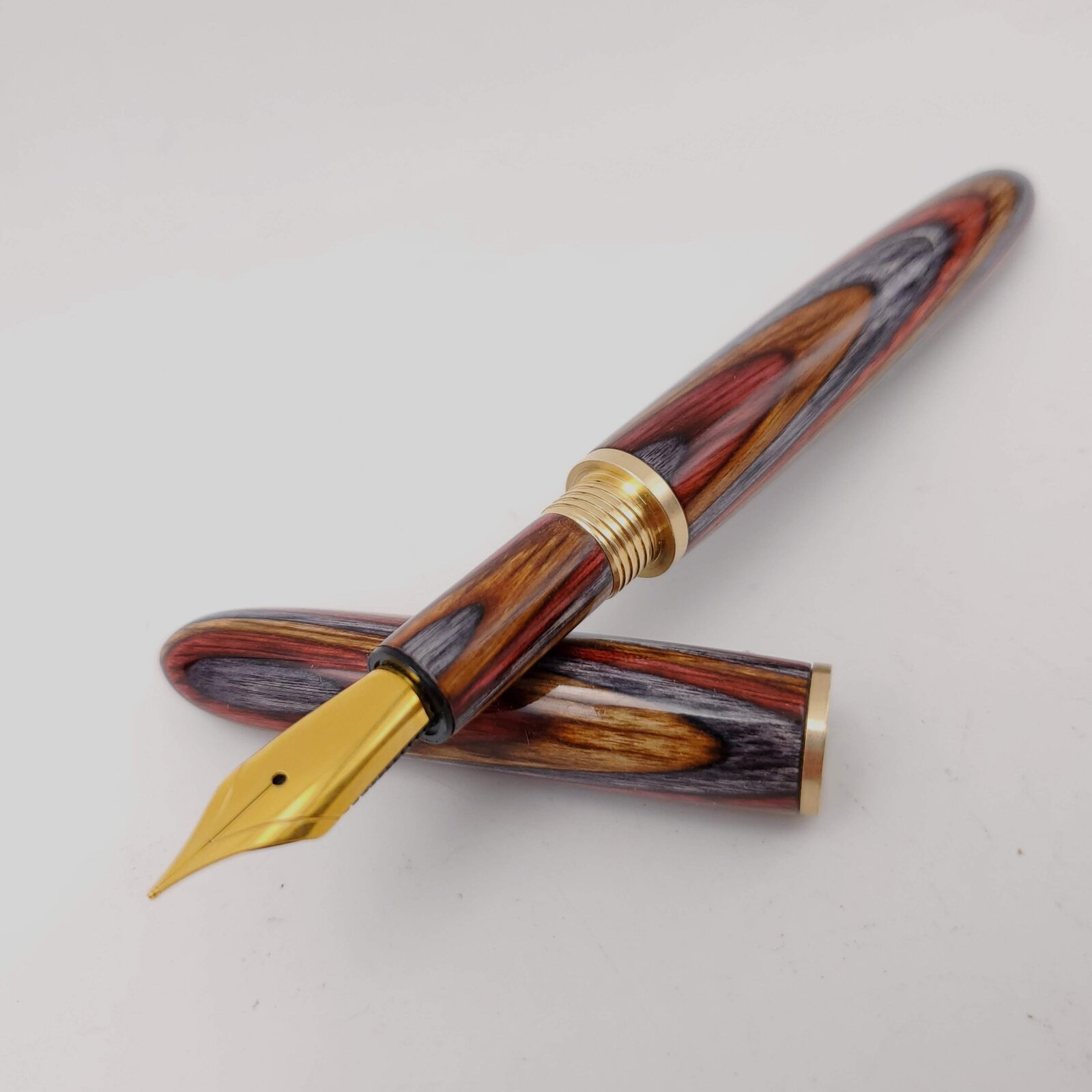

I made a custom fountain pen with some Royal Jacaranda spectraply. I modified some of the parts of the RAW kit for the threads since I haven't gotten into threading yet. Making the section was a challenge and figuring out how to convert it to a #6 nib instead of a #5 nib took some creative drilling techniques, but I'm happy with how it turned out.

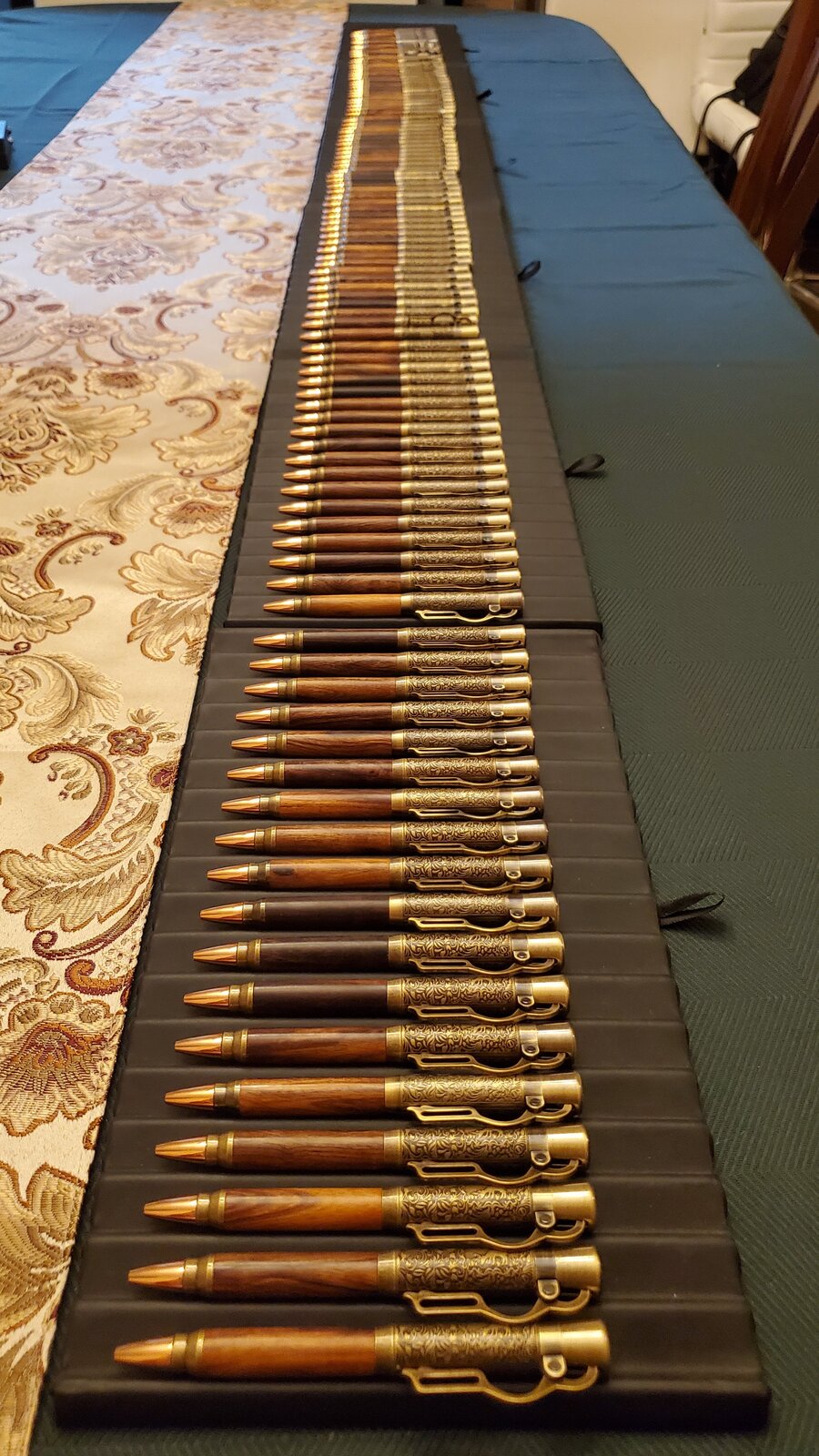

And then there's a bunch of ironwood lever action pens I recently made to fill some orders. I needed 105 for the orders, I started with 108, and ended up with 104 because a few broke along the way. So now I'm one short and have to go make another one 😅. I don't mind doing the "production pens" but the custom pens are definitely more fun to make.

Wow, that's a lot of revolvers!
I really like that fountain pen. Would you mind sharing how you modified/made the section?
Thanks! To be completely honest, I did a lot of little tweaks on the section until it all finally worked together and I'm not sure I can remember everything I did. I wouldn't do it the same way again because of how thin the wood ends up being. It's literally paper thin at the top. But basically, I trimmed down the brass section, cut it in half, and inserted it into the wood section I made. I had to strip the threading off the #6 housing and make it press fit into the brass section. When I thought it was done, the wood section didn't fit into the cap so I had to turn the wood section down even further. Then the cartridge wouldn't insert far enough to secure to the housing so I had to drill the brass a tad wider to make it fit.
I don't know if that helps at all or even makes sense. But it was kind of a nightmare and you could probably figure out a better way. 😆

The seciton on the fountain pen is awesome! But i'm still trying to figure out how you modified the cap to get the threaded portion 🤔
Thanks! I just trimmed down the brass cap to where I could fit it into the hole in the wood and then cut the end off. I left about 1/16" untrimmed on the screw end (this is the exposed trim ring).
