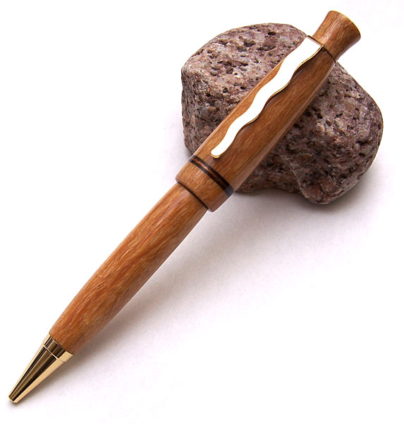

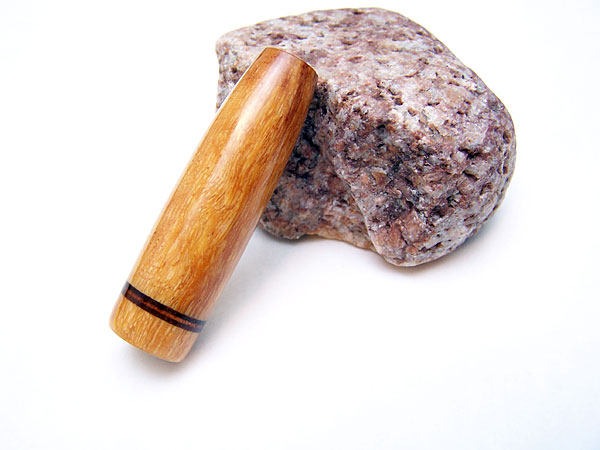

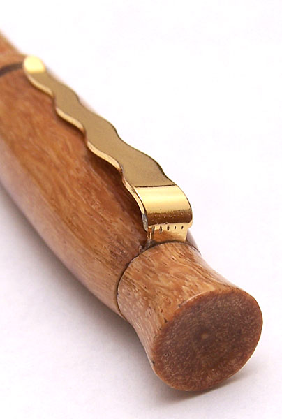

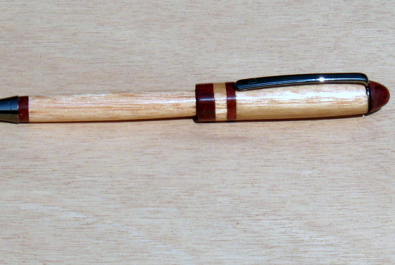

So I took some time while waiting for the finish to dry. My #2 challenge pen.
Again a small piece of white ash that was around a spot where a large branch went through the board. The three pieces for the center band were drilled with a 10mm brad point bit and a tenon turned on the cap to match. Bottom end of the cap is approx. .5 in.. The blue for the center band is a leftover piece of Azurite Gemstone from another pen. Used an old mandrel as a pin chuck to turn the recess in the end of the CB. The center section of the center band is ash as well. I thought about using the gemstone for the finial but decided I liked the looks of the ash better. Built on a chrome streamline kit, the clip sticks out just a bit farther at the top giving a slightly better fit. Glued the piece of ash for the finial to a piece of 3/4" dowel and chucked it in my beall collet chuck for turning and finishing. I did glue it in because it want it to be permanent but it was a tight press fit.
Cut my blanks to rough length with the bandsaw and did my drilling on the drill press. There is just enough play in the tailstock of my drill press to make drilling on it a pain.
Like the first one this will be shipped along with a letter of support to one of our military personnel.

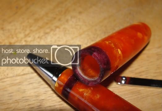

Is this the disaster dept.? :redface: I was going to try to hide the clip on this one but , didn't cut deep enough AND , part of the end of the wood broke off while sanding . I had too much length on my hacksaw blade parting tool and , didn't cut the tenon straight on the finial . So , the finial doesn't set level . Yes , I had to use glue . Had fun anyway ! :smile:

It looks good anyway Chuck .Don't feel bad about the clip I kinda did the same thing . I turned the blank too thin to recess the clip . I could take it apart and cut the top a little bit to where I have enough meat to recess the clip but then my tenon would have to be shortened and wouldn't hold in as well and would have to be glued in place , so it stays as is .

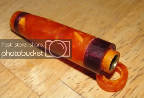

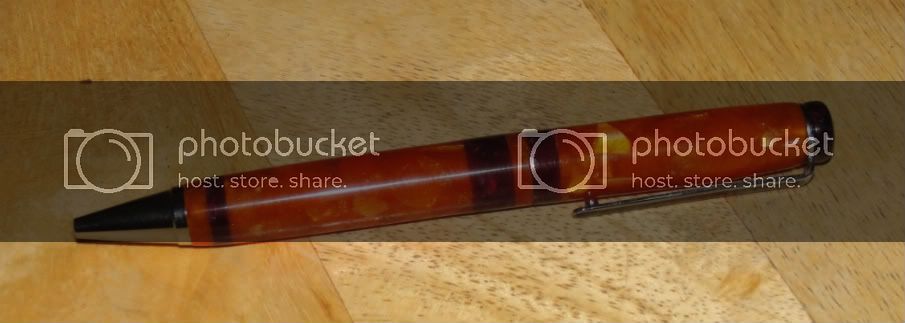

Ok my 1st pen wasn't a slimline , sorry , oops . I was playing for the challenge , that was fun .It was a little slow using a parting tool to do the cutting . So this is a slimline .... sorta ... Didn't want to us a new kit when I have some pens that could be salvaged for this so , you know how hard it is to save the parts from a slimline pro gel click pen..... the need ( nib ) and clip is all that was usable and with a cigar part or three ... i did make tenions one at the tip clip end ( had to cut the threads off the top cigar tube and I drilled it out to 1/4 inch / .250 . made a small tenion so the clip wouldnt move after the top was presses in . I was thinking should have checked but .006 oversize ( .256 ) was a tight press . The upper part dont have a tube all the way ( like a cigar ) so I made a tenion with a purple sleeve that is steeped over the lower part where the trans screw into ( didnt i say it has a parker style refill ).so here is some pictures of my slimline pro / was click pen....
The the pen
dont rake me over the coals it not a true slimline twist ... or the tenions are on both ends of the center wher they connect .....
another fun pen to make

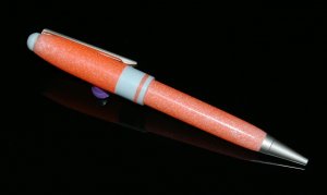

Butch; Can't thanks you enough for your challenge, really appreciate your time. I didn't make the first challenge, 4 children!! Anyway I did make the second challenge. I had some alumilite that was absolute junk, but this is not a looks thing for me, just a learning experience. two pics, one of the parts, the second is the pen. This took some thinking and am still debating some of the things I did and how I could improve on the techniques.
I actually like it Randy . That blank has a cool look to it , like a candy orange flake . I'm not sure if you used white tubes or painted the tubes or blank white but it seems to be showing white under the orange . With a blank like that you should have painted the tubes/blank with an orange or yellow paint , it would have given it a deeper look . You can sometimes get a really wild look by accenting the colors .
Your workmanship on the pen looks great , and the satin kit fits it perfectly . Overall , good job !!!
I used white tubes, but like the idea of orange paint better, more depth I am sure. Alot of nice pens have been "crafted". Great job to all and the experience will be used in the future.

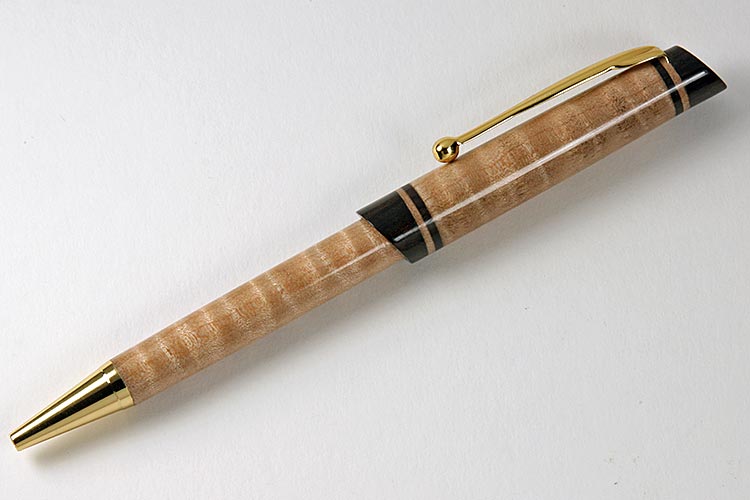

Here's my version of the Stage 2 pen. The centerband segments are on a tenon and the finial is press-fit. No saws were used to cut the pen parts.
I stuck to maple and blackwood, but made the slices a little thinner and angled the ends. I also did a recessed clip.
I hope you like it - it was instructive to make.

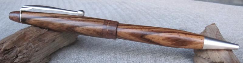

Here it is - my second entry, which I like much better. And I think its sold!! my first sale! I just need to figure out a price.
The blank came as part of an unlabeled assertment - I think its Zebrawood - someone please tell be otherwize if this isnt so. The accent wood is walnut. I was expecting a bit more contrast between the woods - oh well, the buyer likes it.
I REALLY need to know what a pen like this should sell for. Would some of you more experienced people please PM me with what you think is fair for this level of work? Thanks

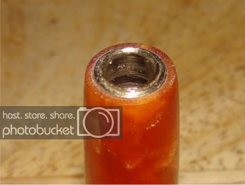

On to the trials and learning. First in the "Accidental Learning" department. I targeted the finial diameter to be the same as the end of the barrel, but I hosed the finial's finish and had to sand it all off and re-finish, which made the finial too small by about .01 inches. I pressed it in anyway without glue just to see, and discovered it looked just right! In hind sight, since the pen tapers, and the clip band is in between the upper barrel and the finial, it makes sense it needs to be a tad smaller - happy accident!!
The trial was the lower blank blew up on me using the crappy 2 blade carbide barrel trimmer. A huge chunk broke out all the way down to the tube. I was going to toss this pen and start over, but I already had all the hard part done on the upper barrel. So with little to loose, I massaged the chunk back to shape and CAed it back together. I told some people at work there was an issue with the pen, and no-one could find it until I showed them the seam lines. Amazing how well it turned out. One of the cracks is inb the photo. Good luck finding it!
Oh Yea - CB on tennon - no saws - all parts on lathe.
One thing I noticed as well is the CD glue lines seem a hair more noticable than prior efforts. I used epoxy on the CB instead of CA becasue I wanted more open time to get things on right and the grain aligned. Is Epoxy know to have slightly more noticable glue lines? I kinda like them there (for this pen) as it adds a bit of definition.
Hardware is satin pearl. Finish is CA/BLO left at it's natural soft gloss.
