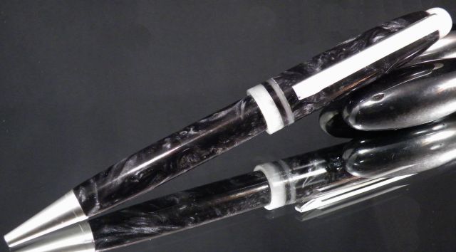

This is Stage 2 of the Penmakers Challenge . On the surface not much has changed from stage 1 but there are a few differences . In this one I have added a new finial which is pressed into the upper tube . A tenon was needed and it had to be sized accurately to be press fit , not glued into the tube and hold the clip tight . You can glue it in place but try to make a press fit first , it's good practice for making tenons .
The other difference is that the centerband is now fitted to a tenon on the upper barrel . This is also optional but advised , the next stage will require a tenon here for strength . There won't be a tube to support the glue joints so the tenon will act as support .
I made this pen from PR but you can use wood or whatever you would like . Again no saws were used to make this pen and this time I MEAN no saws were used ... unless they use a saw to make the liquid resin :biggrin: All cuts were made by using a parting tool on the lathe .
Sorry for getting this one started so late but the kids used up all the batteries so I had to wait until the rechargeable were charged for my camera .
Ok , let's see some pens (done by the rules , I hope)

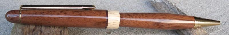

No optional stuff
I already had this pen in the works, so it has none of the "Optional" features. By that I mean the CB is not on a tenon.
The finial is a press fit, with epoxy for peace of mind. It is a good enough press fit that I didn't need to leave it clamped.
To get the finial fit, I left it a bit big final sized it with sandpaper by hand. i'm glad I did becasue my drill chuck messed it up. No real option there - I think I dont really have the proper gear to do it right.
The wood is walnut and hickory, and a mystery dark wood slice (cocobolo maybe). There is aluminium foil in each glue joint. You can see it between the dark woods, but I it is not visible against the hickory (even in person).
IMO the CB area is a bit too fat, and the finial is a bit off (perhaps due to the hand fitting. But, its the best finish (CA, no BLO) I've done to date.
I intend to do a second pen with the CB tenon and submit it too, but I had this one started and really wanted to give the finial a go today.

It looks good to me . I think the finial makes the pen , it gives it a finished look . If Waterman or MB were to make a wood ballpoint it would look like that . Great job .

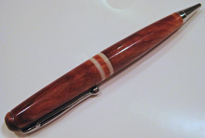

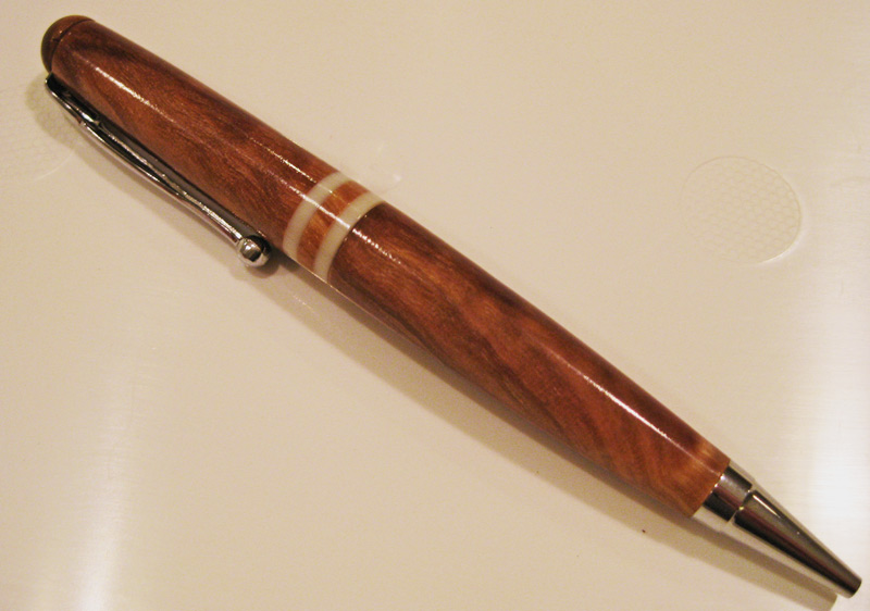

Here's my second round attempt. This is stabilized Lombardi poplar from AS with alternative ivory bands from EB. The clip finial is actually russian olive because I destroyed the piece of poplar that I had left. I'm anxious to see how others make their finials because it was easily the hardest part for me. I did manage a good fit, but added a touch of thick CA to the tube for longevity.
I want to say I greatly appreciate this exercise. I've never done kit modifications until now. I'm not sure I like the two pens I've created thus far, but the techniques I'm learning will help me in the future.

I see nothing wrong with it David . As a matter of fact I think it looks great . the only thing I might have done differently would have been to recess the clip since your stock is larger then the clip ring . To recess the clip you would have to drill a slight counter bore the size of your clip ring in the upper blank and using an xacto knife cut a notch in the edge of the blank for the clip to stick out through . Then when you press your finial on there is no gap at the clip .

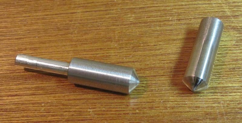

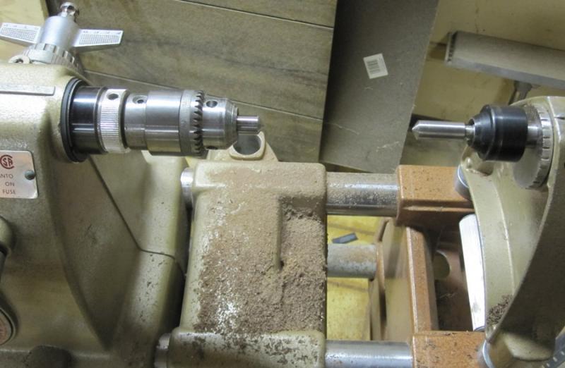

I'm working on rev 2 of my process for finial turning, and had to make some things to turn between centers more effectively.
I made my own pen turning points for the shopsmith. The only live center I own is the Manrel Saver. I made points for both my chuck, and the mandrel saver. The angles arn't precise. I just eye-balled it.
This works OK, but I see a real 60 degree live center in my future. The mandrel saver does not have very good lateral support in this configuration, so a light touch is needed on the tail end.
These are made from a 1/2 inch rod I had in my shop for years - bought for a project I never did. It had a threaded hole in one end for a 1/4 inch bolt (the rod was actually a spare part for an accessory I dont even own)
I epoxied a 1/4 inch bolt in the the rod and cut off the head - instant shaft for the manrel saver. The drive side was easier as it is a 1/2 inch chuck. Cut a 2.5 to 3 inch length of rod to make these.
To cut the point, I chucked up each one and used my hack saw (one of those little ones) held at my eye-balled 60 degree angle about one inch from the end of the rod. Stopping occasionally to let everthing cool. Took a bit becasue the the blade had to remove all the metal from the face of the waste part of the rod.
Turned out nice. Just wish the manrel saver was more stable.
Pics of the parts, and mounted on my shopsmith.

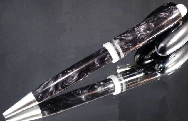

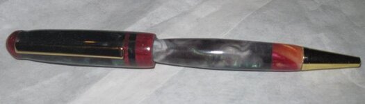

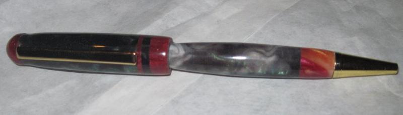

well here is my round 2 contribution. Black and Interfine green PR with reddish orange PR CB, Finial, and accent.
I am not very happy with how it came out. the bottom barrel is too small, so the white paint shows through alot mroe making it appear a different color alltogether. The trim piece by the nib was dark on the outside, but light on the inside, so it doesnt really fit in. The finial is a bit too wide, it is not a press fit. The bottom barrel is too small at the CB transition, so it looks funny. The segs are not 100% square. I dont think you can notice with the human eye, but i sure noticed when it was spinning at 3000 R's.
On the plus side, All the steps were done on the lathe, no saws or other power tools. I did tenon the CB... All three parts of it... I also recessed my first clip! What an easy mod to do for a major impact on appearance! The slot is a little bit too wide, but for a first try, I was pretty happy with it.
Overall, It was a fun build, and i learned a TON, but this particular finished product does not excite me at all.

Ron I think it looks ok , warts and all . I wasn't happy with mine either , the white/silver CB bands lost too much color even with painting and I was going to recess the clip but I forgot when I was turning the barrel so I didn't have enough meat in the body to do it .
