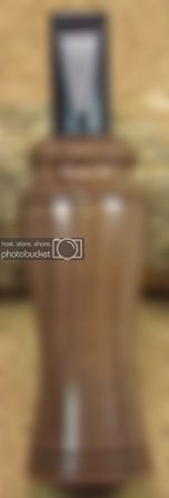

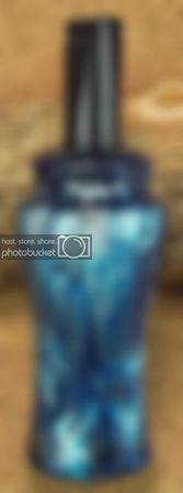

Here is a pair of crow calls that I recently finished for a couple of guys over on a hunting forum. First is alumilite, second is walnut.

The Blue one is incredible, the depth of the colors is very cool. The Walnut is fantastic (I have a slight disposition to interesting wood and what all the great turners on this site do with it.) That Blue knocks me out. Way good job.
