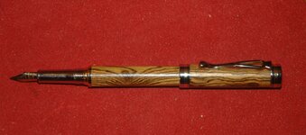

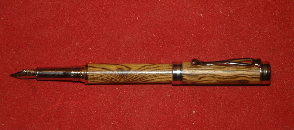

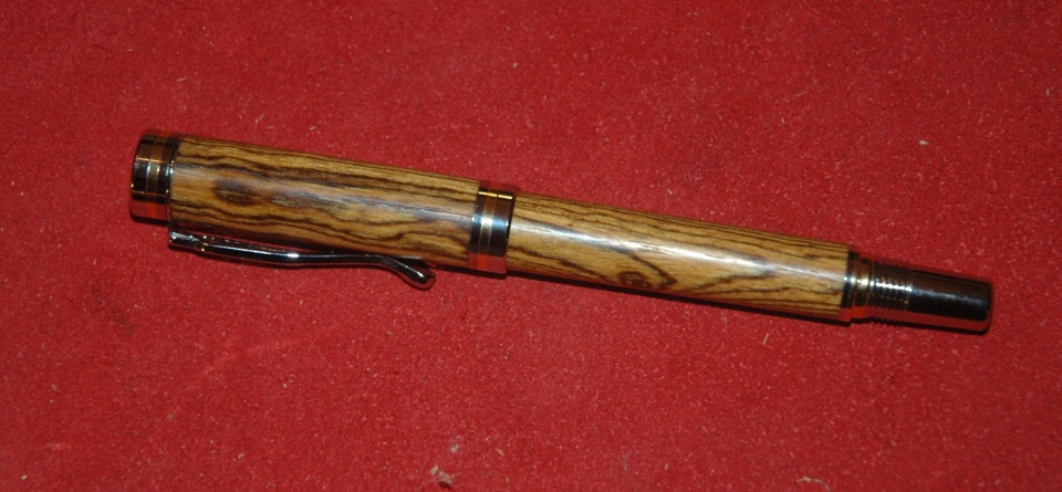

I made this for a neighbor.
The wood and kit go really well together.
I bought a Kojent a couple of months ago but haven't used it yet.
Yours is an inspiration.
Thanks for showing.
