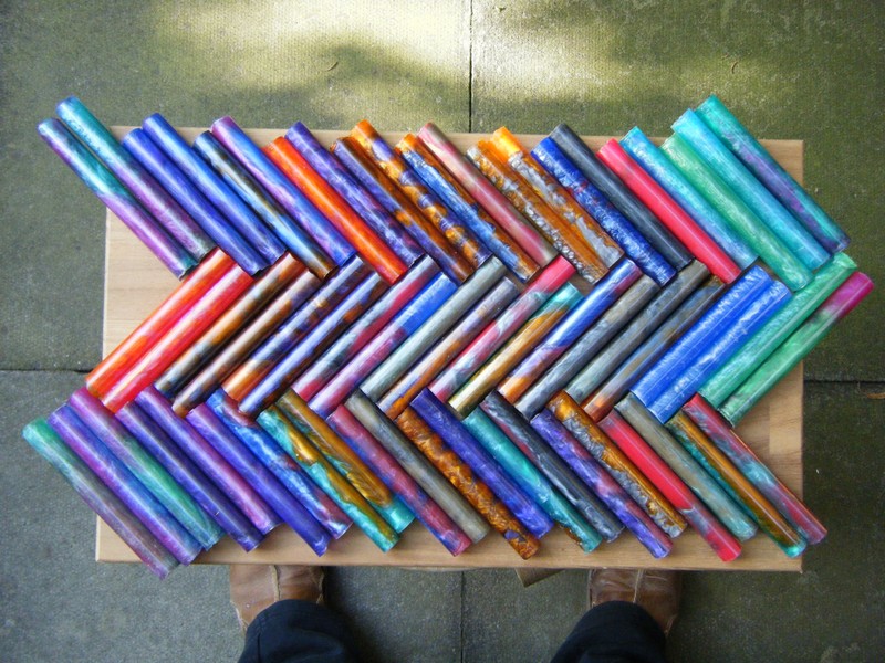

We had a great day of sunshine here in the UK yesterday so I thought I would get busy with some casting. I made 64 3/4" x 6". Hope you like the results.

I already sell them 3Peake, the members at my local woodturning club buy them. We are having an all day demo this coming Saturday 15th with Simon Whitehead doing the turning. You are more than welcome to come along if you are not too far away. Have a look at www.westpenninewoodturning.co.uk for further details.

Wiset1, I am casting between 12 and 16 at a time so it's not too hard to get a few done in the day. I'm just trying to beat the weather over here as I have no easy way of heating my workspace and SWMBO won't let me cast in the house for some reason!!

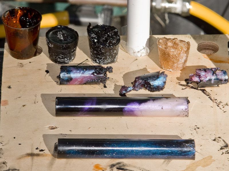

Here is a photo showing the resin which gelled far to quickly and also the two blanks I managed to pour. Not up to your standards, Eric, but I will get there.
The tubes I tried to get some of the gelled up resin into have still got remnants of the resin inside, it wouldn't come out cleanly, the two complete blanks came out easily and cleanly. Do you think I should throw away the tubes with remnants in?

Hi Peter, I don't know how much MEKP you used but it looks like far too much. I like the bottom blank, the blue colour looks really good. Try and clean the tubes out once the resin has cured properly but bin them if it's too much of a pain. Keep at it Peter, the rewards are worth it.
